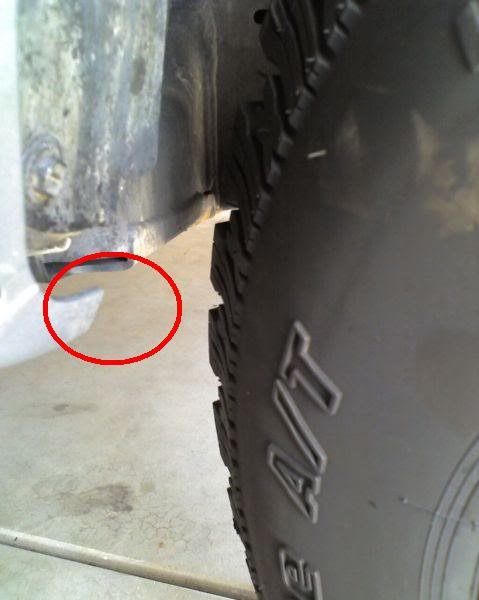

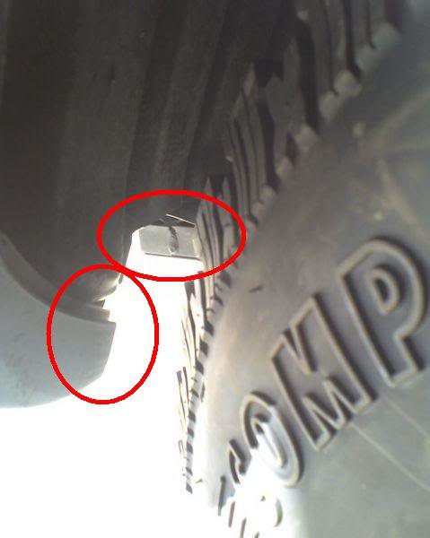

    Just use a heat gun and a new razorblade. Trim very slowly and only what is needed for the tires to not rub. I had a buddy in the truck turning the steering wheel as I cut what is needed. You also have to take in effect when the tires are articulating up and down and cut enough so they have to room to do so.
    I recently upsized from 265/75-16 (32"x10.50") to 285/75-16 (33"x11.50") and had to cut more of the front flare and a small portion of the rear flare.
    Front Flare
    Rear Flare
