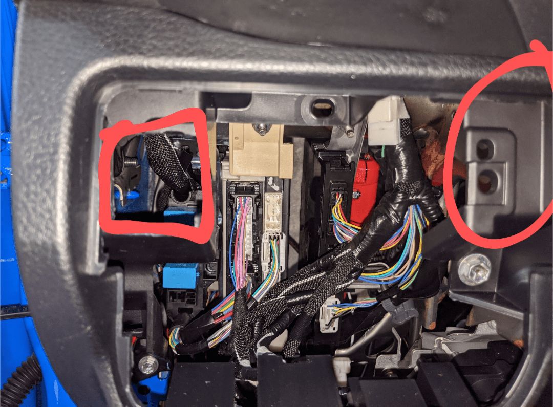

    The areas that are trimmed are the mounts for the cubby. The mount locations are still present, though not needed, even for model years that didn't have a cubby. To fit anything more than 3 switches wide across the top you have to cut those mounts out.

    Thank you very much for these replies. Helpful to know it’s a vestige of the phased out cubby and can be eliminated without issue.
