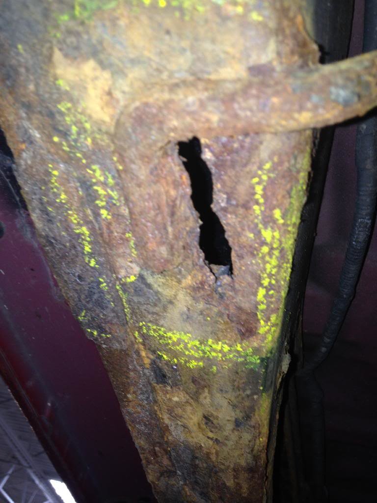

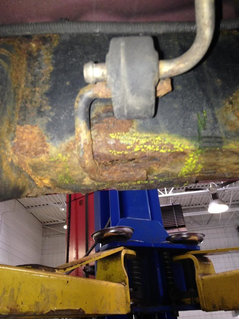

    Mine will not pass PA inspection due to a hole in the frame. 2005 with 117k miles. They are looking into replacing it, but in the meantime I need to find someone who will weld in a new piece so it will pass inspection.....
    A7C064F1-7C23-446C-8A81-6242DA65EE3A_zps_5d5a72bcdadb9c2984a495bb547a0ea7b20f7241.jpg
    8EAD1166-C587-424B-89AA-11676CFABD04_zps_06924a14cfb00240b811a389374d58f6bd4c5fab.jpg

    Frame in transit!
    Ive needed my truck like 30 times in the past 3 weeks...
