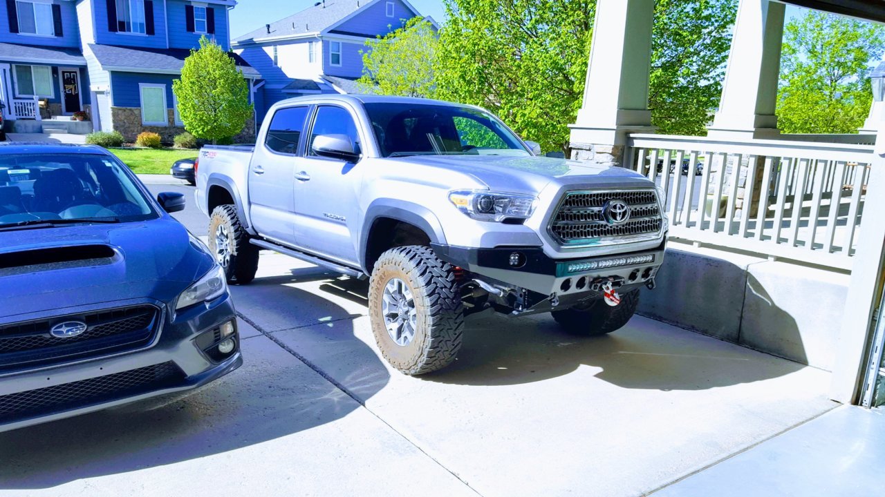

    Current state pics:
    Current state:
    • ToyTec Boss Performance lift (2.5 coilovers, SPC UCAs, diff drop kit, 2.0 remote rears & Toytec progressive AAL). Removed. For sale
    • Toytec Boss 2.5 Front Aluma Series Remote Reservoir Coilovers
    • Toytec 2.0 Aluma Series IFP Rear Shocks & OME Leaf Packs
    • Timbren Active Off Road Bump Stops & U-Bolt Flip Kit
    • Toyo Open Country MT 2285/75 R16
    • InSain Fabrication Front Bumper (aluminum)
    • RCI Rear Bumper (Steel) with aux lights & hidden hitch
    • Warn VR10 Winch
    • Spidertrax 1.25" hub-centric wheel spacers
    • Full Skids (RCI)
    • RCI Sliders (powdercoat)
    • RCI Custom Bed Rack
    • Tepui Autana XL Siberian Camo
    • Baja Designs 30" Light Bar in Front Bumper
    • Baja Designs Squadron Sport Combo Fog Replacement Lights
    • K&N CAI
    • MBRP 3" Cat Back Exhaust
    • Extang Solid Fold 2.0
    • Factory bed mat
    Future state adds:
    • 5.29's
    • Optima Yellow Top
    • ARB Linx or SPOD

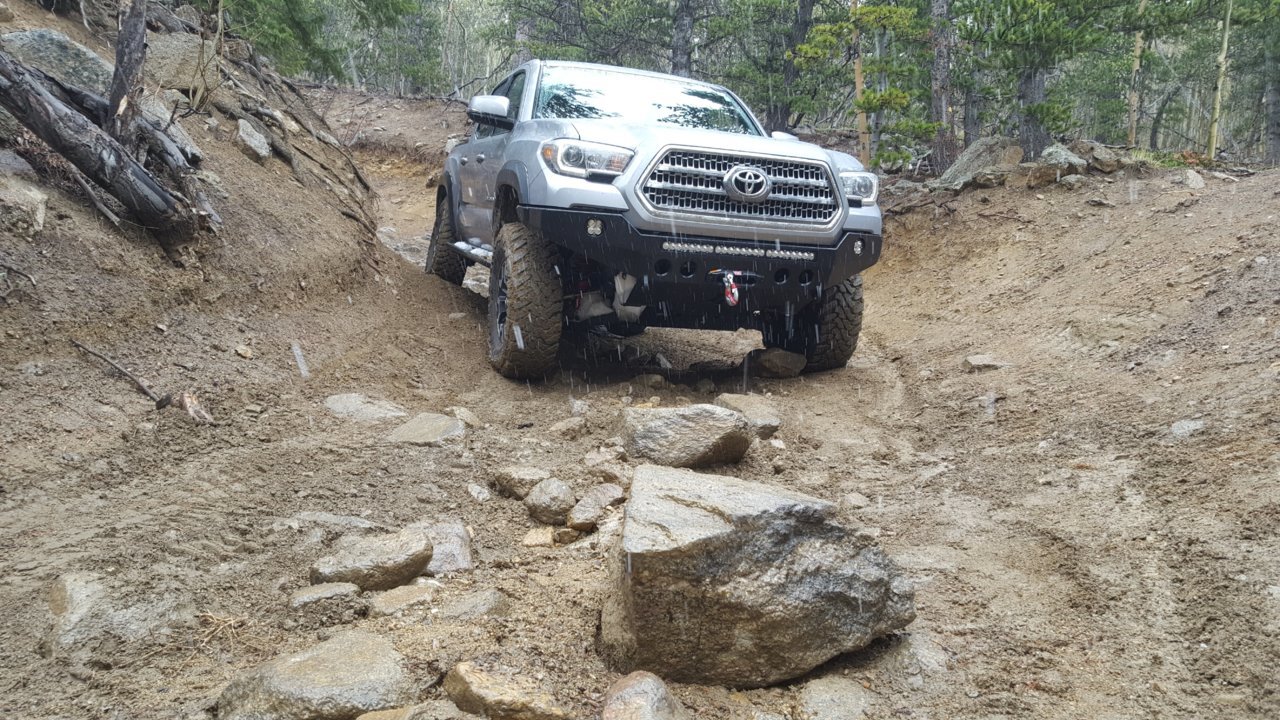

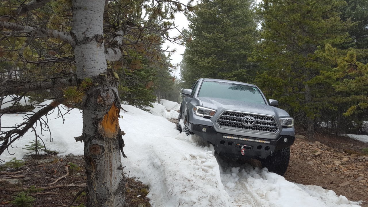

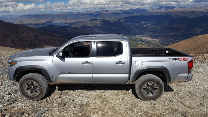

    Fall '16 trips while stock: webster pass, peak 10/breck, lead king basin:

    I signed up for an all pro group buy, not yet realizing that RCI is in my backyard. Canceled the all pro and went with RCI. I picked up locally, saved on shipping, and really like their work. Quick Tip: Double check that you have all needed hardware before beginning your install!!! Quick Tip: Its worth getting an exhaust re-route from a muffler shop and gaining the extra ground clearance. As you'll see in my pics, I did NOT re-route the exhaust, so the mid skid has a 1 inch bracket that lowers it to accommodate the stock exhaust-- looks terrible! I'll be switching this out as soon as I can re-route the exhaust.

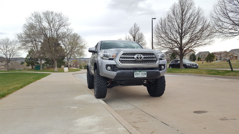

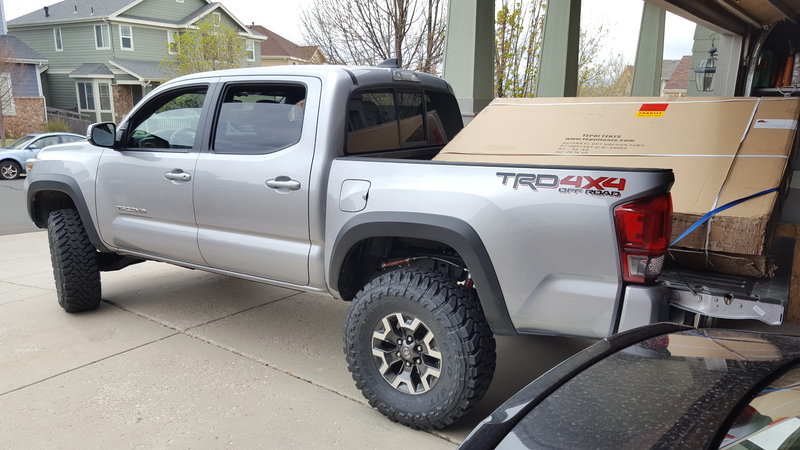

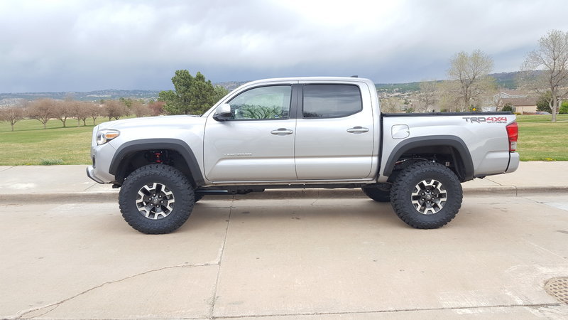

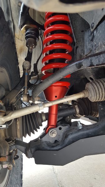

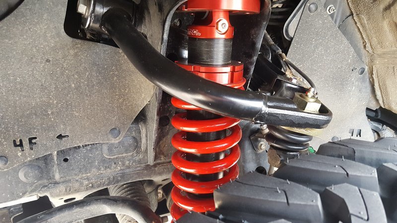

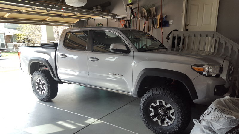

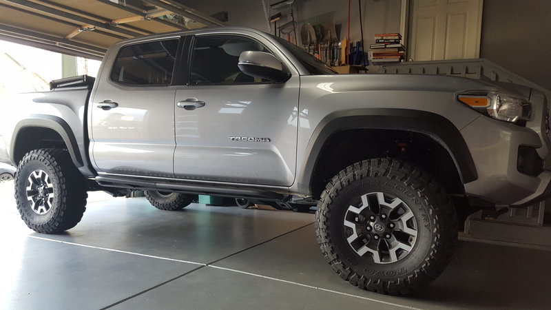

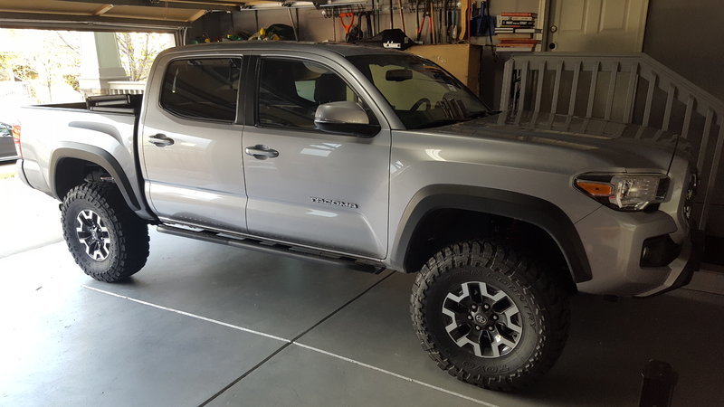

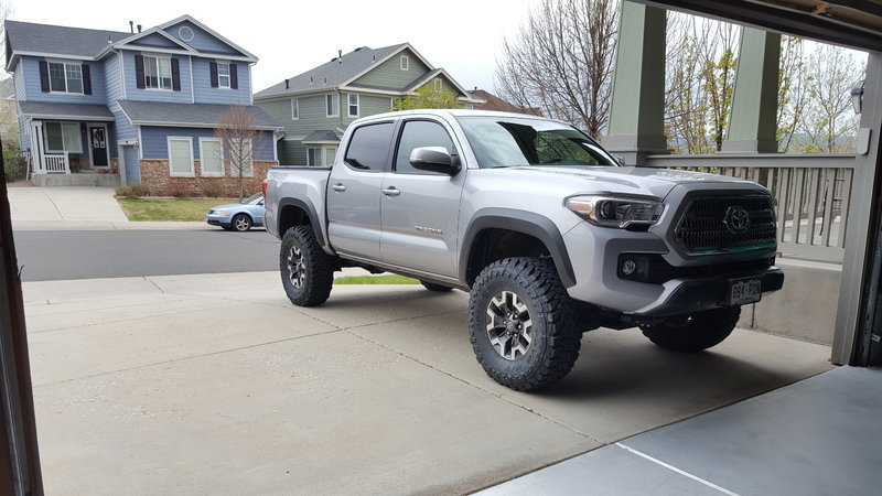

    Next were lift and tires:
    20170420_095549.jpg 20170420_152606.jpg 20170420_152455.jpg 20170420_100220.jpg 20170420_132739.jpg 20170420_152440.jpg 20170420_175151.jpg 20170420_152635.jpg 20170420_152620.jpg
    Really wanted the OME BP-51's, but with another local vendor in ToyTec, a solid product, good reviews and a lower price point, ToyTec was the choice. If I had chosen to install the lift myself, I might've spent the difference on the BP-51's, but I honestly was too intimidated to install my own lift. I have (or had access to) most required tools, but just not the patience. Story of my life. I absolutely love the ride the toytec lift provides!
    I've had BFG AT KO's on my last two trucks going back years. I loved them, but we wanted something more aggressive this time. We chose the Toyo open country MT's. They are surprisingly quiet on the road, and I've read (mostly) about pretty good tread life. Haven't gotten them in the dirt yet, because…. RUBBING. Hate.
    RSG here in Denver installed the lift and tires…. And the spidertrax 1.25" spacers. The spacers helped clear the new SPC UCA's but the treads on these Toyo's are pretty tall…I've got a body mount chop scheduled for next week, but I'm actually thinking (from what I can see), it's more about the plastic fender rubbing than the cab mount. We'll see… A little unhappy about having to cut. Quick tip: Make sure you can fit your new 33" spare under the truck still! Mine is so close to the frame rails and the exhaust, I ended up wrapping the exhaust right there with motorcycle exhaust tape to keep it from melting the tire.

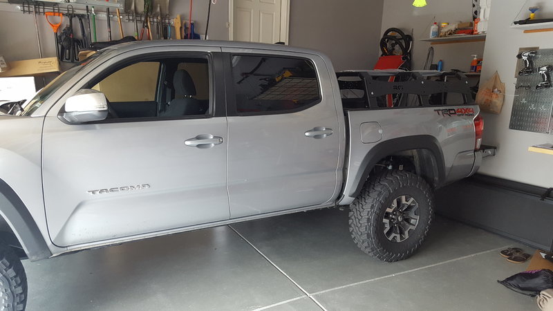

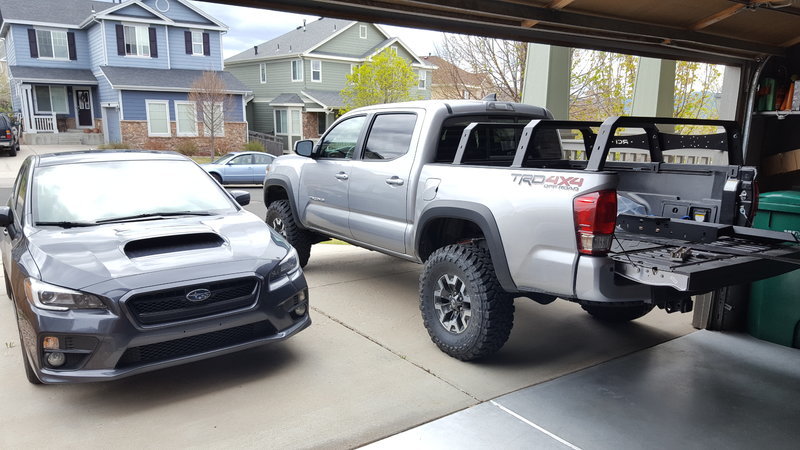

    Bed Rack:
    Went ahead and got the bed rack from RCI as well-- I think it's the best looking one I've seen. In a stroke of luck, I managed to secure RCI's first aluminum bed rack. Super light! I love my tonneau, and the bed rack and RTT will only be mounted to the truck 5 or 6 weeks per year. Quick tip: If you're mounting your bed rack and RTT permanently, I think a full cage type bed rack, which attaches to the floor of the truck bed is wiser…. I have seen the walls of the truck bed damaged by a nice looking rack carrying too much weight for too long…

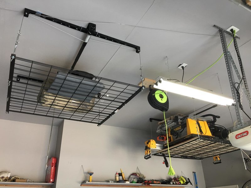

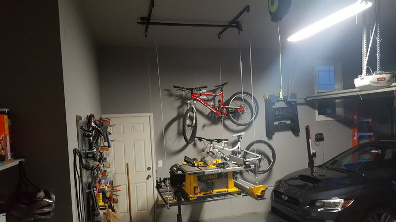

    I'm waiting for a new lift in the garage similar to this one,
    and then the RTT goes on the bed rack:

    Nothing off road yet, because my 285 toyo MTs are rubbing pretty good at flex/full lock. That is being remedied today (literally). I'll be on the dirt tomorrow or this weekend no doubt.
    Stiffer on road. Little to no nose dive and body roll, which I love. I've hit a few bumps pretty hard and it seems like it'll eat bumps pretty well... I'll provide better insight once I get it off road.
    As for lift choices, one big reason I chose toytec, is that they're local. Nothing like driving to see a vendor if I ever have issues (i don't expect to have any issues). Same reason I chose RCI sliders/skids/bedrack.
    I think that the OME BP-51 was my ultimate choice, but would have been 1300 more and I had other plans for that $$. I think OME has a longer history and probably spends much more on R&D than toytec. and their technology may indeed be better. But this is my wife's daily driver, which means it sits in the garage, makes grocery runs, and then goes overlanding 5 weeks per year. BP-51's just seemed overkill.

    Thanks! It's performed so well so far. Toytes boss 2.5 performance here. No bushing needed as you speak of. And no vibrations, thankfully! Keeping it from rubbing was difficult. I trimmed a little fender and had the body mount chop done as well.

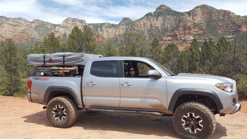

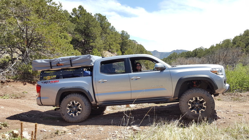

    lift, skids, sliders, bed rack, tent, etc.
    After a full week in flagstaff and Sedona for the overland expo, we were able to test out everything. The toytec lift is awesome-- eats up the bumps, feels firm on the road, and plenty of flex. The bed rack, skids, sliders, and the rooftop tent all work perfectly. My wife loves how comfy and warm we stayed in the tepui autana XL.

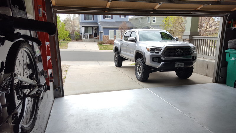

    added 2nd lift in the garage to hold the bed rack/rooftop tent (whanginf from bottom and camping gear on top. Still contemplating how I'll anchor the bedrack/RTT to the bottom of the lift... ideas?? IMG954300.jpg
