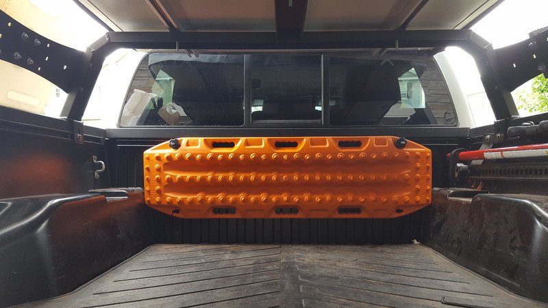

    Maxtrax mounted. I always thought I would mount the maxtrax to the bed rack, but they don't fit easily (um, at all, without drilling more holes) on my RCI bed rack. I kind of like how I've set up my bed rack now anyway (axe, shovel, extinguisher on pass side, rotopax on driver side), so the recovery gear will stay in the truck. This will make day trips safer; when I don't have the bed rack/RTT mounted I'll still have recovery gear mounted in the bed (high lift, max trax) or under seats (straps, tire kit).
    I used:
    (2) 3/8 hex bolts
    (2) bed rail track mounting plates from my RCI bed rack (unused because my last cross member actually mounts to the bed, not the rail-- see above).
    (2) threaded plastic nobs that are a little easier to remove quickly.
    (1) Lockless monster cable. This is how I lock down everything in my bed when the bed rack & tent are on (all other times the Extang solid fold 2.0 is covering the bed).
