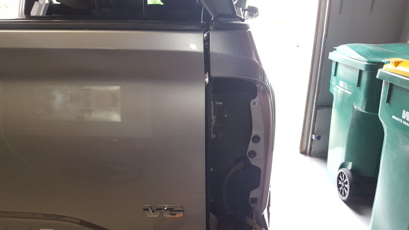

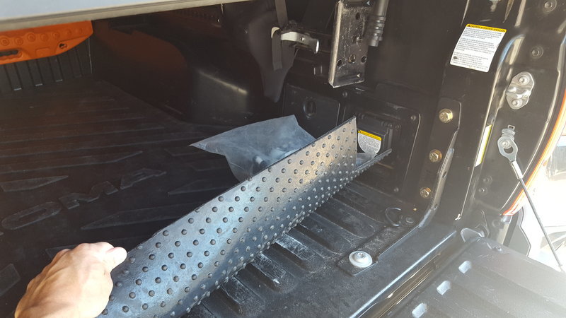

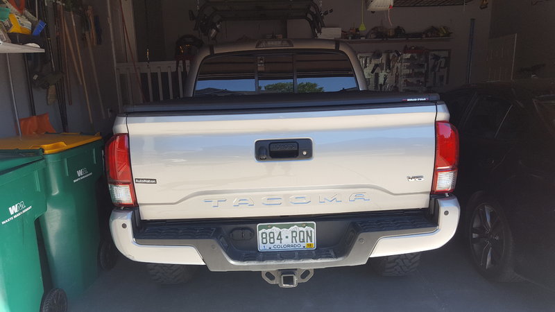

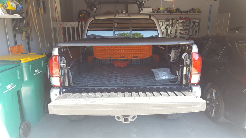

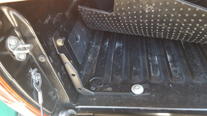

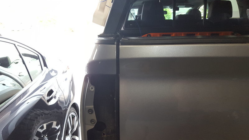

    Rago Fabrication bed channel stiffeners installed. I went with these because they seemed very stout, but not as tall as the Total Chaos offering. The ones from total chaos would have interfered with my extended/custom RCI bed rack (see above truck bed pics). Immediately after putting these stiffeners on, the bed rails trued back to 90 degrees. NO gap now. Looks perfect. Highly recommend.
    Gap before:
    Gap after:
    Truck Bed View:

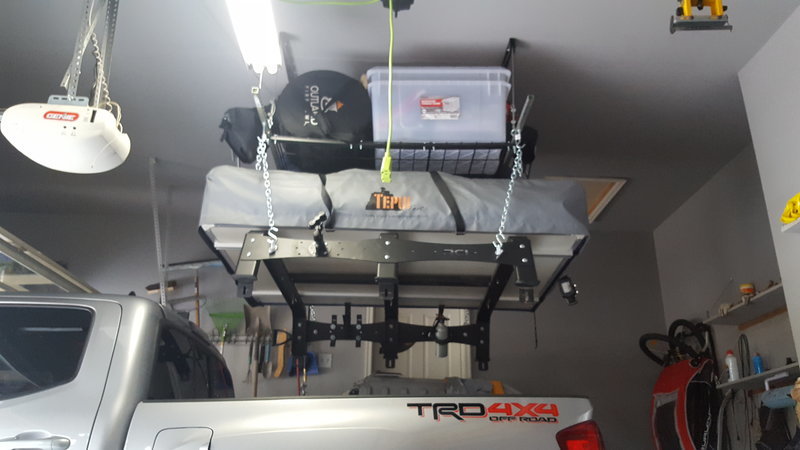

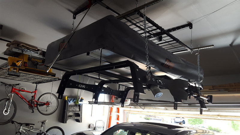

    Bed Rack/RTT Garage Lift Completed & Installed!!

    Do you have a write up on this and a parts list? I plan on doing the same thing later down the road. Looks great!!!

    Question about the RCI bedrack as I am still trying to figure this out. The bedrack you have is basically 6' version because of the length of the side panels and the only difference you made was only ordering one top brace instead of two?
    And you just grinded the bed down to make a 3rd crossmember bracket fit flush?
    Thanks

    basically, yes. i also went with aluminum everything except the side panels. saving the weight was best for me; the RTT?rack are only on a few 5 weeks per year. sorry for the delay!

    nope. just some washers!

    sorry i dont. i'll try to get around to it ar some point. happy to answer any questions.
