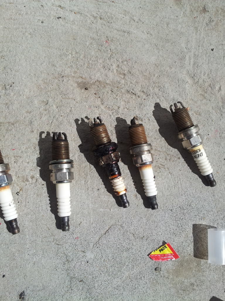

    Truck had the P0301 code forever now, adopted the neglected truck from the wife. Was told the code started after a bad PCV valve was found.
    Changed the plugs and all wires with OEM parts and correctly gapped all plugs to FSM requirements. Took it for a drive, took about a mile for the CEL to come on. Was not flashing from the way home to the parts house. New code is P0300, random misfire.
    I don't remember if I read right but can the o2's cause this? Most of the solutions I have found have been air leaks in the intake, EGR, and PCV. Has anyone had experience chasing this and fixing it?
    Just for some Shits and giggles here's the old plugs... Neglected haha

    since you replaced the plugs wires, that would indicate an ignition coil. 301 = cyl#1, 302 = cyl#2, 303 = cyl#3, etc..... The 300 code is a general misfire.

    Was there oil in one of the plug holes? It looks like there was. That'll cause the coil to short out and throw a CEL. You have to change the gasket on the plug tube. It comes as part of the valve cover gasket kit.
    If you run it like that for too long it'll eventually kill the coil and you'll have to replace it to get the CEL to go away.

    Yes it was in #4, thanks for that!
    I liberated it from the wife so I have no idea how long it's been like that. She's had it since 07 and unfortunately it wasn't cared for that well.

    Seafood won't but seafoam will. But I would be willing to bet that coil is toast and that's what's causing your bad idle.

    Goodness... that middle plug looks like it was used as a rectal thermometer.

    Hahahaha, if I didn't see where they came out from I would have been a little iffy with it :screwy:
