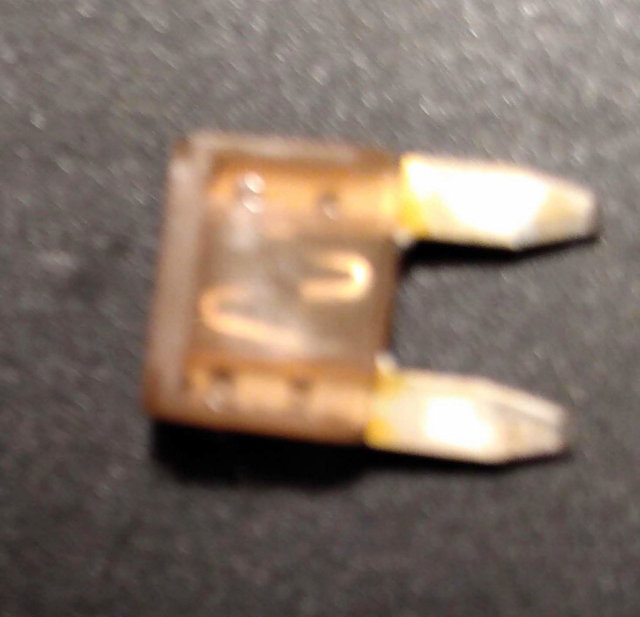

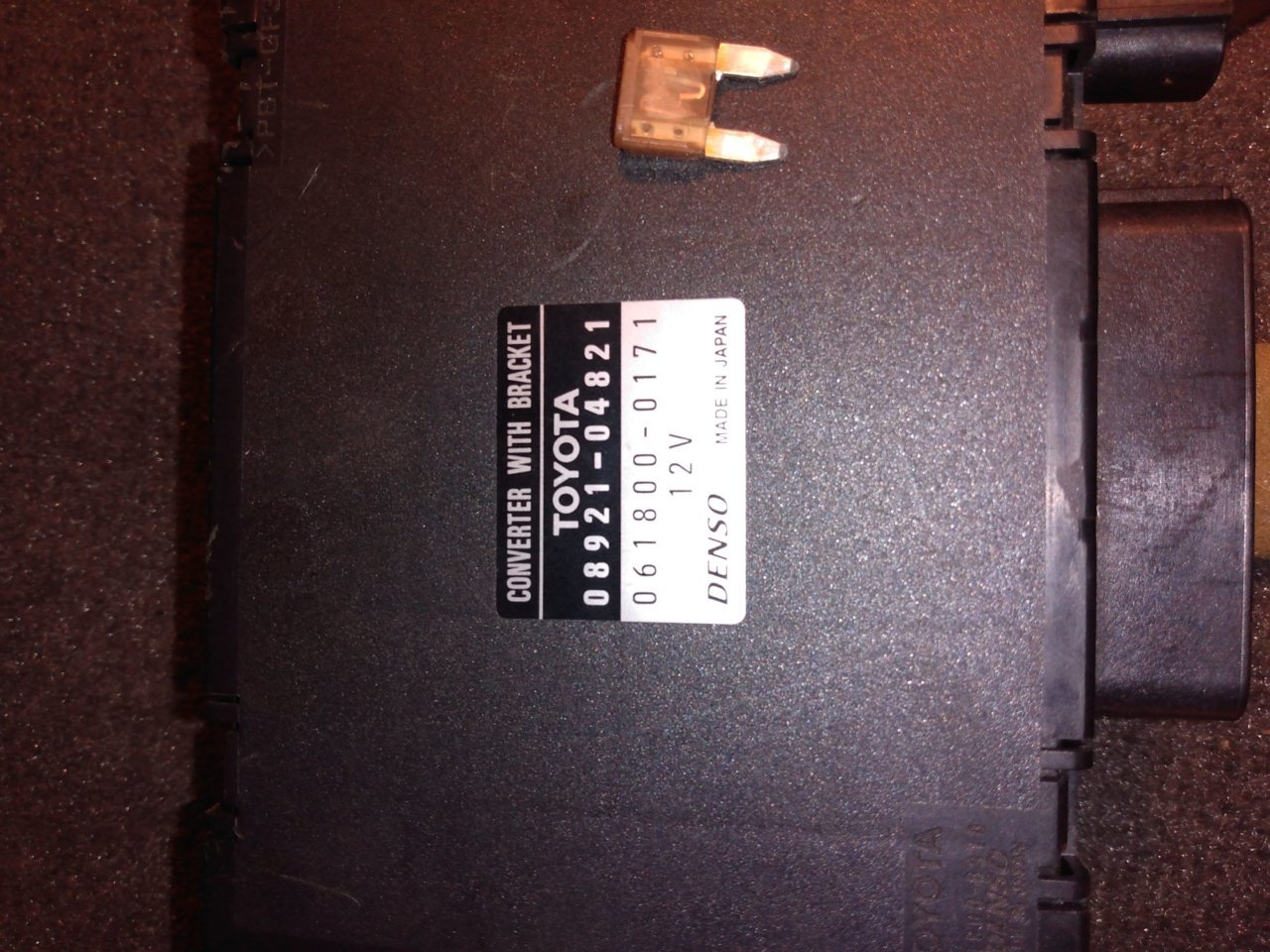

    So I investigated the trailer wiring connector. I used a multimeter and couldn't detect any current. I went behind the driver's seat and looked at the wiring for the trailer.
    There was a black box the large wiring connector plugged into and four separate 5 amp fuses labeled: left turn, right turn, park, reverse...something like that. One of the fuses was burnt out.
    I didn't test the box.
    I then used the multimeter to check this connector for power to the trailer wiring.IMG_20200428_125805276_HDR.jpg
    It had power to a couple spots, and "blinking" power to two spots (I had the caution lights blinking and lights turned on). This makes me think that the power to the trailer wiring harness is good. I don't have any 5 amp fuses on hand so I'll grab some of those.
    The real discouraging part is that with the wiring completely unplugged I reset the codes. Started and put the truck in each gear. Shut it off and on the 2nd start as soon as I put it in gear the code p0705 came on. This makes me think that the problem with the trailer wiring harness can't be the cause.

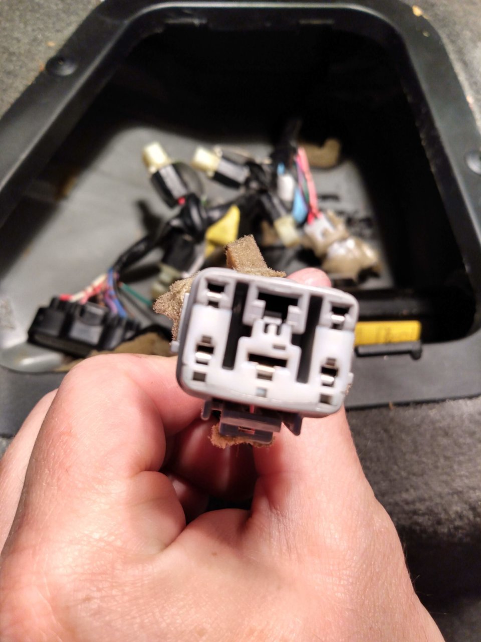

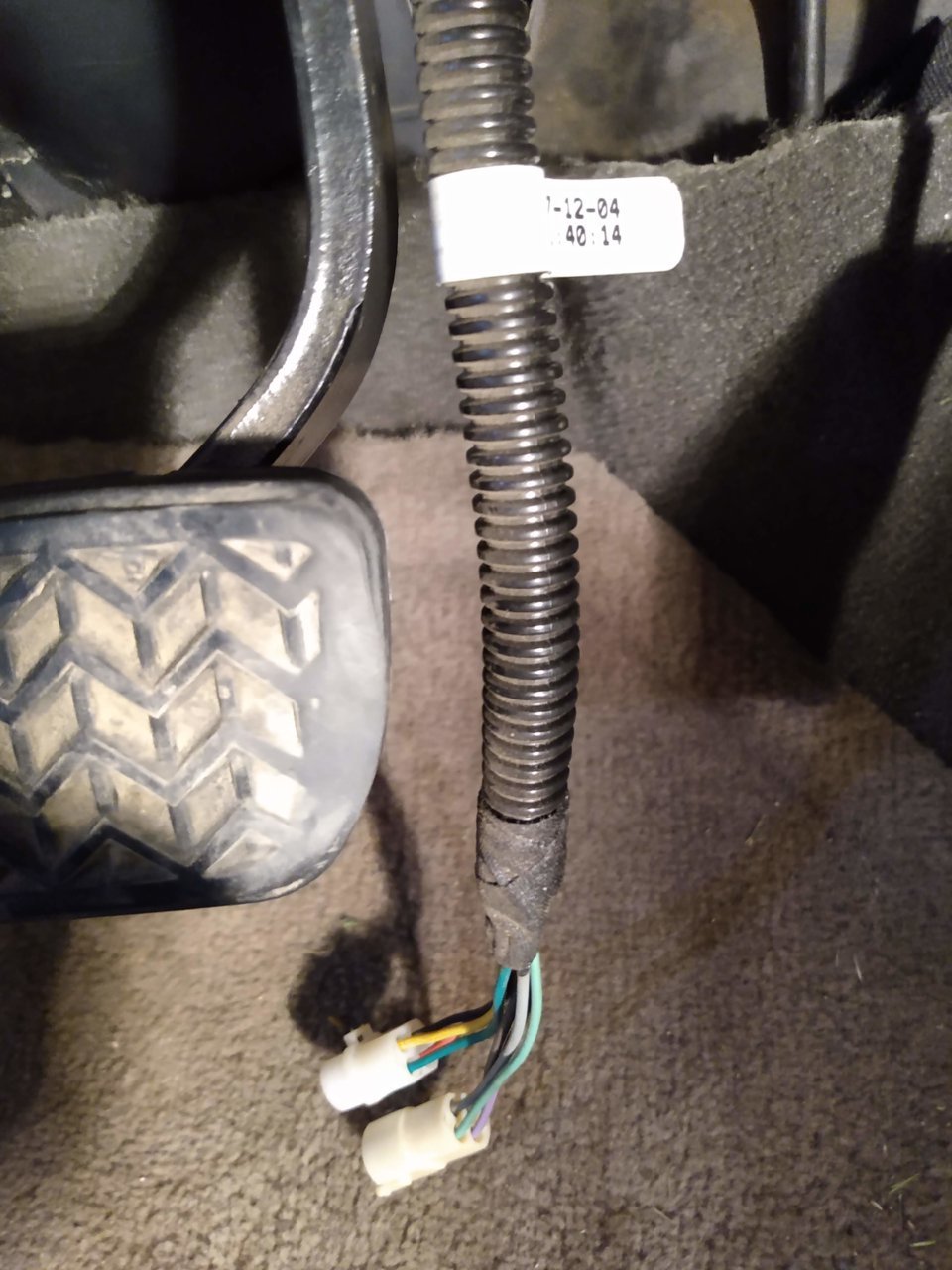

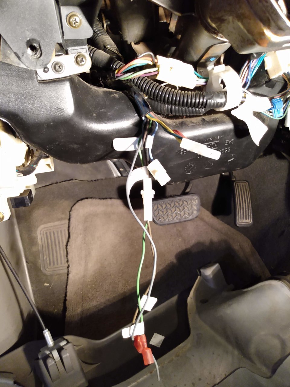

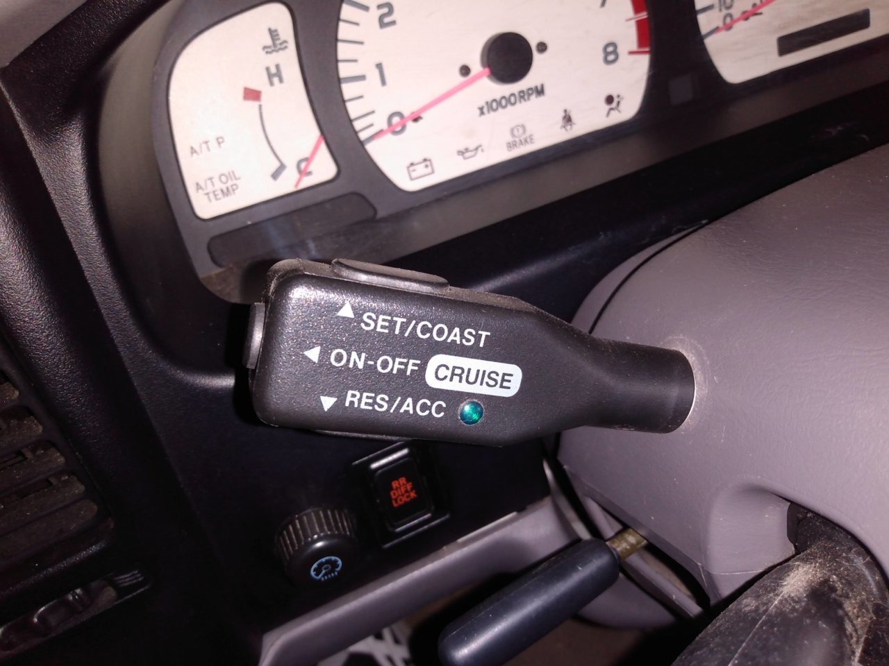

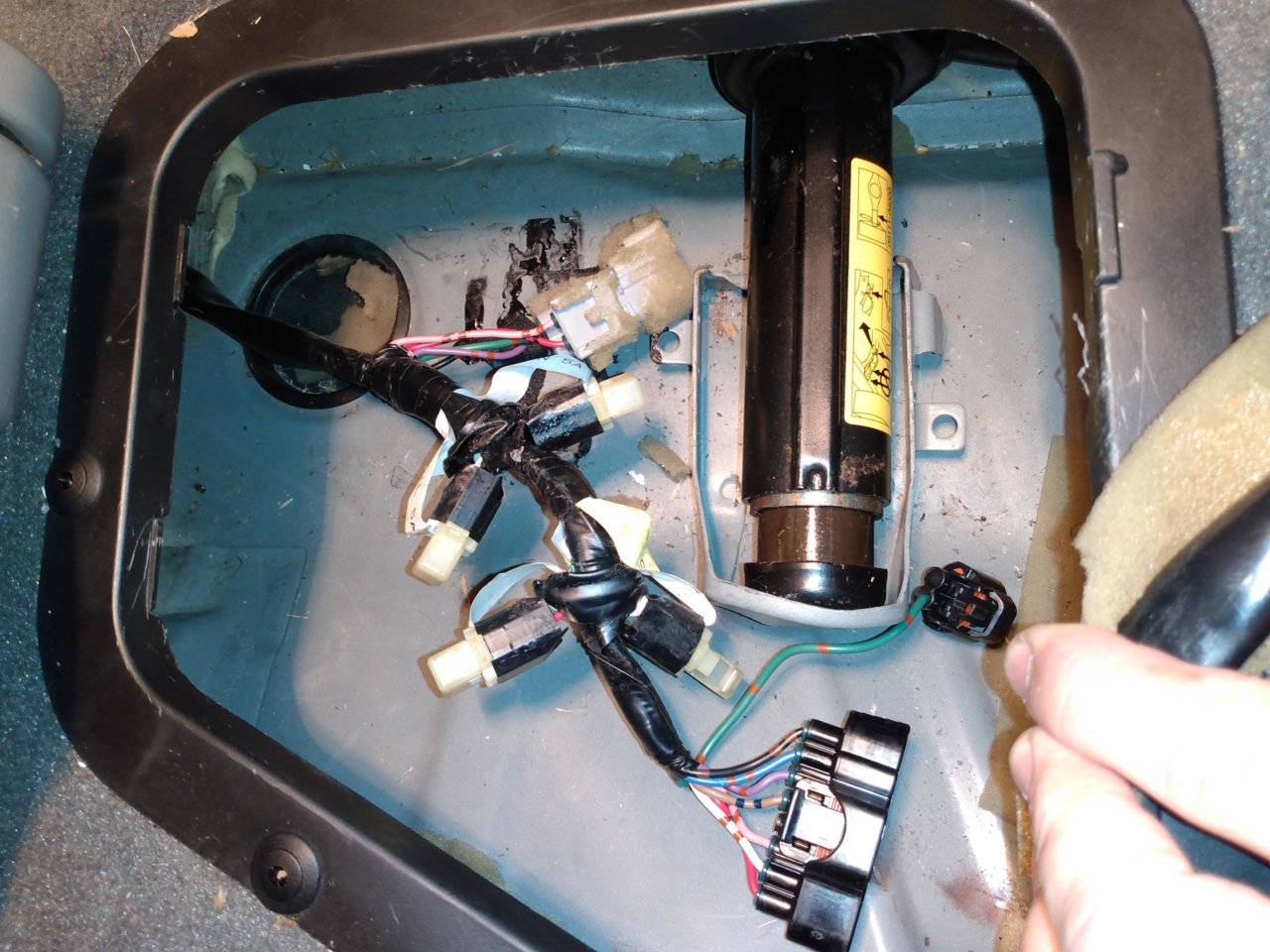

    It is fixed! There were two issues. One I probably caused while trying to fix the other. As part of trying to remove the codes, I replace the p/n safety switch. When I did so, I did not properly align the switch. There's a mark on the transmission and the switch that must be aligned. It was reading correctly in park, but not neutral. This was verified by trying to start it in each position. Before adjustment it would only start in Park, after adjustment it started in neutral as well.
    After clearing the code, the p850 was gone, but still had p705. We removed the driver's side dash and disconnected the cruise control. It looked aftermarket, and low and behold the code did not come back. We knew through testing connections in the wiring that there was some voltage feeding into the system. With the cruise removed it worked like a charm. IMG_20200503_202733156.jpg
    This cruise control never worked since I bought it.
    These are two connectors that plugged into the cruise control wiring that I removed.IMG_20200503_205214888.jpg
    These are wires that were left after I removed the cruise control switch from the column. The red connectors plugged into splices to the ignition and something else...
    cruiserguy likes this.

    You are correct, that is aftermarket cruise control. It was good of you to look at anything aftermarket installed with wires/circuits, or even dealer installed when truck originally sold, highest probability of the issue would be with those things. So good job on the sleuthing hermano :cool:
