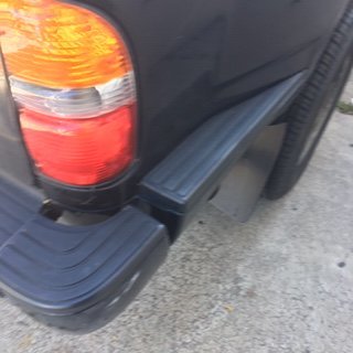

    Hoping someone more knowledgeable than I can help me out. I have a 2003 PreRunner SR5 2.7 liter 4 cylinder single cab AT Tacoma. I was rear ended a while back and ordered a replacement bumper off of Amazon (this one: https://www.amazon.com/gp/product/B01IUD9N4W/ref=ppx_yo_dt_b_asin_title_o02_s00?ie=UTF8&psc=1) which according to Amazon fits my truck. Went to install today and found out it indeed does not. I stupidly removed my old bumper and installed the new brackets and was trying to get the new bumper on when I realized there was no way. Doesn't fit the shape of my truck at all. It's clear when you compare the two bumpers to one another which I should've done in the first place (live and learn...).
    I'll upload a picture of my bumper. Just looking for a replacement and don't want to order the wrong thing again. Any help would be greatly appreciated!

    If your Taco is a stepside, which I think it is, then that bumper will not work.

    Yeah it is a stepside. Any idea where I can find the right bumper?

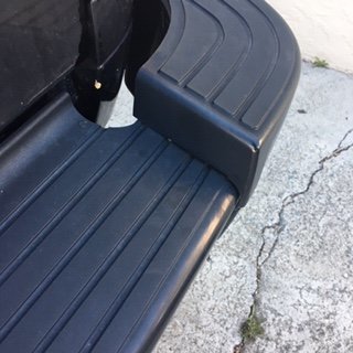

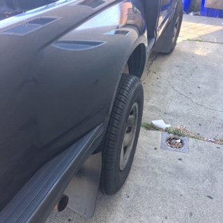

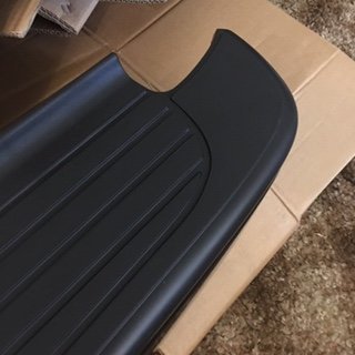

    Don't think so. Looks different to me. I'll attach some more pictures. The last one is the corner of the new bumper. You can see it's shaped differently to mine.

    Think you need to just remove those corner pieces from your old bumper and transfer it to your new one

    Ah the elusive Stepside. They’re really uncommon and have a unique bumper.

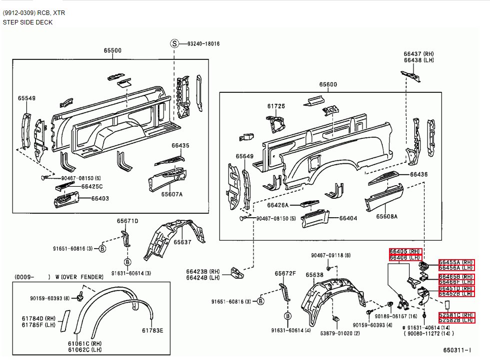

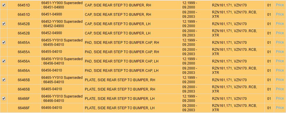

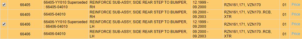

    Everything that I have read is that the main part of the stepside bumper is the same as the normal one. The only difference is the extensions/pads that go on the ends. I've never seen one in person so I don't know how it attaches though.
    This is all taken from here: https://japancars.ru/index.php?route=catalog/toyota&area=US&cat=674460&pn=4332439015&blk_id=6554
    you can also reference these parts in toyodiy.com: https://www.toyodiy.com/parts/p_U_2003_TOYOTA_TACOMA_VZN170L-CRMDKAB_6554.2.html?hl=66405
    EDIT: I just realized that the gap between the bedsides would be smaller on the stepside. I don't know if the stock bumper sticks into this area, but I know that the bumper pads do. Therefore you would also need the correct bumper pads.
