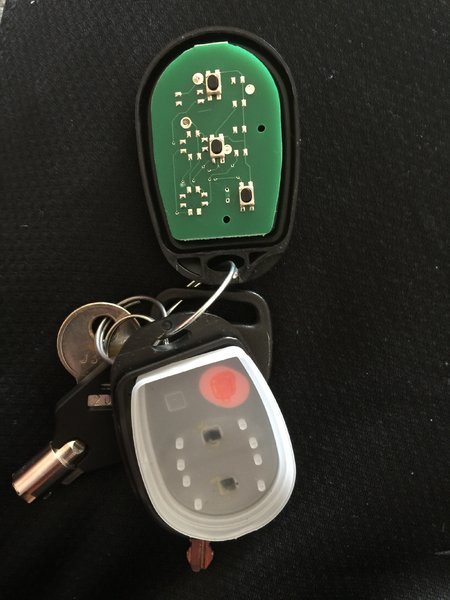

    I believe the seller from whom many of us bought no longer sells fobs. All fobs are not created equally. In order to work with a given vehicle, they must be equipped with the correct transponder. These vary not only by vehicle manufacturer, but also by model and sometimes even model year. Recommend posting details (listing, pics, etc) of the fob you purchased to try confirming compatibility.

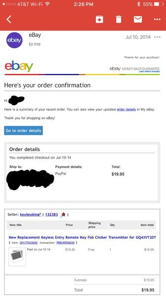

    Thanks for the input. I bought the key fob shortly after I got the truck in 2014, so the details of the item aren't pulling up in ebay anymore, but I have my original confirmation email, which I believe has some info:
    I tried to program it back in 2014 with the same results and figured I'd get back to it in a weekend or two. Life happened and I didn't get back around to it until this weekend when I was detailing my truck, so I figured I'd do some more research before I gave up and bought another.

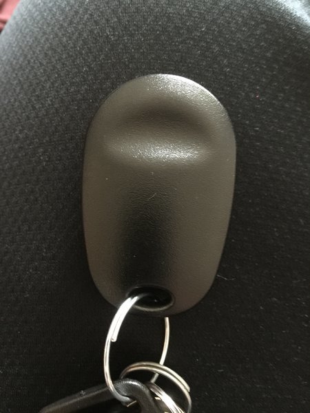

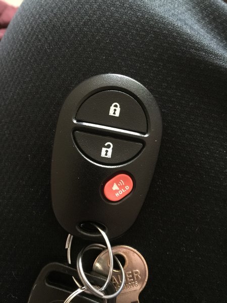

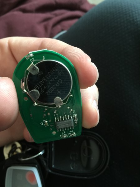

    Here are some pics of the key fob inside and out.

    The transmitter type (GQ43VT20T) is right for later model Tacomas (e.g., 2012 and newer), but I'm not sure about 2011 and earlier. FWIW, a couple of current listings for GQ43VT20T fobs say they're NOT compatible with the 2010 MY.

    Damn, it definitely said it was compatible with my 2010 when I bought it. There's not much I can do about it now either since I sat on it for too long. Thanks for the info. Can anyone link me to something that will definitely work for a 2010? I don't want to make the same mistake twice...

    I don't dispute your report, but looks mean very little about what kind of transponder a fob contains. (Some can even be "transplanted.")
    I'm not an expert on these things, but I've done a bit of reading about them and purchased aftermarket ones for several vehicles. Obviously, eBay listings aren't an authoritative source for compatibility info. I just grabbed a couple of them and found it coincidental that neither listed compatibility with your truck.
    Interestingly, that one lists the same (GQ43VT20T) transponder type. If it works for you, OP, you appear to have received a defective one from the eBay seller.
