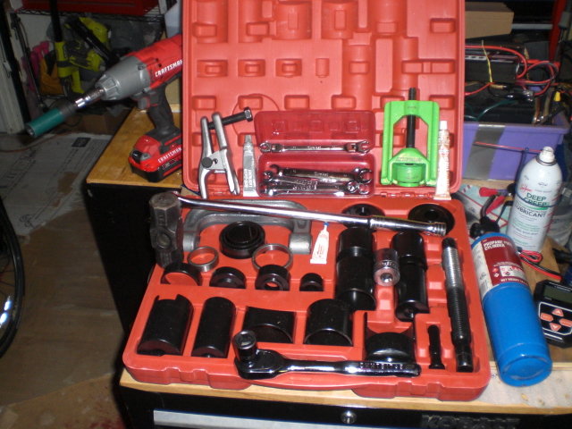

    I used this....cheap as $50....

  8. Oct 26, 2023 at 6:31 PM
    O'Silver_Taco
    O'Silver_Taco Well-Known Member
    Aug 26, 2021
    #375390
    3,989
    MD
    98 Dlx Sr5 ext AT Rwd
    3rz to 2Rz bebuilt block and new heads

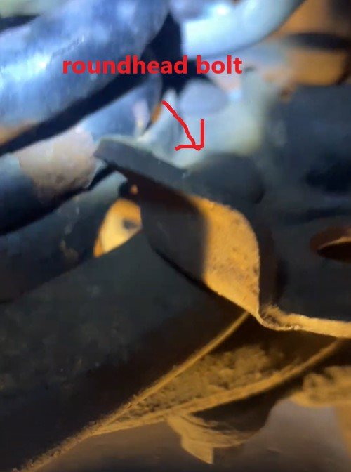

    Getting back to this. Still the same issue as the video in the OP. A neighbor suggested clamping the bracket and rod down to the LCA so that things stay put, then thread the nut (bottom of the pic) partially onto the bolt to protect the bolt end, pound the nut upwards with a sledge, and hope the roundhead bolt dislodges from the bracket. Then the same for the other bolt next to it. The bolts appears to be pressed hard into the bracket.
    Sound like a reasonable plan?
    Otherwise maybe use some sort of press directly on the nut to push it up, if possible?
    Assuming the roundhead bolts are not welded onto the bracket (it doesn't look like it), they should pop out with some force, right?
    If all goes well and I get the rod replaced, I plan on taking an impact to tighten the nut, and hopefully the bolt will get pulled down and pressed into the bracket again and be immobile so that the impact can tighten the nut? It seems so weird. Why would they not have a regular hex bolt there?
