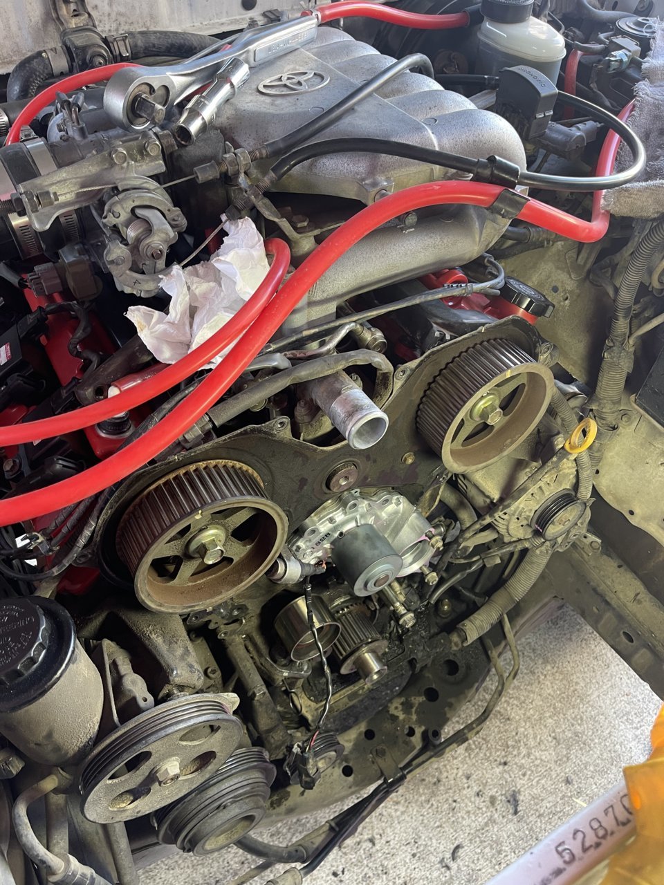

    So I’ve loosened the front timing belt tensioner bolt but I’ve managed to strip the back bolt. The front one loosened easily but the back one felt like it was on there wayyy too tight. Both are only 12mm.
    My question is, is there a way I can remove the timing belt without relieving the tensioner? Sure I could cut it out since I have a new one but I’m sure I won’t be able to put the new one on without using the tensioner. I got an 8 hour drive tomorrow going back home so I’m pressed for time.

    Yes, remove the top idler pulley, timing belt will come right off.

    When you say "strip," do you mean rounded over the head? If so, you might be able to unbolt the PS Pump (I don't recall if you can do this without disconnecting the lines, but even that isn't difficult as long as you have some ATF to refill) to get better access to the tensioner bolt...ultimately to remove the tensioner by using a 6-point instead of 12-point socket (for instance), some penetrating spray, heat, etc.
    If you mean that you actually stripped the threads, I'm not sure I'd want to run it that way (with just the front bolt)... so I'm hoping this isn't what you mean.

    I'd keep trying to remove and replace that bolt after you release the belt tension.
    A 6 pt. does the trick.
    I like a 1/4" 6 pt. on a 6" wobble extension straight from bottom.

    So I was not able to get that bolt out and ended up leaving the tensioner in there. I did manage to remove the timing belt anyways buy doing what zero4 said along with following Timmy’s video and a little dish soap we eventually got old one out and new one on. It’s all put back together now and I just need to finish flushing the system and adding red coolant in the morning. Thanks to everyone for the replies.
