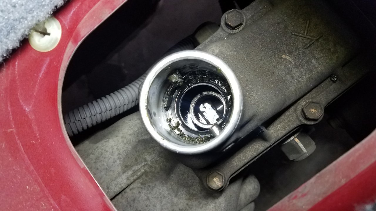

    shifter seat bushing and new fluid are quick and easy things to try and probably needed any way.
    Here's what my original bushing looked like. All the little blackish/green pieces are all that was left of the bushing. I was having random getting into gear and also popping out of gear issues. This fixed both.
