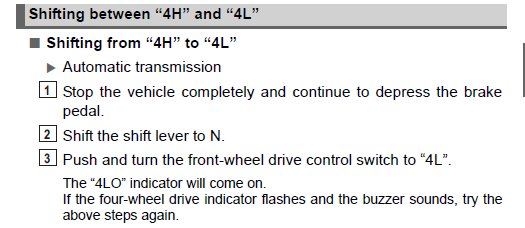

    I have a stupid question. The owners manual shows the following for switching to 4LO:
    I assume after you switch the dial to 4LO you also want to shift from N back into D? Owners manual leaves that step out apparently...

    Yes. You go into neutral and if the 4LO light remains solid, you're engaged so now shift into Drive and you're ready to drive.
