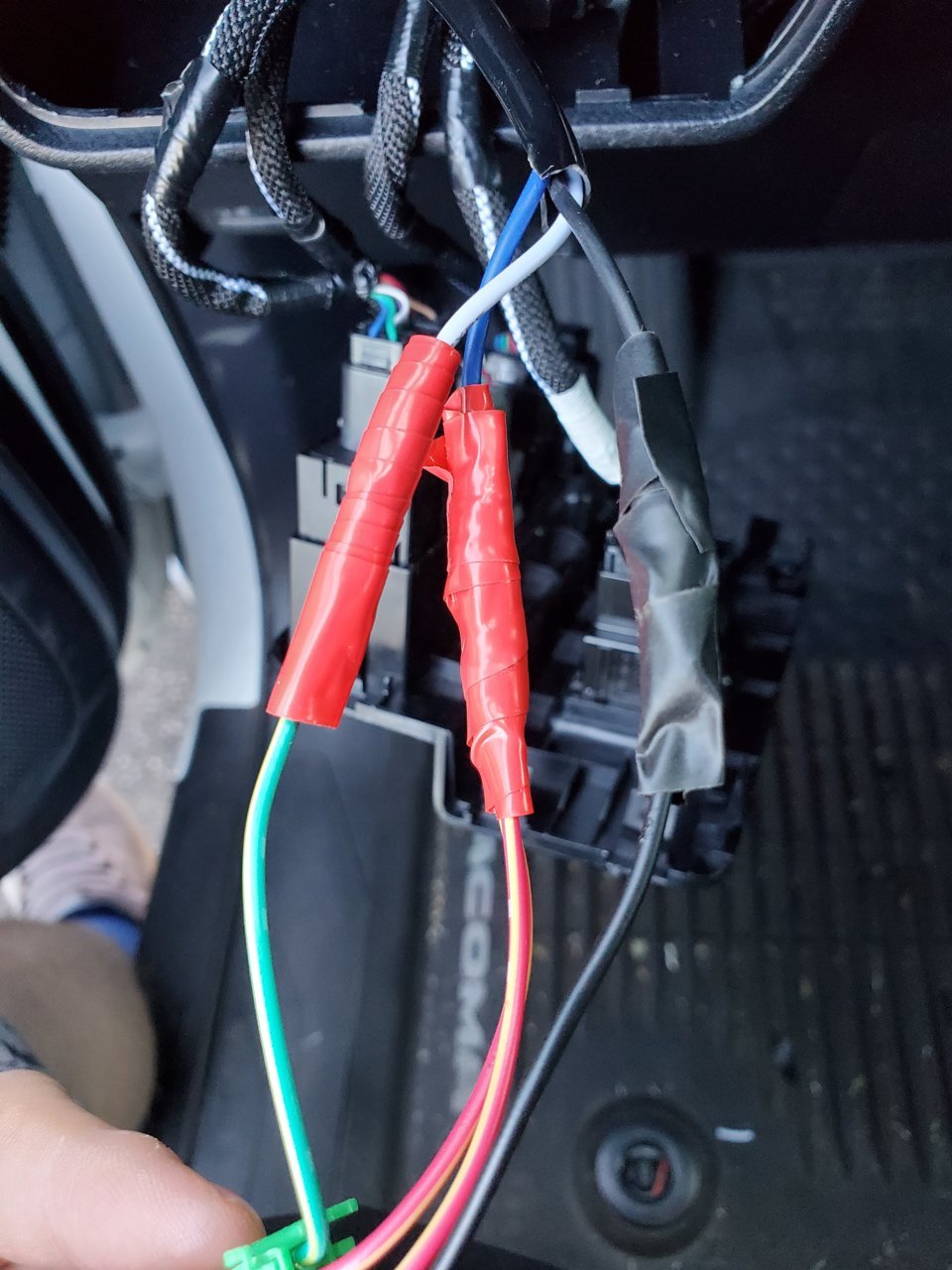

    Switch side wiring btw:
  11. Jul 2, 2020 at 9:27 AM
    #31
    prplefrutlup
    prplefrutlup [OP] Well-Known Member
    Dec 22, 2019
    #313947
    272
    Corbin
    San Mateo, CA
    2020 Super White TRD OR DCSB
    Going to rewire switch side and see if I can get a better connection

    Well! Thank you all for your help. I went and bought new crimp connects and rewired the switch. And what do you know, they work.
    I think the connections around the switch weren't great
