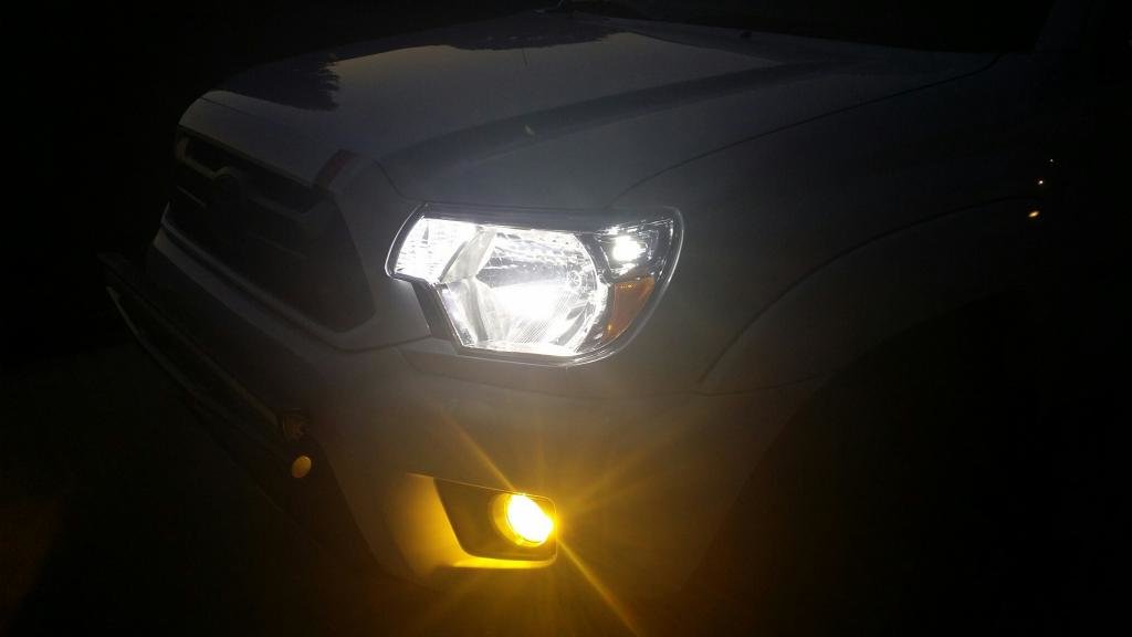

    Honestly I never messed with adjusting mine. I'm like you though and can't stand when my lights don't match. So I did what anyone would do... I put yellow bulbs in lol
    Silence9[QUOTED][OP] likes this.
