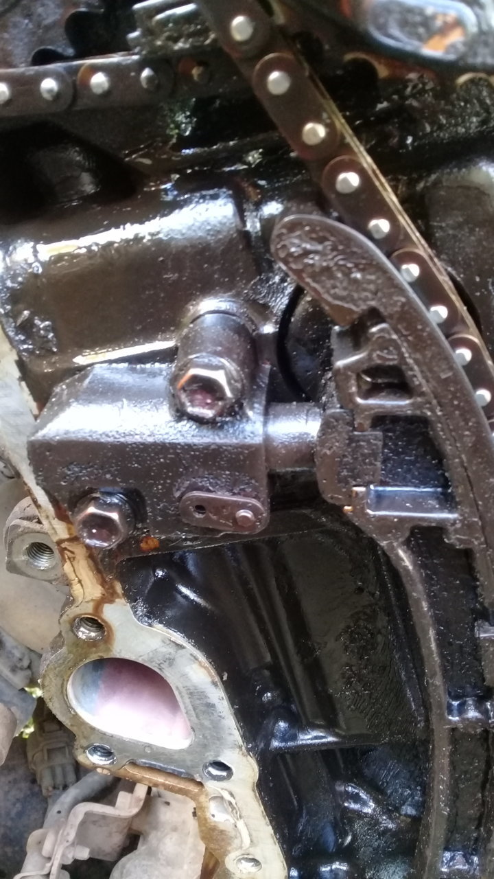

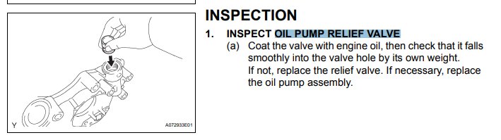

    The other thing I am wondering may have happened is if the Relief Valve stuck, and the oil pressure dropped, possibly this caused my chain tensioner to get stuck, and the noise is actually coming from the chain due to stuck tensioner. By inspecting the timing marks, it looks like the chain is OK, and the tensioner is not extended as would be with a streatched chain, so I thought it was OK, but if the tensioner is stuck, then maybe thats the problem causing chain slap? There are no chain marks on the valve covers, but maybe the slap was between chain and the guides, don't know. Need to check the tensioner if thats possibe to tell if its bad, not sure how.

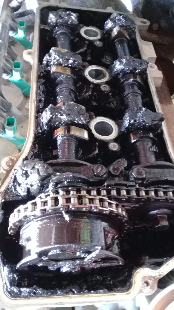

    Here it is after my pressure wash with just water today. Got most of the thick Sludge out.

    That is the dirtiest 1grfe I have ever seen! I imagine your oil screens one per bank are clogged af. In the future if this thing runs again- switch to synthetic for any long duration of sitting. I honestly wonder if foul play is/was at work here.

    that oil ran hot and was run for a very long time. thats the forbidden chocolate frosting

    wow, last time I saw that much sludge was in early ‘70s with engines running Quaker State oil back then.

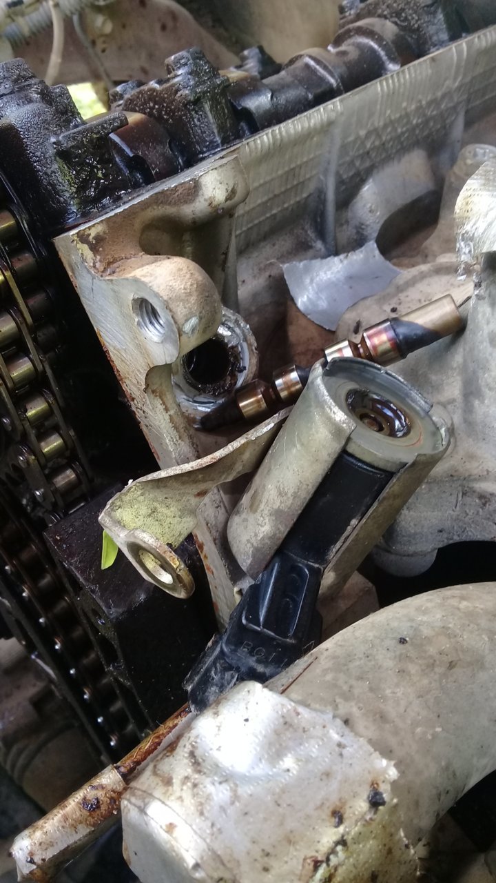

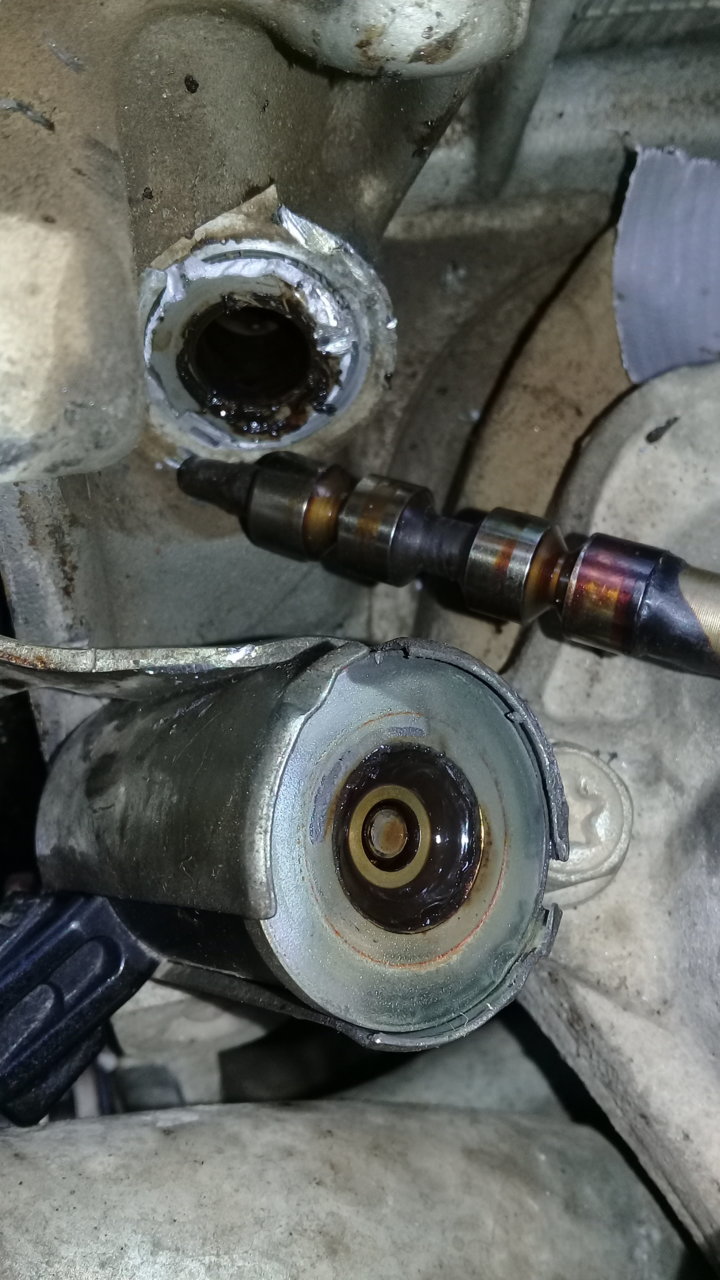

    Hey Guys, thanks for the input. Well the oil pan is basically dry today, sprayed it out also with air. I was thinking the sump screen as well is clogged, so may just need to take the pan off to clean it too. Its my only truck, so need to get it running and plan to keep it forever. Chocolate on the engine was my thought also. Once I get it running I plan to do a good flush with MMO, or 1 qt. ATF (500 miles) and change oil and filter again. The timing chain tensioner isn't extended, so chain seems OK as marks are also aligned but with 148K wasn't sure if I should change it anyway or leave it (any thoughts?).
    Working this morning on getting the cam valves and oil screens out. As to be expected the valves came right out with solenoid first... then valve core plunger. So I need to apparently tap the right size bolt in to pull the rest of the valve body out (not sure who came up with this valve design... o_O. The oil screens of course are also basically glued in, so not sure what the trick is for pulling them out. Any suggestions or whats the trick? I'm still not sure what the noise was, and after running it a time or two before breakdown it actually couldn't be heard at idle, needed to rev it a bit to hear. I isolated the noise to lower part of the timing cover and heard directly through the oil filter, so that's another reason I thought it was a clatter from the oil pump. Still not sure, but I'm not ready to drop the crank and pull the engine to find out. Anyone have the spec for the clearance between the oil pump and the crank gear? This is the sound I posted in the Fb group link.
    Thanks

    I had the same solenoid problem as you, on one of my past engines. I sprayed some WD-40/penetrating lube around it. Then twisted the body back and forth. Until the o-ring was free enough. Then gently pried it out. Maybe a heat gun could be of use as well.

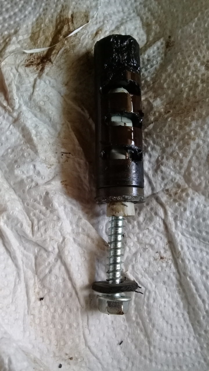

    OK, I got the OC valve out using a PVC cement anchor the right size, then put a screw into it by holding onto 1/4" of the exposed anchor with a pliers so it wouldn't spin. Then pulled it out with the help of my hammer claw.

  19. Aug 10, 2021 at 10:52 AM
