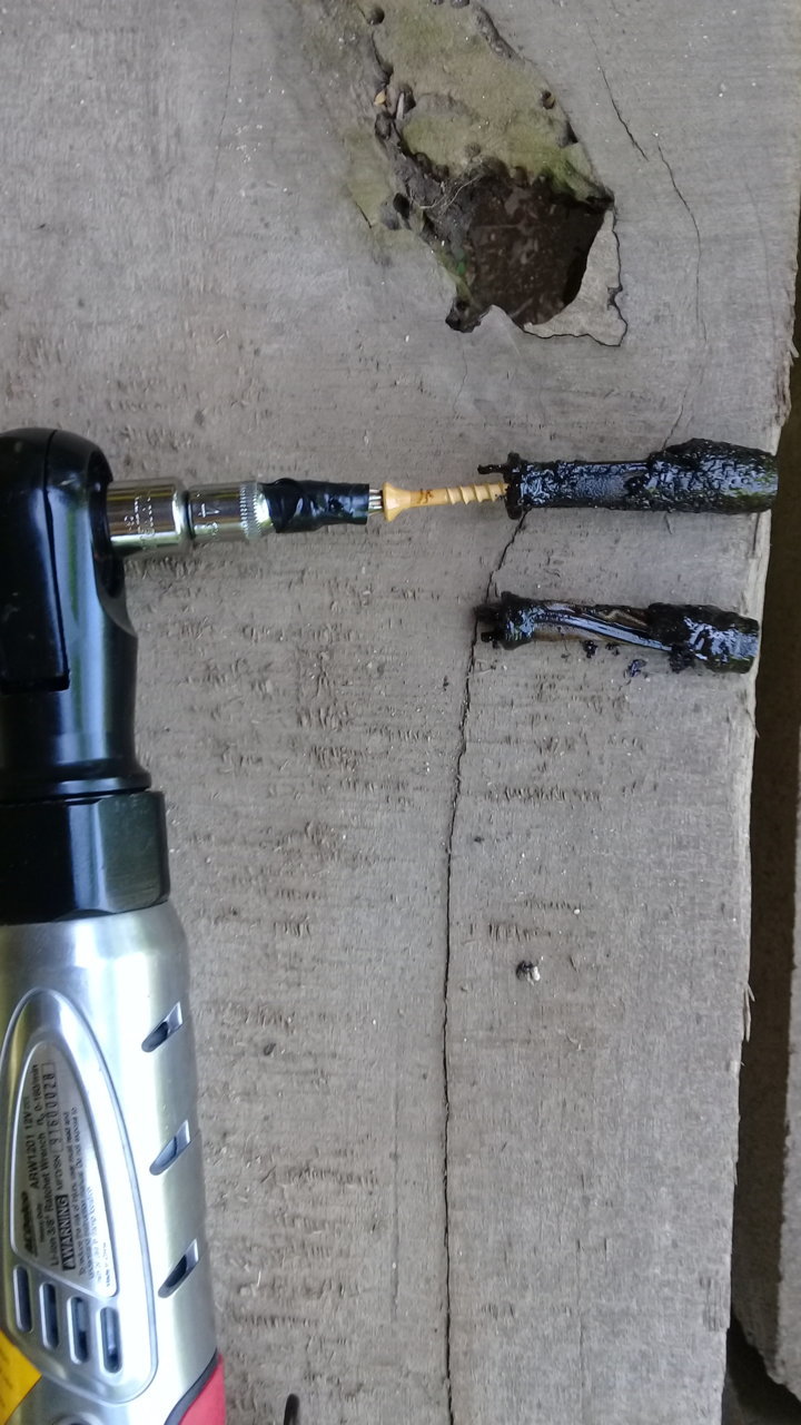

    OK, success with getting the screens out as well - a little dirty probably time for new ones. Turns out a deck screw works pretty good, just go right through the center of the plastic and pull.

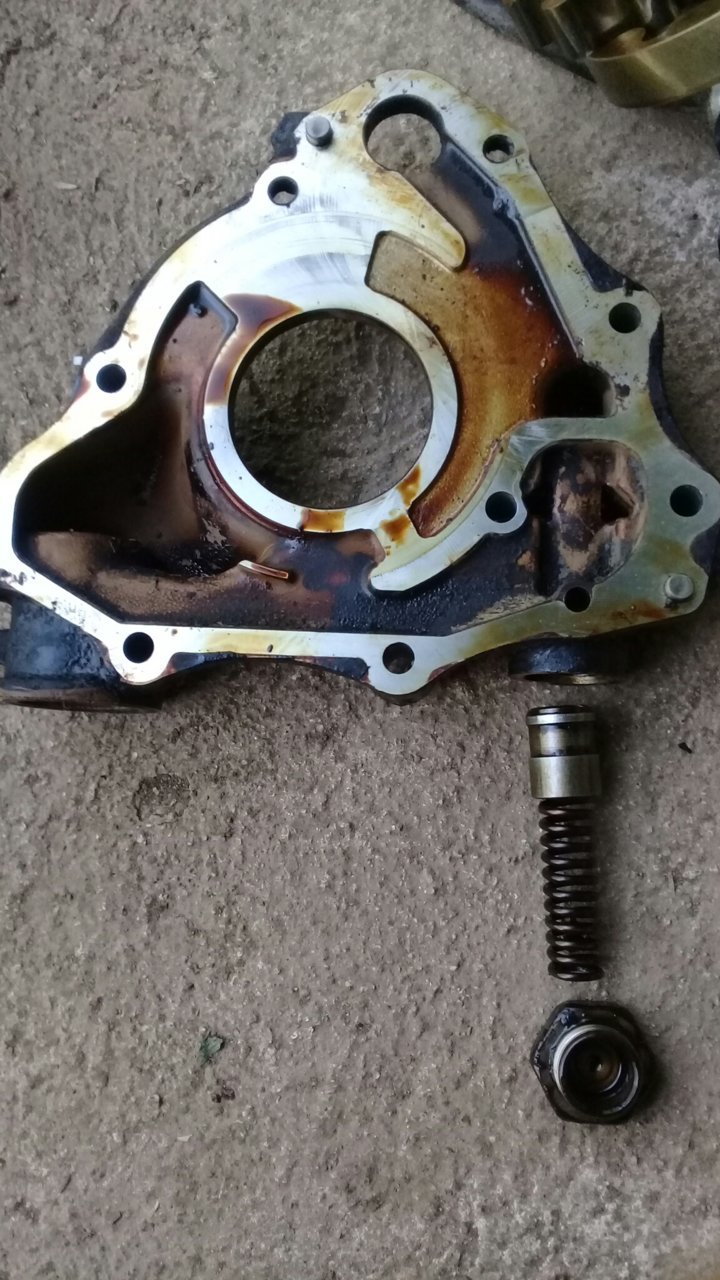

    Now just to figure out what the problem is why I tore into this in the first place. Would have liked to found the culprit for the noise. Sure sounded like the oil pump clatter to me as it came from that location (and didn't sound like a rod bearing). I wonder if my oil pump Relief valve sticking shut could cause that or if just oil starvation due to clogged uptake screen would make the pump clatter? Only thing that throws me off on that is when it clattered (possibly due to starvation from the uptake), I never had the oil light come on when parked bringing up to 1,500 rpm. Maybe the clatter was from the starvation and the oil pressure switch was waiting for the pressure to get to a severe low level??? When it first happened and I drove it home up the hills, with the load, it would clatter and the oil light was on.

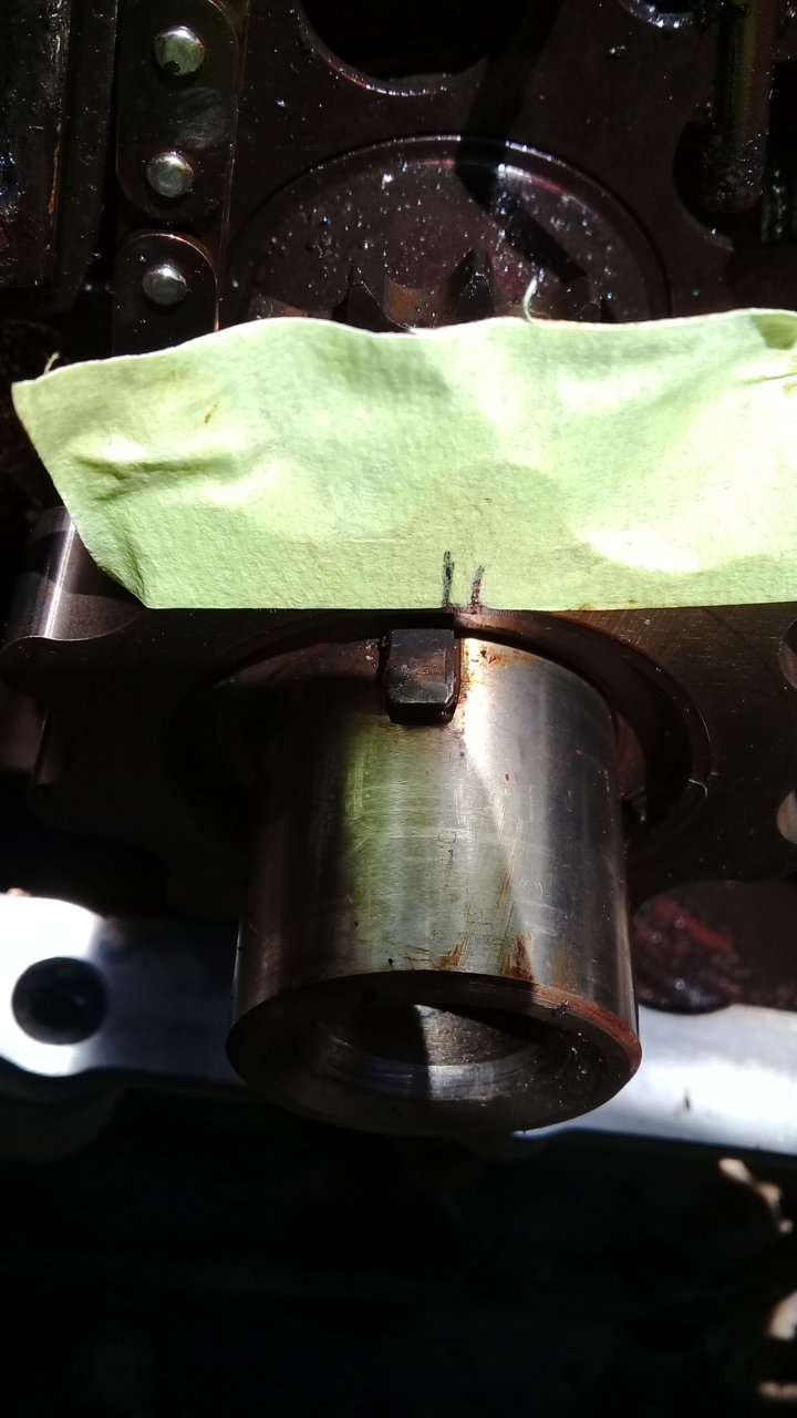

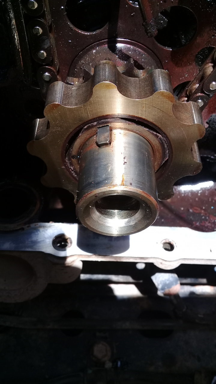

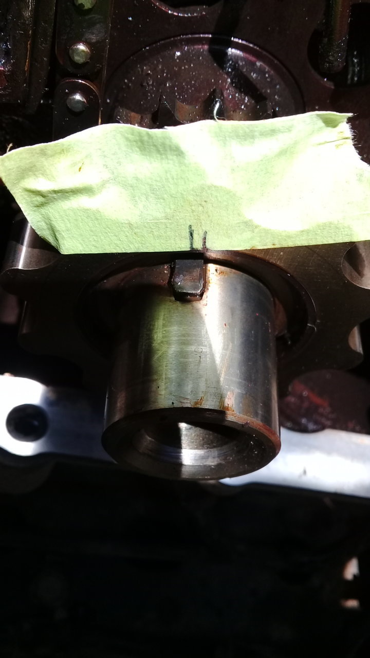

    OK, as mentioned I was looking for any specs for the crank drive gear for oil pump for clearances or something. Maybe its not an issue, but putting my oil pump gear on the crank gear, I get about 3/16" slack with rotation from counter rotation positions (lining up with right side of crank key). Also there is some lateral play with the gear on the crank gear. Seems like it should be a better fit, but I have no way to know. Just wondering if anyone thinks this could be the cause to what is causing my possible oil pump clatter...

    I'd send both heads out to a machine shop for a rebuild if it were me. Bottom end is probably gone
    And honestly, this is probably the best example of why quality motor oil and regular scheduled oil changes need to get done.

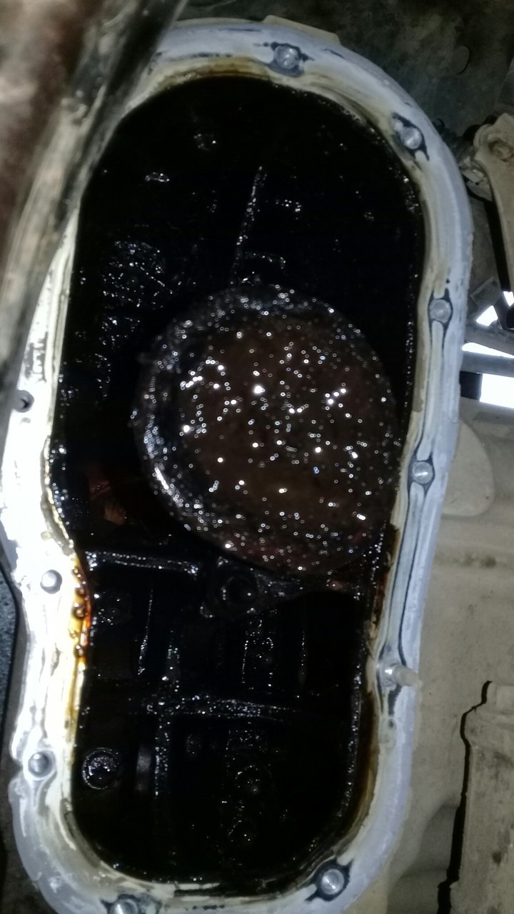

    OK, so I went ahead this afternoon and pulled the oil lower pan off to check the sump screen and its a bit dirty... so need to clean it up. Had about 50% air flow suction by mouth towards pump, but I'm sure would be less with oil viscosity. Time to finish my parts/gasket list and get the things to put it back together. Probably going to go with some good advice from those of you here and because I'm poor, to just not replace anything because the oil pump is within specs, the timing chain is only slightly stretched and timing is on the marks. Water pump is also still good. Just need to get new Oil control valves and screens, throw it all back together with new oil and filter with 1 qt. ATF with as minimal cost as possible and cross my fingers and see what happens when the hidden crud breaks up, if the clatter is gone then I should be good for awhile after another oil change and the problem was just sludge causing the stress to the oil pump making it clatter (or stuck chain tensioner making chain clatter). If not, will be back to the drawing board to do it all over again another day :fingerscrossed:...

    No metal shavings in that sludge?

    I didn't see any with a quick look, but I'm saving that thrill of an inspection for in the morning when I get it cleaned up. Good point, I will keep you posted. :thumbsup:

    agreed there is sludge in the engine that does NOT drain
    with that much sludge oil passages could be blocked
    allowing for starvation to vital parts
    the check valve likely does NOT stand a chance against thet amount + thickness o sludge

    That’s an insane amount of sludge!
