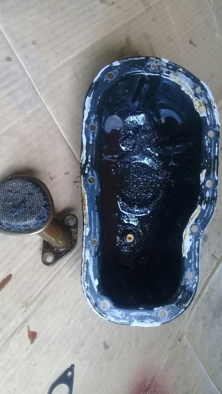

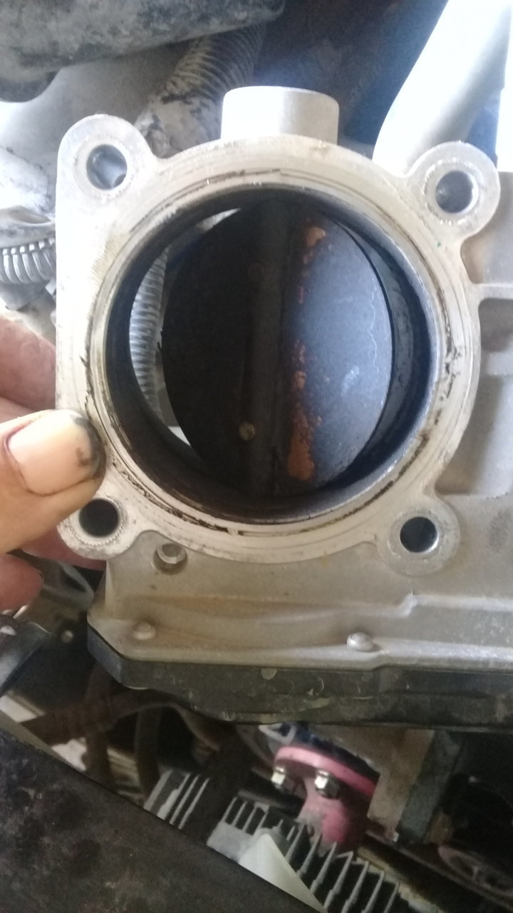

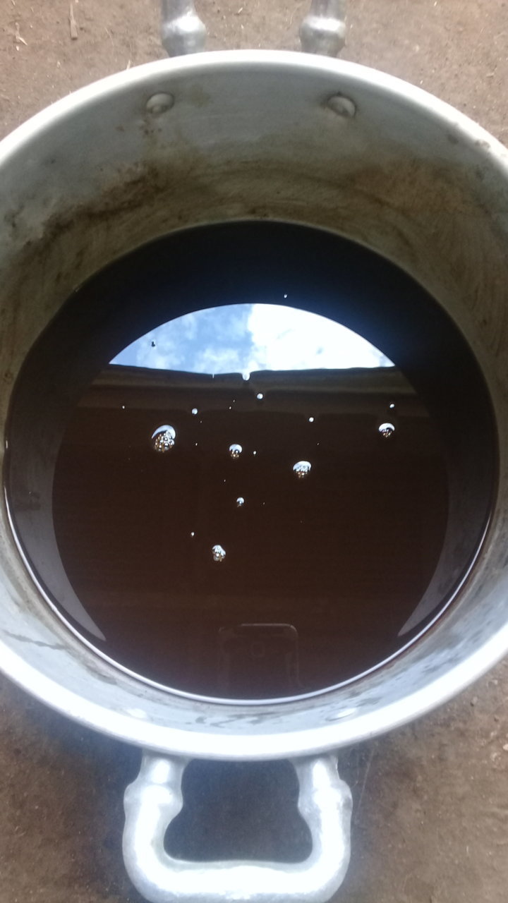

    Hi guys, so here is the update. Drove to town total driving around about 2 hours with all the stops. Everything working great and sounds great. After the build I did my "poor man's flush" to clean out any of the loose sludge I had knocked loose from the pressure wash of top end and to try to reach many of the internal areas I couldn't reach. I couldn't afford throwing away $50 of new clean oil for a 20 min flush (regular motor oil is $10 a quart here), so I opted to use a cheap soy cooking oil 4 Liters, but I first added 1/2 Liter ATF, 1/2 Liter Kerosene, and 1/2 Liter Diesel fuel, then the cooking oil with new filter of course. Started it up and all sounded good so I continued to idle it for 20 minutes. I then turned it off and drained out the hot oil and let it drip dry. Pulled the lower oil pan off to check the pickup screen again and what had ended up in the pan. I was glad I did... plenty of junk made its way to the bottom (about 2 TBS) and the new clear oil was quite dirty after just 20 minutes with the screen showing new crud. I cleaned it all back up, put the pan back on and another new oil filter and filled it up with motor oil and 3/4 quart of Marvel Mystery Oil. I will keep an eye on the color of the oil to see when I may want to change it again. Also, I took a pic of the inside of the throttle body before I cleaned it all up. Thanks for all the help. Here are the pics...

    You've been quite thorough and it has paid off. You saved your future self some problems by dropping that lower pan. Well done.
    Is that rust on the back of the blade of the throttle body?
    Also, how is it running now?

    Hey, no rust, its made of some kind of aluminum material I think, or maybe brass, just stained and that's the metal you are seeing. The black is like carbon, that cleaned off quite easily. Reminded me of brake shoe carbon. I'm not sure if the cleaning made a big difference but it did seem to be sticking when I would open the valve wide open and it would come back to close and stick about 1/2" from closing totally from the springs and gears in the motor I couldn't open as its sealed shut with rivets. So I just sprayed the WD-40 at the pivot points to give better movement and kept opening and closing until it would close by its own spring pressure. That could have been an issue, but I still think the no throttle problem was the Master air flow being so dirty. Its like the computer would let me rev it when first started, then it took the throttle off line. Weird. But all is working well now. I am sure glad I took the pan back off because I was pretty sure I would have had some junk that fell down into the engine where I couldn't get to, such as in the upper pan, even though I blew with air a lot. Thanks for the help and being a sounding board as I went through it. My first time for this truck and hopefully the last.
