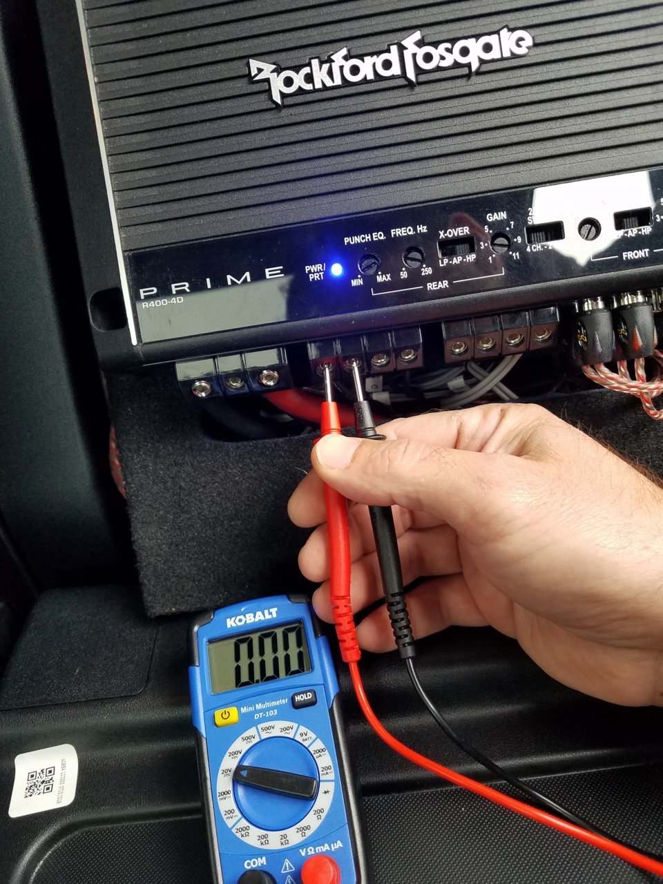

    So I picked up a cheap Kolbalt MM and I get 0.00v. I had a sine wave running from my phone at 1kHz. What am I doing wrong? The MM shows roughly 13 volts when I check the amp power terminals as expected. 0.00v when i check any of the speaker output terminals.20210317_182238.jpg

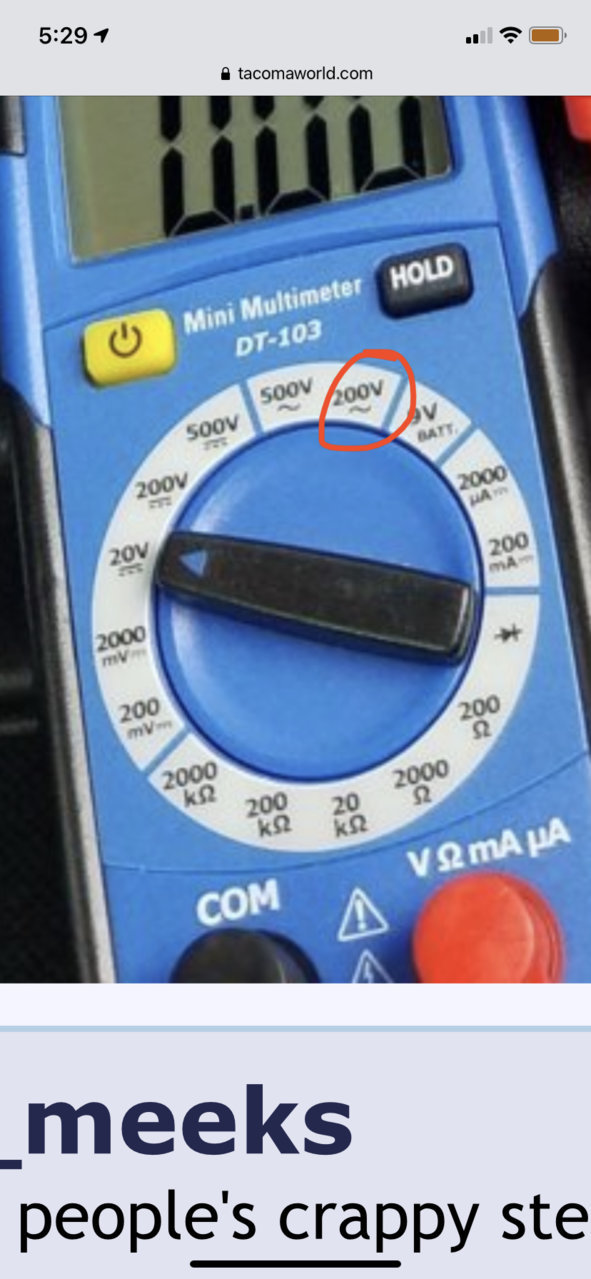

    Audio is AC volts. You’re set to DC

    You also want to disconnect your speakers when doing that, because pumping sine waves into them will blow them faster than anything else (and hurt your ears)

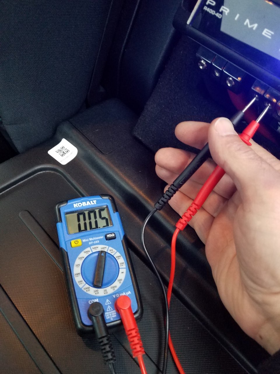

    No, not if there “should” be audio playing.
    turn off the truck, go to the battery, and pull the amp fuse.
    count to 30, and put it back.
    try again

    Yes there was sound. No issue when I took the measurement. Ill pull the fuse and remeasure.
