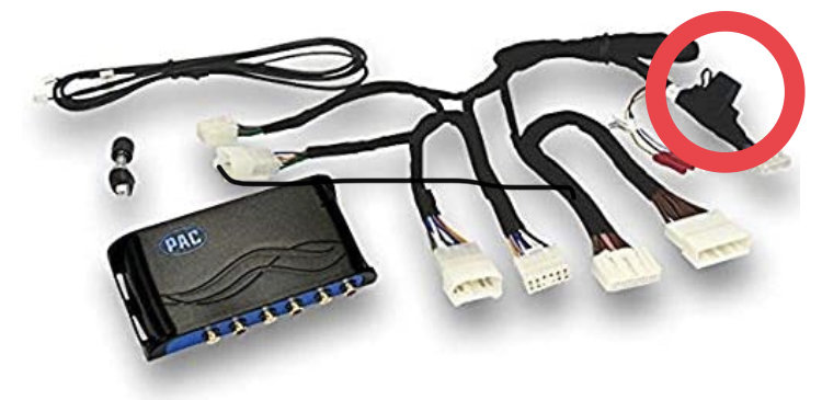

    It looks to me like you are assuming the AmpPRO has power. I’m guessing you just swapped in the replacement and used your existing harness. Did you check the in-line fuse?
    Did you measure voltage on the RCA output?

    If the AmpPro didnt have power I would have no audio output. Yes I just swapped in the replacement. I haven't measured RCA output. What voltage should I expect?

    It would show line voltage, normally 1-6 volts at reference.
