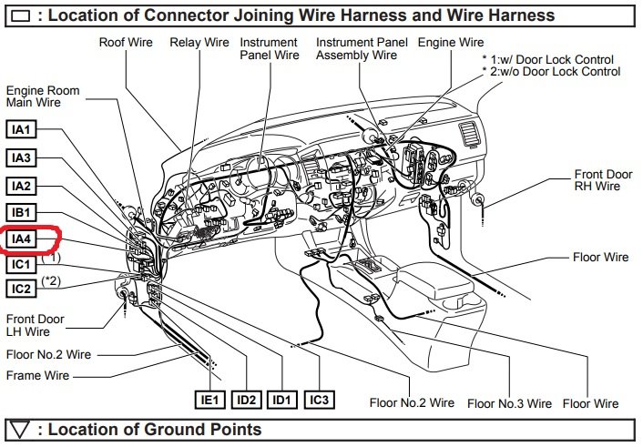

    You may want to check connector IA4 Pin 8 (Black/Yellow) behind the left kick panel.

    The wiring diagram is posted above.
    I'd check Connector IA4 first like I said above.
