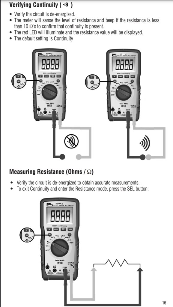

    It does, but the meter defaults to continuity first on the ohms setting and I have to hit the SEL button to read resistance. I believe I have to hit the button while the leads are attached, which is difficult by yourself. I could be wrong. Its an IDEAL 61-347.

    I wish my meter had them separated out like yours does. That would be much easier.

    That's not mine, it's just a random picture of one I found with labels but pretty much every meter I ve seen even the dirt cheap ones have resistance and continuity separated.
