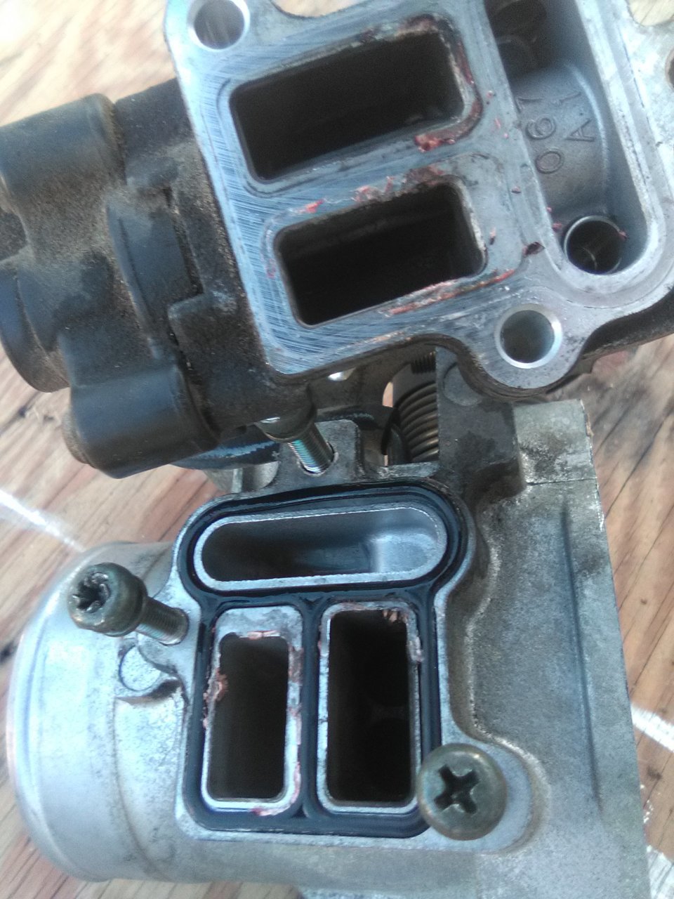

    I got the throttle body off. That's it so far. Not exactly easy by my standards, but I got it off. There were two small hoses connected to the underside that supply antifreeze to the IAC that I didn't know existed until it became time they needed to come off in order to get the throttle body off.
    It also seems clear what the problem is. It looks like the gasket leaked, and allowed some antifreeze colored, purple/red, crud to escape from the oval shaped area over to the two rectangular areas.

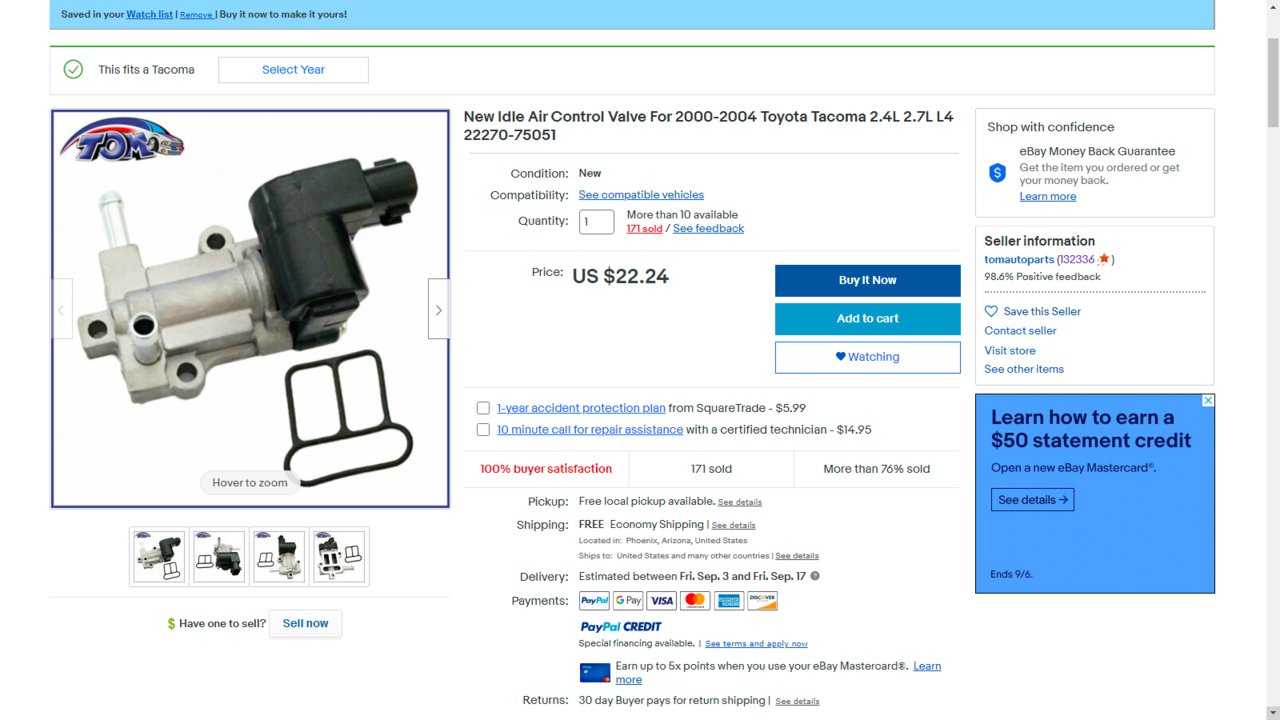

    I cleaned the IAC as per the video and re-installed it and it seems to work fine now. Truck starts and idles. Yesterday was the first day I got it back in and started it and I was concerned because the idle seemed rough and wanted to drop and then the "check engine" light came on. But this morning I started it and all seems fine, drove it on some errands, idles fine, no "check engine" light.
    I think I should get a new IAC anyway in case this fails again. I see you can buy them for $25 or less on Ebay. So why is the dealer telling me $444.65? Seems crazy. I will get one of the Ebay ones and if the need arises install it and hope it is not some fake piece of junk. I figure it may be the same quality as what the dealer is selling.

    Because the Ebay one probaly has <25% chance to work out of the box and last more than a week and the OE one has >99% chance to work and last the rest of the life of the vehicle.
