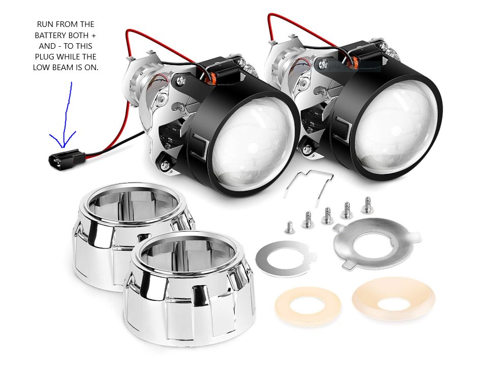

    Have you tried this?
    HCFab[OP] likes this.

    This plug is connected to the relay harness, it toggled just fine before final install, I'll update in a few hours after I check 12v directly to the plug. This will verify that the problem is not the lights/relay.
