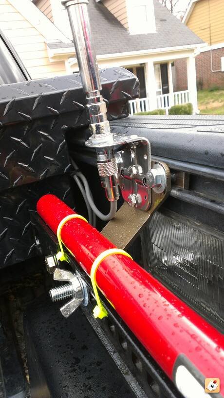

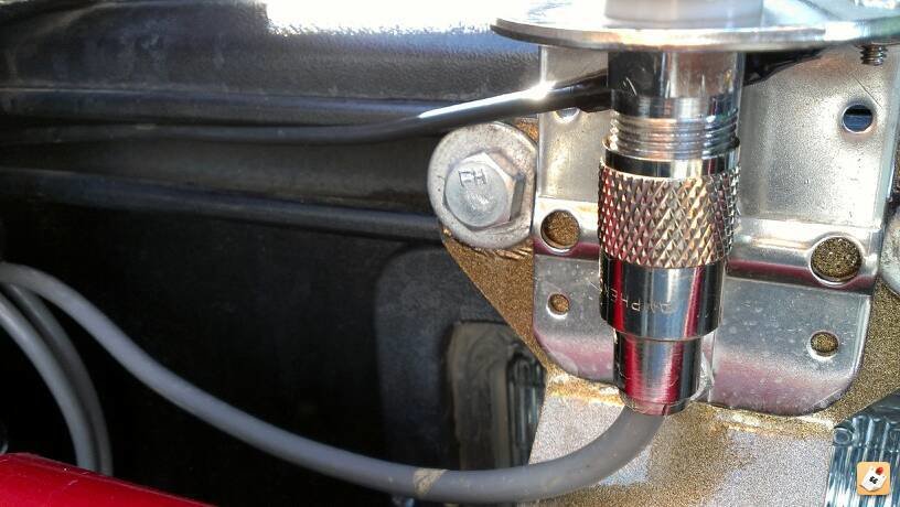

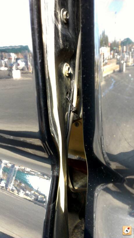

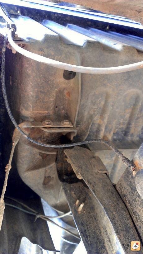

    Here's what I did. I also used a #8 wire.

    AllMotorRex: Thank you, that's exactly what I was looking for. My antenna is in almost the same spot as yours, and that is is exactly what I wanted to see. Thanks again.
    I will try this grounding position, see if anything improves as a result.

    No problem man. And remember to scrape off the paint in the spot you ground it. You can paint back over it once its on there
