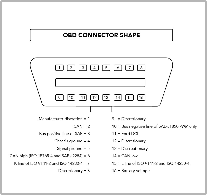

    Have you checked the terminals of the DLC?
    Pin 2 is the data line to the PCM (Connector E5 Pin 7 (White))
    Pins 4 & 5 should be grounded
    Pin 16 should be full time power
