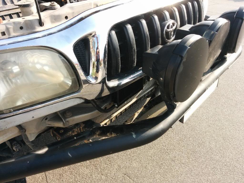

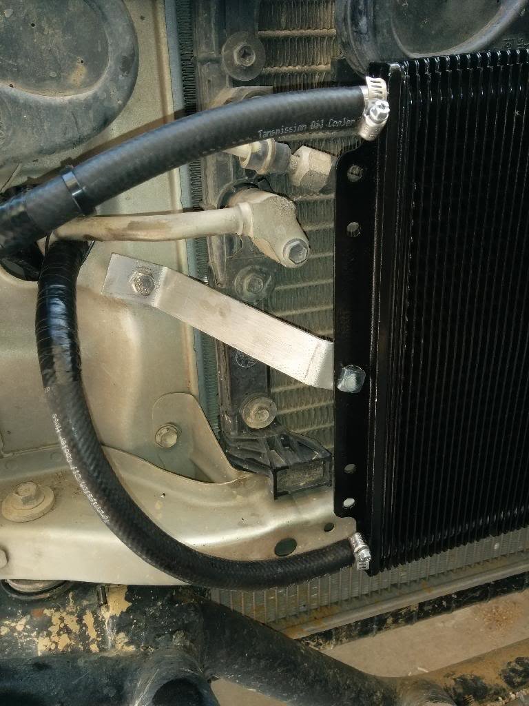

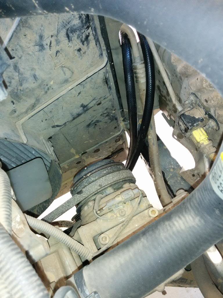

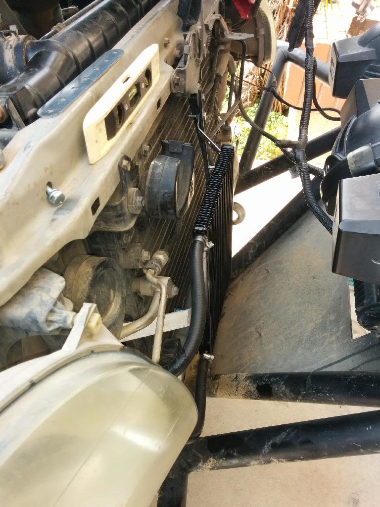

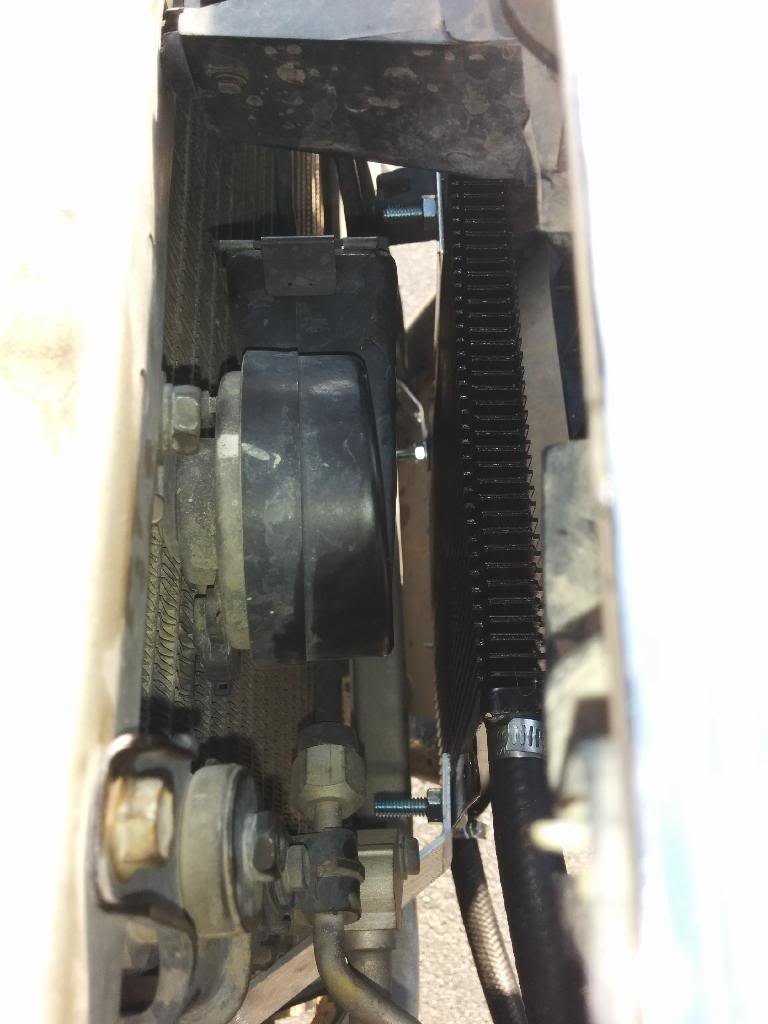

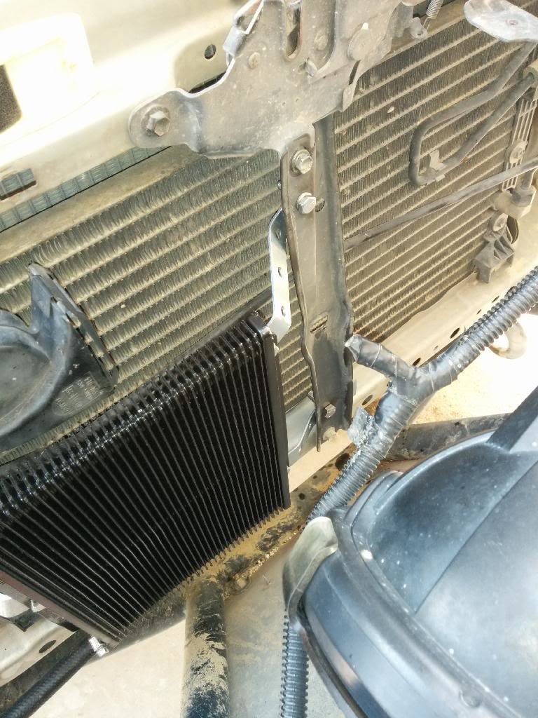

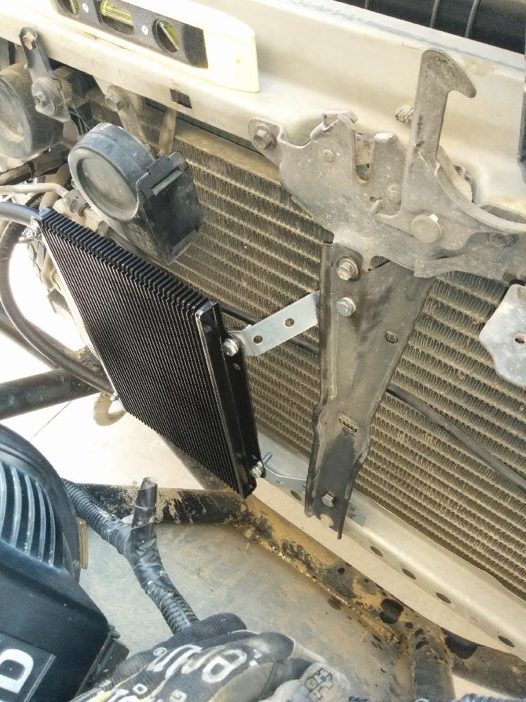

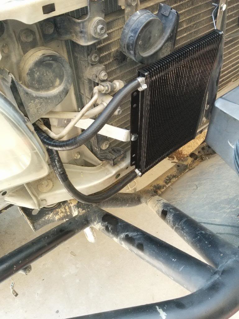

    Here are my installation pictures. BTW, my return line is on the passenger side. To confirm, I removed the passenger side hose from the radiator and ATF came flying out of the radiator. After cleaning up my mess I removed the driver side hose and ATF came out of the hose. I know most Tacomas are on the driver side but my 2001, 2.7, 4 cyl. always tends to always be different.
    Also, I went and bought 8' of ATF 3/8" hose, NOT fuel line that they'll try to sell you. Most mechanics use fuel line and I'm sure it will work but my paranoia took over so I bought ATF hose. I ended up using about 7 feet. The return hose connected to the aux cooler was leaking so I had to tighten the clamp even tighter than I already did, so make sure you get all your clamps nice and tight. The oem squeeze clamps don't work very well because the 3/8" hose is bigger than the oem hose. They don't get very tight.
    Sender hose on top, return on bottom.
    Mounting brackets.
    Only one mount on the passenger side but it's solid since it's mounted near the middle of the cooler. I had to use a long piece of aluminum strip since the brackets that came with the cooler wouldn't reach.
    From the inside coming through the hole.
    Plenty of room for air to get around in there.
    From the outside.

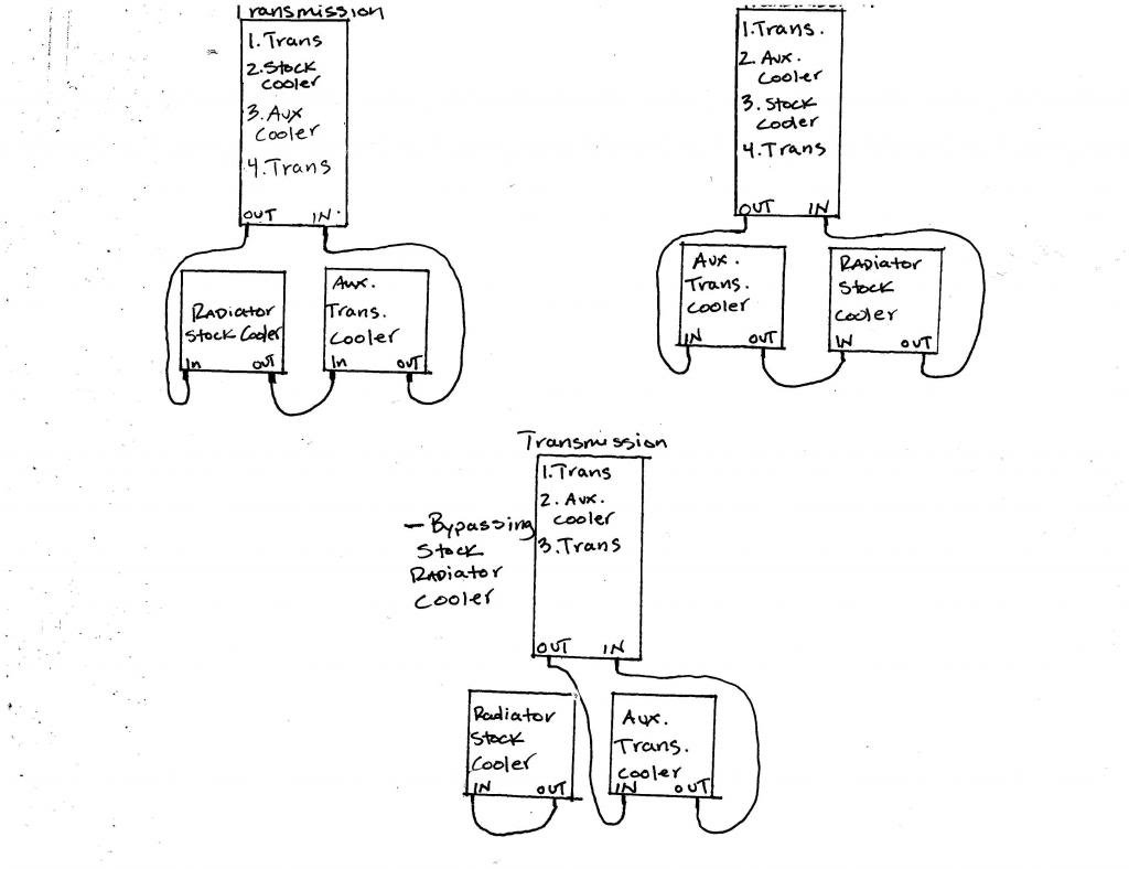

    The radiator has two hoses atf hoses. If you follow those back you'll see the rubber hoses are connected metal tube hoses. One hose is the sender which sends atf to the radiator and the other is the the return hoses which atf flows back to the trans. Once you identify what each hose is you can connect it should be as follows. Stock sender hose will remain in the radiator, then remove the stock return hose that's connected to the radiator and use the new hose which will connect from the radiator to the aux cooler. That hose is pumping atf into the aux cooler. From the other aux cooler connector install another piece of the new hose and run that hose to the return metal tube. Look at my diagram that I drew and look at #1 and it should make sense.
  19. Apr 12, 2014 at 11:14 PM
    #99
    Johnnie
    Johnnie Well-Known Member
    Mar 11, 2009
    #14594
    1,890
    I.E. SoCal
    Feds
    #1-top left
