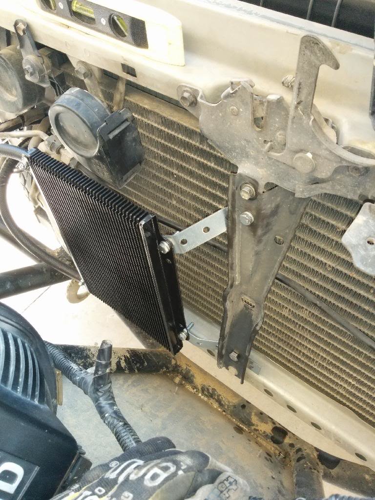

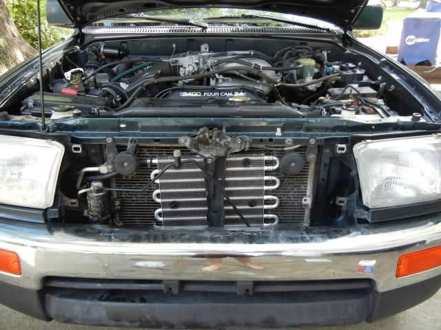

    Was anyone able to mount this on a '98-'00 Tacoma V6 with A/C and stock bumper/grill. I can't figure out how there is room for it. My stock bumper won't let it slide down and the A/C line keeps it too far out for the grill to re-attach. If you succeeded can you link a pic? Thanks.

    The 4454, the smaller one. I checked out the pics you posted here, but my front end doesn't look exactly like that. My horn isn't there on the right, and there's not enough room to have the cooler slide down between the bumper and the A/C line. My truck is a '99. The top portion of it clips on to a metal bracket that limits space.

    i ended up drilling to holes on the center mount and popping it there. n5g6mw_f4a66321ee1f101aaafbba7c0007ec12e1055c6f.jpg
    not my truck, but mounted same place

    Thanks for the links. It looked like the pictures showing the coolers mounted and the bumper still attached were of '01-'04 Tacomas. They look like their bumper design will allow the cooler to fit, but mine won't. Here's my problem:
    The metal bracket under the plastic part of the bumper sits underneath the A/C line. There's not really any space between them. I could take the bumper off to mount the cooler, but then it won't go back on. I may have to wait until I get an Off Road bumper. Here's a shot of my whole front:
    I'll go through the links again and see if I missed something.

    Can you bend your brackets to have the cooler sit out a little further like I did?

    I tried that yesterday, but it didn't seem like the grill would go back on. I'll go mess with it some more and report back.

    No go on sitting it out further. The grill won't re-attach. It w0n't even re-attach with it flush. There also won't be enough room for the hoses to come off it and bend out of the way, again because of the bumper. I guess it's got to go.

    It's a '99. My horn is mounted in the engine compartment. If you scroll down at this link, there's a pic of mine's stylehttp://vehiclevoice.com/2010/10/29/changing_the_face_of_attractiv/
    Everyone in all these threads seems to be an 01-04. But there is no room in mine with my bumper on. Not even from underneath and behind the bumper.

    That's weird because I had one of these installed on my 99 and dont remember having install issues.
