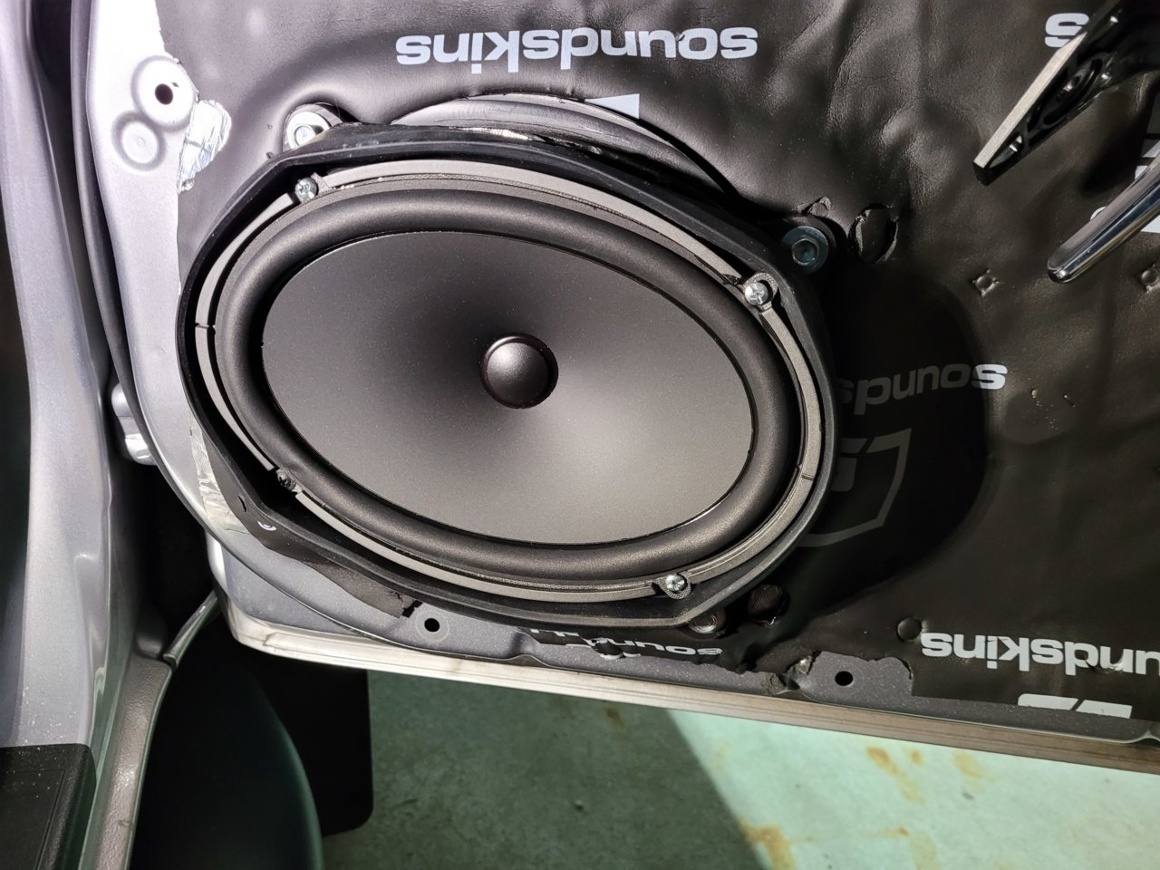

    @CoastieRon Did you have to use an adaptor for them to go in the doors for a better fit? I have a 2010 and i know the OEM is 6x9 but wasnt sure if a brackets helps any?
    Guess i may put these Hertz up for sale since they are new in the box if i go this route with the Morels
    EDIT, i see you used the metra brackets

    Too much.
    I used the Metra, and they work, but I got the TT (them who shouldn't be named?) brackets for a firmer fit.

    ok cool, Good to know. How much power are you running to them currently? Im leaning towards the Audio Control 4.800

    75 a channel. 125 is perfect. They're rated at 130 I believe.

    That’s intense. Nice work!

    I remember your build, very nice. Id love to have that amp rack or measurements

    Thanks I appreciate that! Ron has some serious skills and it’s been great to see more ideas. So many components out there. For those amp racks T Tunes seems like the only thing like it, and it's well thought out. Someone should sell an alternative. Not quite deep enough for larger amps. The design is simple but it does seem to be the best approach. Good clearance and wiring pass under the rack is really helpful. I forgot to check the jumper settings on the crossovers for the tweeter placement. I didn’t read that part until it was too late. So maybe I will remove the seat, I doubt it though, the tweets seemed dialed in.
