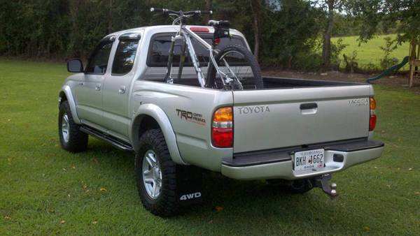

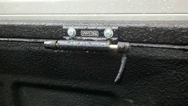

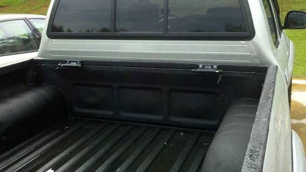

  6. Aug 10, 2012 at 4:13 PM
    HUNT
    HUNT Well-Known Member
    Jul 3, 2010
    #39758
    273
    Tommy
    Wildwood Ga
    2003 Double cab 4x4
    Bilstein 5100 set @ 0, OME 881,Wheelers 5-leaf, OME NitroCharger Sport shocks, 4-RUNNER LIMITED WHEELS, Duratracs, 265/75/16
  7. Aug 10, 2012 at 4:15 PM
    HUNT
    Jul 3, 2010
    #39758
    273
    Tommy
    Wildwood Ga
    2003 Double cab 4x4

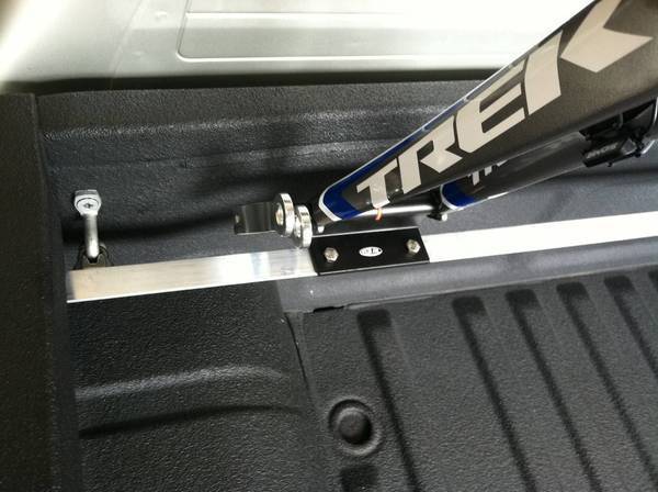

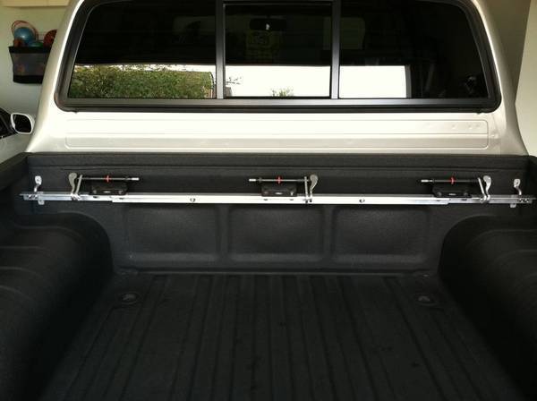

  8. Aug 10, 2012 at 4:28 PM
    Zork
    Zork Well-Known Member
    Aug 6, 2009
    #20739
    335
    CA / KY
    04 PreRunner V6 D-Cab
    Alpine CDA-9885
    Here' mine. All Aluminum/Stainless in total cost me about $60 to build myself.
    as you can see it attaches to the factory D-Ring. So no drilling was done to the bed.
