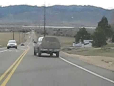

    You had an alignment check since lift? Bounce is one thing but you describe a shake makes me wonder if rear axle shifted. U bolts torqued properly? If truck is "dog legging" down the road it will shake and ride like shit.
    Extreme example
