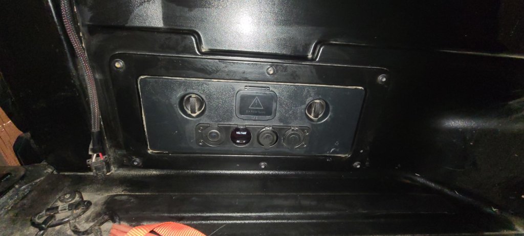

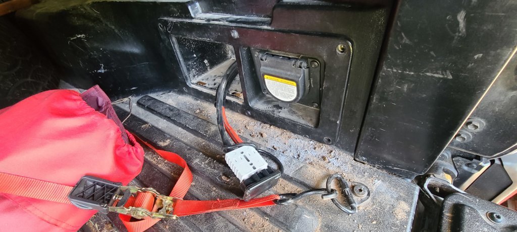

    I went through the bed storage compartment for power for rear winch.

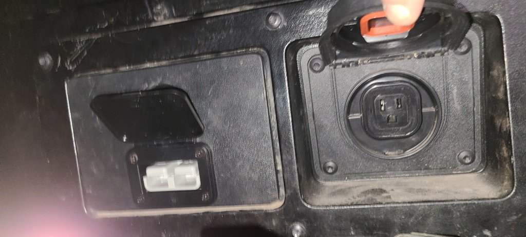

    and this on the other side for compressor and acc.
