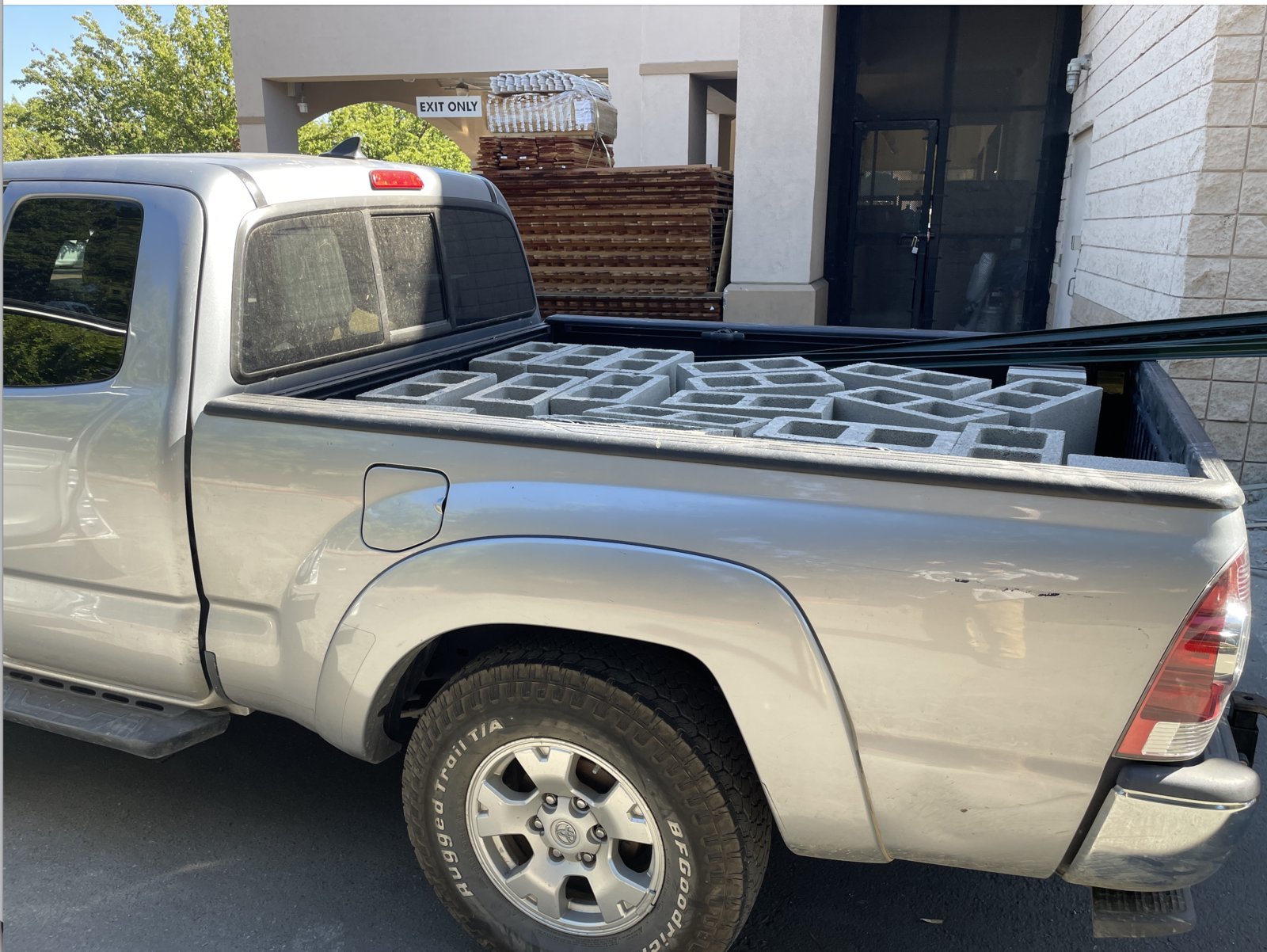

    I've put 38 standard 8x8x16 concrete blocks, at 38 lbs each = 1,368 lbs, in the bed of a stock-suspension 2014 AC TRD OR. It definitely squatted notably, but there was 1.5" of air space between leafs and bump stops, and it wasn't dangerous to drive cautiously. In this photo the blocks are 2 layers deep. Plus another 50-60 lbs of steel T-posts, plus me the driver, etc, brings it closer to 1,600 lbs of cargo.
    EDIT: Blocks are actually 28 lbs each, not 38 lbs, and it was 40 blocks total, = 1,120 lbs + 50 lbs T-stakes + 200 lb driver = 1,370 lbs, which is 18% overloaded past the nameplate "not to exceed" load cap. for the truck, including the driver/passeners, of 1,160 lbs. With that considerable (but not ridiculous) overload it was riding low but not bottomed out on the bump stops. Did not experience any drastic problems with steering or braking, inc'l 55-60mph on the highway.
    Notably, this is an "ideal overload" situation in that the weight is evenly-distributed across entire rear bed, so at least several hundred pounds of load is being shared to the front suspension. It would be problematic to put >1000 lbs of cargo at and behind the rear axle only, as that would take a lot of load off the front tires leading to squirrely, light, and dangerous front steering response, as well as putting lots of cantilever load on the portions of the rear frame rails that hang out behind the axle.

    Yeah, I suppose. Idk what the actual engineering safety margins are on these load ratings.
    In the example I gave above, with actual numbers on a real trip, I was 37% overloaded past driver's-door name-plate cargo capacity, and the vehicle was still very driveable and didn't (to my knowledge) experience any permanent damage, i.e. bent frame etc.
    In the Ford Dually example you give, hard to judge without knowing the total picture, i.e. was the load concentrated on the rear 1/3rd of the bed behind the axle? Was there appreciable frame rust? And especially -- was that vehicle routinely overloaded, perhaps 100s of times, leading to failure through fatigue cycling?

    Whoops, stop presses -- major error on my part which I have to own here. My calculations were based on googling the weight of an 8x8x16 concrete hollow block. Google said 38 lbs per block.
    BUT -- I actually weighed one of these blocks on a scale, and made notes about it, at the time I carried the load pictured. Just reviewed those note. The ACTUAL weight is only 28 lbs per block.
    So that means the actual weight of the load as-pictured is 40 blocks (not 38) x 28 lbs = 1,120 lbs, +50 lbs T posts + 200 lbs driver = 1,370 lbs.
    Which makes more sense when you compare that number with the amt of visible squat on the springs. At 1650 lbs it would've probably be bottomed out completely.
