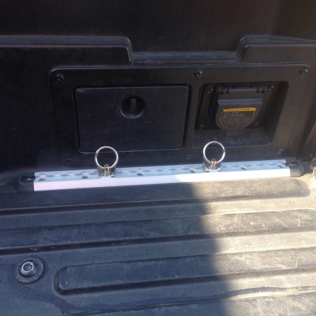

    I just recently installed L-track on the bed up against the cab. This part of the bed is a composite material. Is the bed "floor" also made of the same type material?
    Planning to put L-track on it also.

    I had not even thought about it until I started drilling the holes. I knew the front part was different just didn't know about the bottom.
    On the front part I used expanding nuts to mount the L-track since I couldn't get between the bed and cab. I guess I'll do the same on the bed floor. I'm using it more to keep stuff from shifting than anything else anyway. Not trying to use it to tie down a quad or anything like that.

    Thanks for the heads up! I will certainly keep that in mind. Near the Cab I put in 2 12" pieces and it seemed to work out nicely. It's nice that they fit inside the ribs and not stick up. I attached a rotopax plate to it to hold a 4 gal can. I ordered two 4 ft sections that I plan to bed on the bed floor.

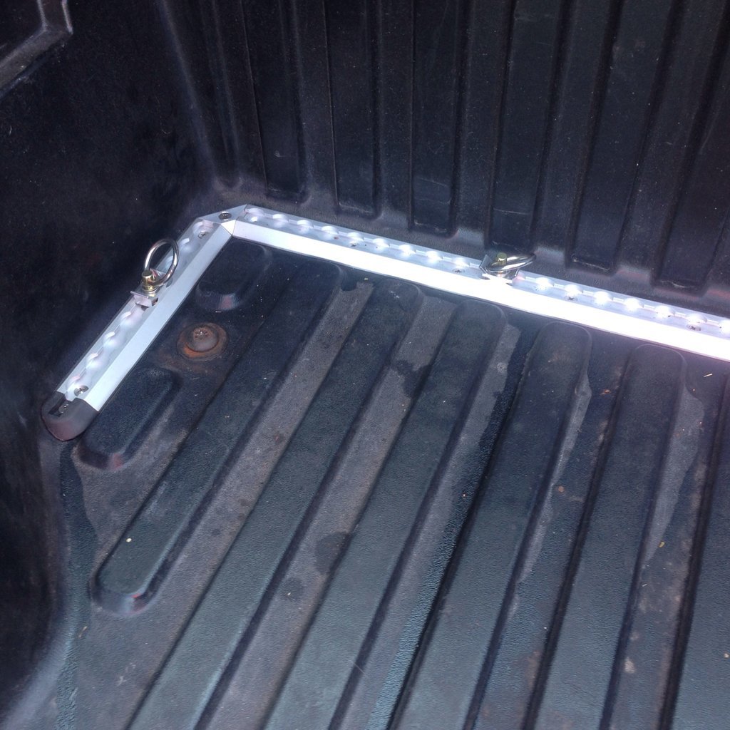

    I put extra thick fender washers on the back side with nylock nuts. Yes, it's a pain to dodge the reinforcing ribs.

    I like the connectors you used. I haven't seen those before. I did find the end caps.
    The track I put down is black. It blends right in with the bed. Hard to tell it's even there.

    #216500
    7,489
    I made that corner piece. In hindsight, I wish I would have cut the track ends at 45 degrees and butted them together. I have a bandsaw that will cut angles. Oh well, I made it work.

    272
    It looks good!
    I want to run a couple on the edge near the tailgate like you did. But I'll run 2 straight up closer to the center.

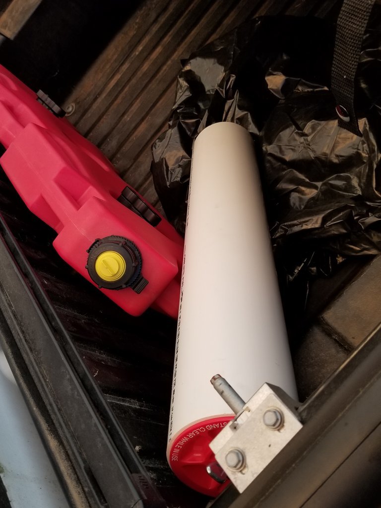

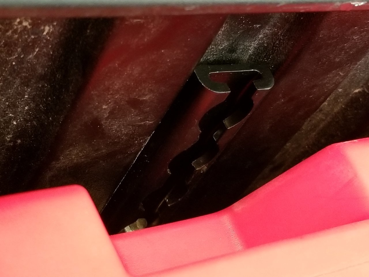

    This is a closeup of it behind my rotopax mount. I have a 4 gal rotopax cel attached to it. The tube is part of another project. something I found on the honda foreman atv forum. I just need to find a way to be able to attach it.20170720_2007023.jpg 20170720_2008201.jpg
