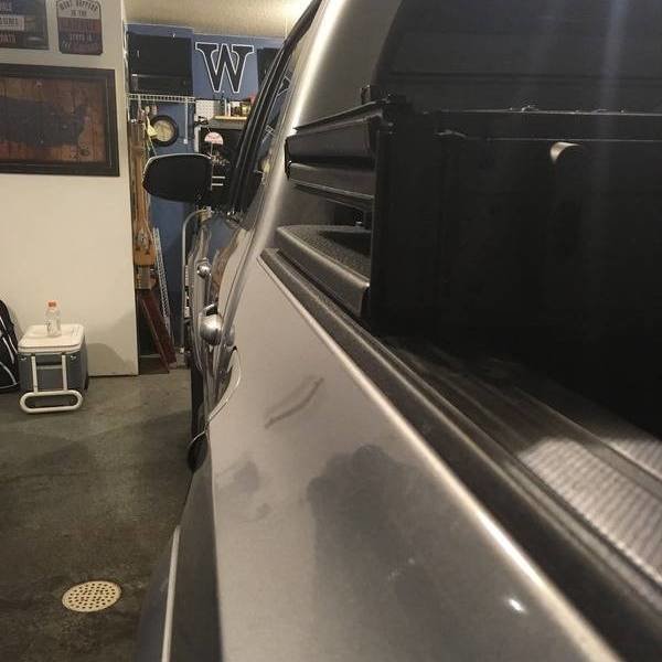

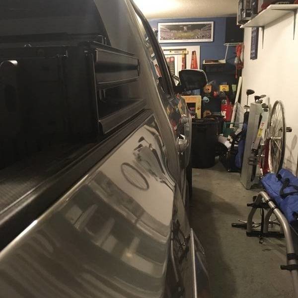

    I apologize for using an older post, but I'd rather do this than start a new one of the same exact topic.
    I'm dealing with this on my 2017 Sport DCSB, the bed was shifted to the driver side and very noticeable. At my 20k maintenance appointment, I had the dealership fix this. They gave be a loaner car overnight. I opted for them to fix it since the truck is still under warranty but of course it's still not perfect after they had my truck for over 24 hours (should've expected this). The bed is still about 1/2" to the driver side; meanwhile I went to look at other trucks on the lot, most of them perfectly centered, some of them also shifted a little bit. Did some research with my service guy and all of the Tacomas they've done this bed adjustment for have come from the Baja, CA factory.
    Anyway, the main reason I am posting on here is because I want to now try this myself because I don't feel like having the dealership try again is going to do any good. Is it just the 6 bolts in the bed itself that need to be loosened and then the bed can freely shift? Or are there other bolts that must be loosened underneath? Also would you guys say this is a 1-man or 2-man job? Thank you.

    Tyler, I did this by loosening the six bolts, but you aren't able to move the bed that much. For me, it did not make the noticeable difference I was looking for.
    At this point, I have to agree with what member MagicMexican said in his post above..."Maybe your bed is fine and your cab has shifted. Look at the body mounts and see if any on that side are worn/falling apart. If you shift your bed to compensate, then you are only fixing a symptom, not the problem. Like fixing 'taco lean' with a spacer on the coil spring. I haven't experience it myself, but from what I've read, it's usually body mounts that cause it..."
    Replacing the cab mounts are on my short list (Tacoma Honey Do list). I'm just waiting for cooler weather.
