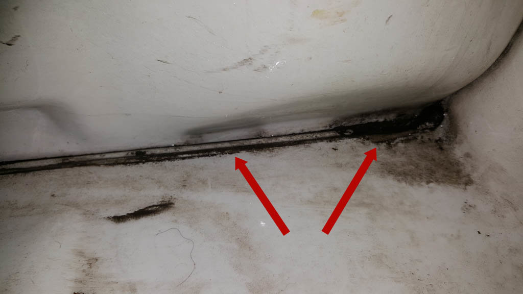

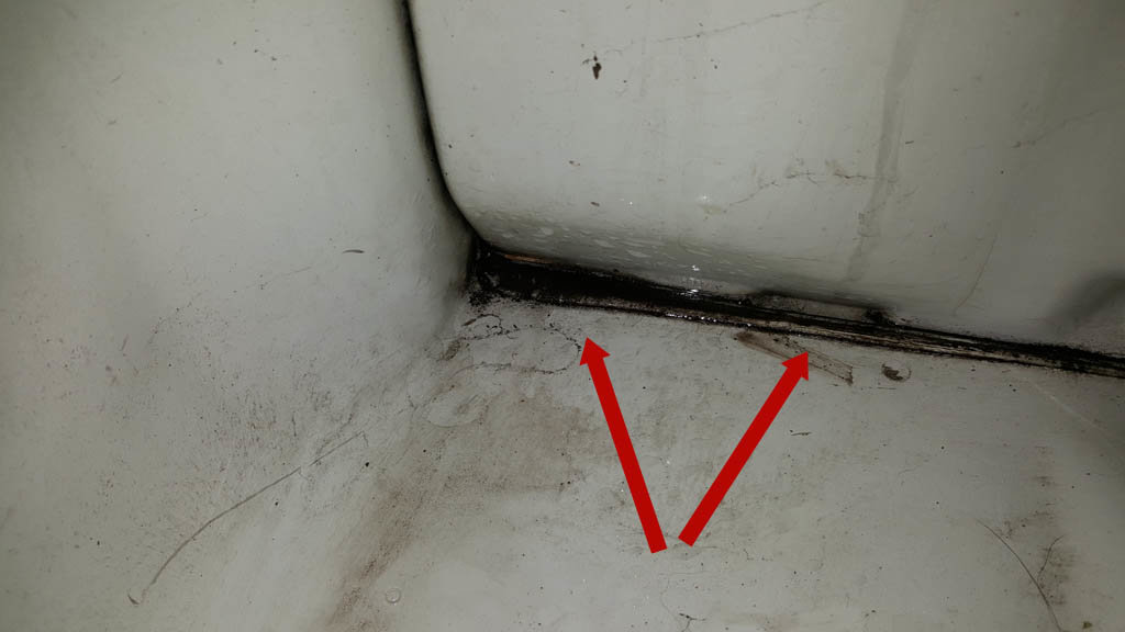

    I just noticed my bed (95 ext cab 4x4) has draining slots between the front wall and the bottom. No plugs. Slots are about 3/8 by 1 inch easy clogged with dirty stuff (sticks, leafs or even christmas tree needles). There are total four of them.

    I have two, as well. They clog easy. I unclog them with a feeler gauge.

    I mean two on each side. Unless the one in the corner is a "nature hole" :).
    Driver side
    Pass side:
    Actually both corner are still working that is why they are so dirty ;) It's raining now and my camper has a bad leak at the front corners (faulty seal between the bed and shell) so the bed is wet but empty.

    The corners of my bed don't go through. I can stick a skinny screwdriver in the "inboard" ones from the bottom though.

    I take it back. My is not special. Only two drains. :smack: After I cleaned both corners I saw that the "outer" drain is just a dip and the water from there is flowing into the inboard hole and it is flowing down from there.
    I am sorry if I mislead anyone. :sorry:
