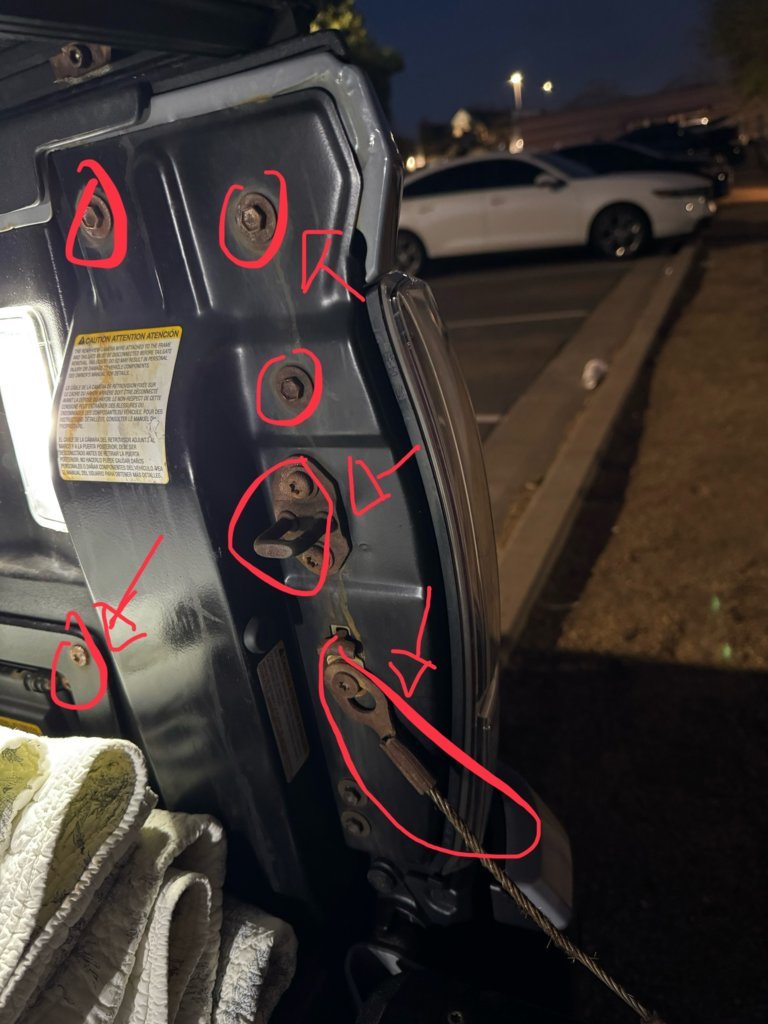

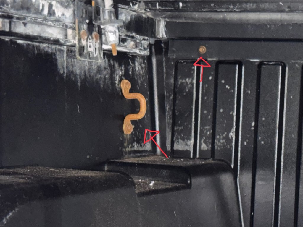

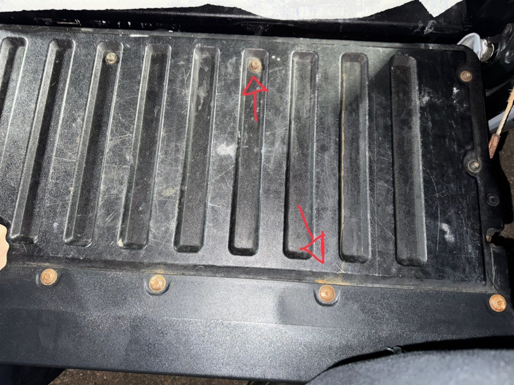

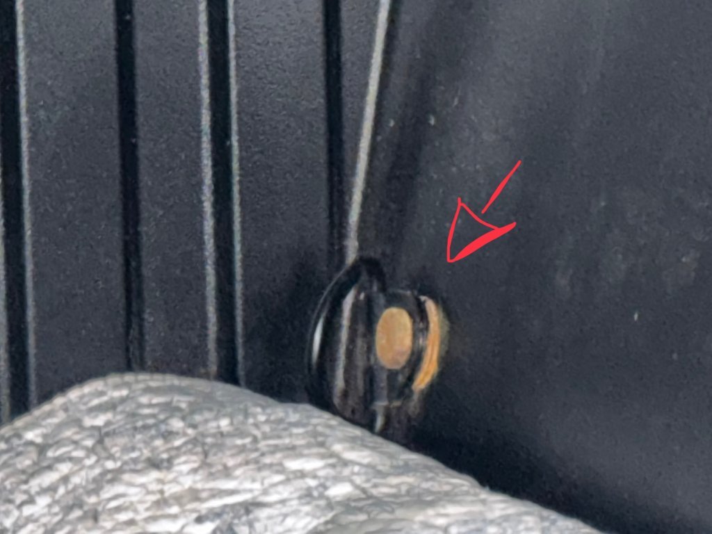

    As the title describes I am trying to obtain part numbers and or any place to get hardware that has rusted in the truck bed due to it being an eye sore. If someone has the parts numbers or can point me in the right direction it will be greatly appreciated.

    You need more images of the same parts..:thumbsup:

    So, have to ask, how did the hardware get that bad? You live near an ocean? And if the visible hardware is that bad, what does the hidden hardware look like…?

    either pull them out and get some measurements and order off mcmaster or head up to the local Ace for some stainless.
    cheap option is get some ospho and a paint brush....

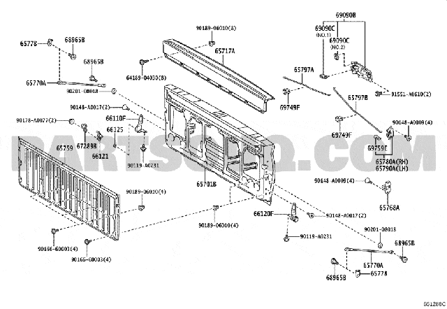

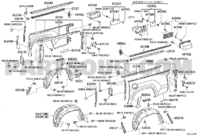

    A lot of diagrams are available online with part numbers.

    @TomYotaNH Live in Arizona. It’s a friends truck he inspected it and no signs of rust underneath in the frame and areas. But even I was questioning how it got that bad especially in Arizona

    I just pulled the tailgate plate hardware and dipped in Naval Jelly, washed, dipped in phosphoric acid, let dry, wiped down and painted with Rustoleum. That hardware is all special made, so salvage is the easy way.
    My bed rail hardware was all replaced with stainless.
    Currently refreshing the 6 bed bolts.
    OTOH, mine was more preventative in nature and corrosion was based on 'wear and tear' (things in and out of the bed) as well as hauling kayaks out of salt water. But nothing like you pictured.
    I'm not buying the 'rust free underneath' bit.

    Looks like that truck was a flooded, salvage title? THose parts are generally not rust points. Don’t buy it that’s normal rust

    @Greg-tacoma thats what I was thinking. I surprised how rusted those bolts where, I was trying to figure out how they go like that but only thing I can think off was it being in a flood.
