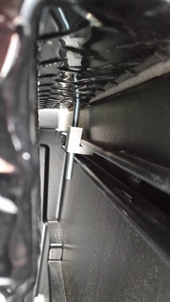

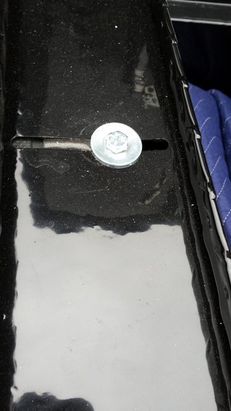

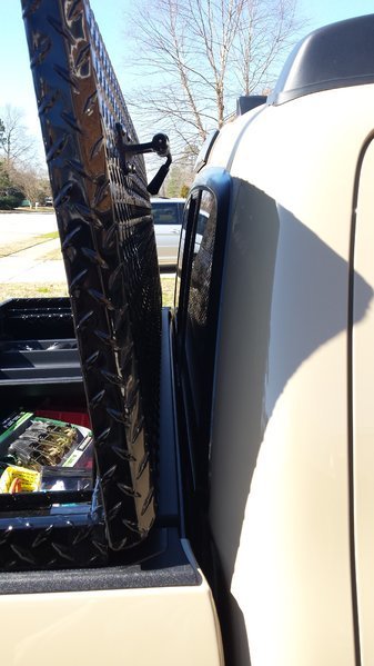

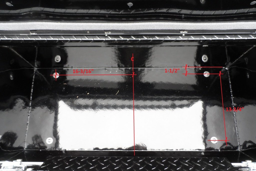

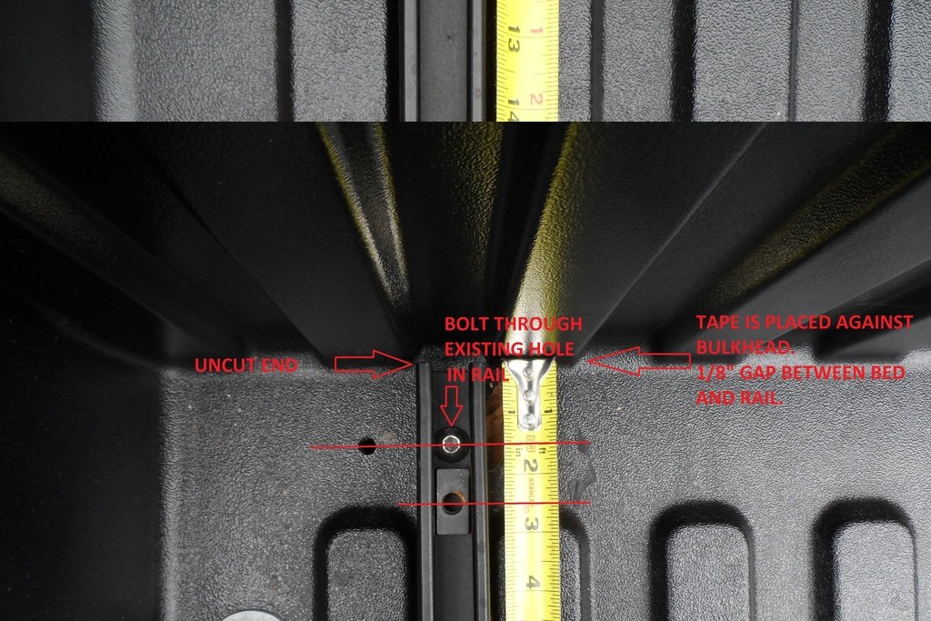

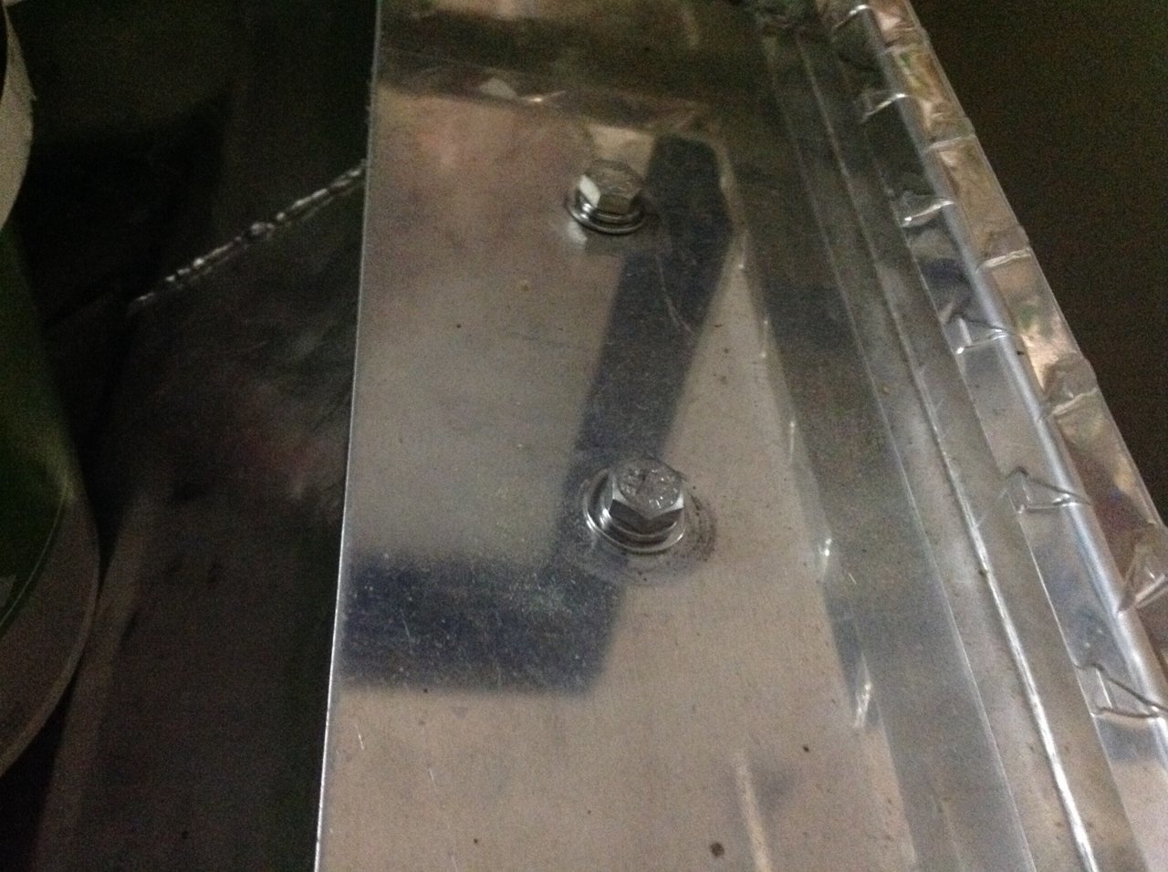

    UWS-TBC-42-W-BK
    Mounted on bed rail.

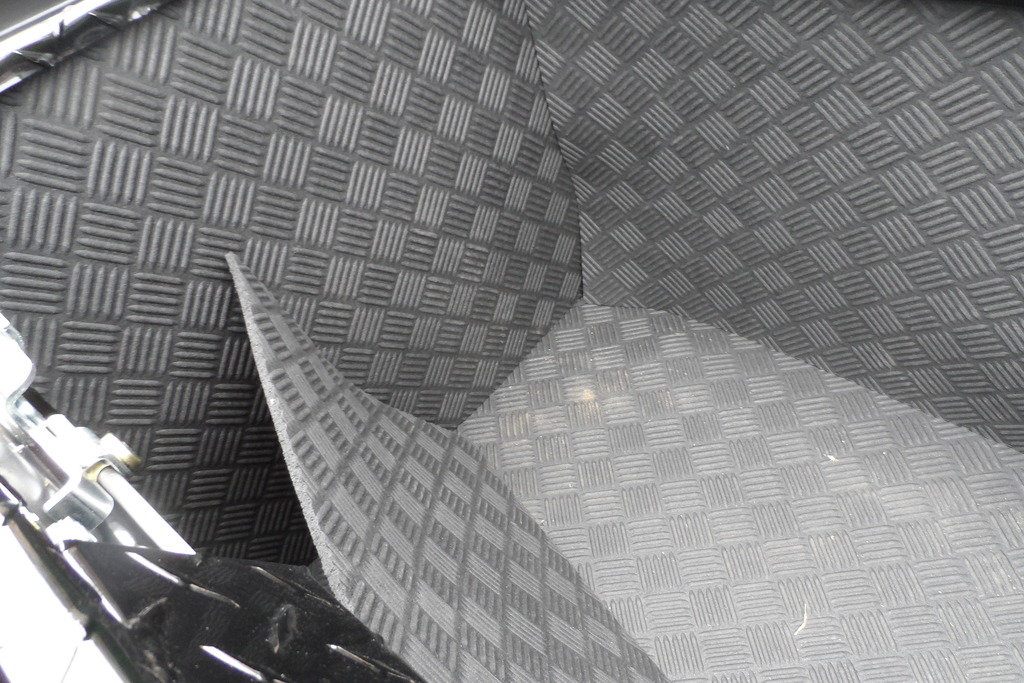

    This is some door mat material I cut up to keep down on noise.
    stainless 3/8" hardware and neoprene washers used throughout

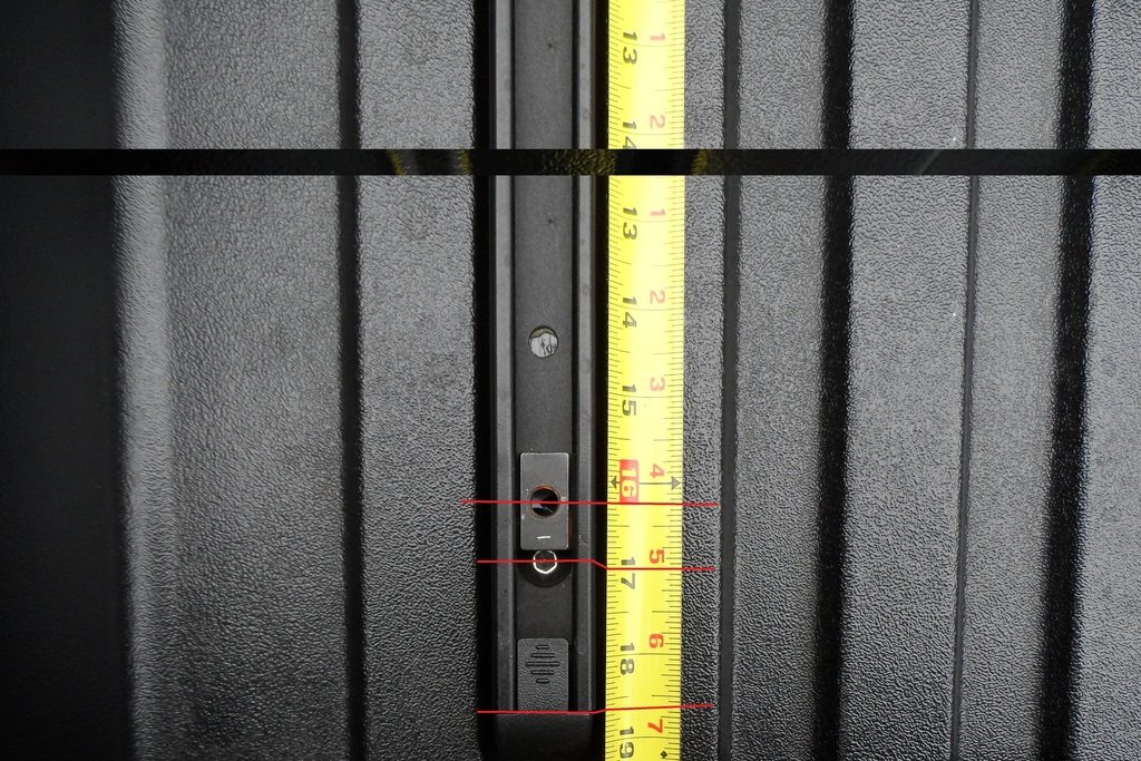

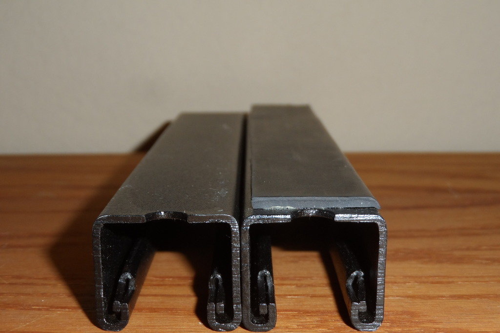

    Install t-nuts in rail before bed bolts; t-nuts are too tall to clear by sliding over.
    Bed rail sections are 18-1/2"
    -the bed rail is just a hair too wide to sit flat in the valleys
    -I cut and glued some vinyl wall trim material so it would clear

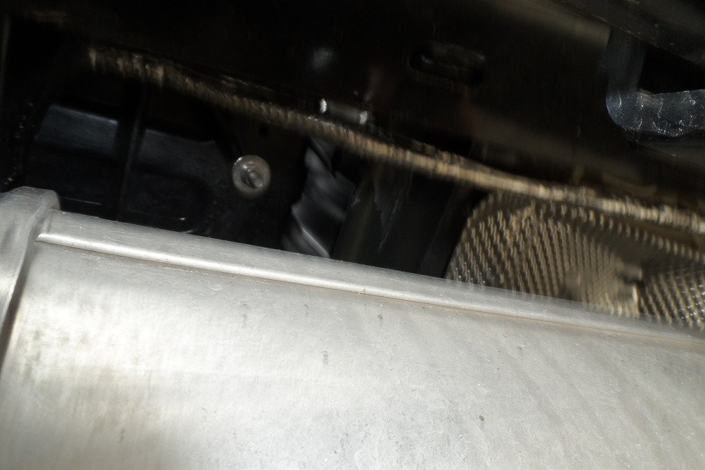

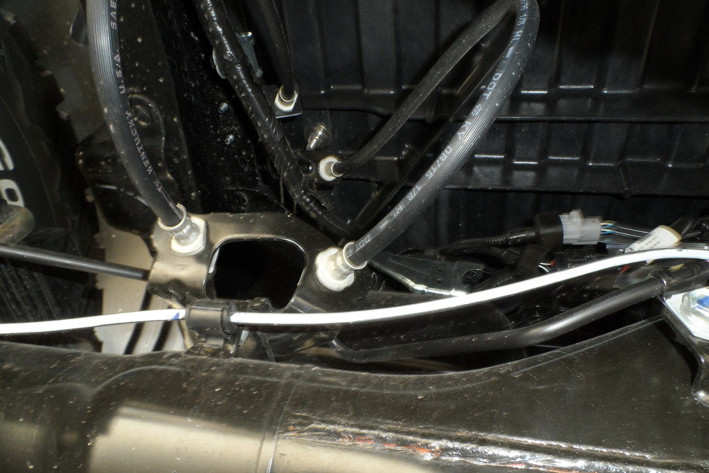

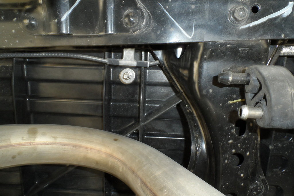

    driver-side front(above gas tank; be careful)
    -this was a pain to get to; I used electrical tape to hold my hardware together while I threaded it on 'blind'

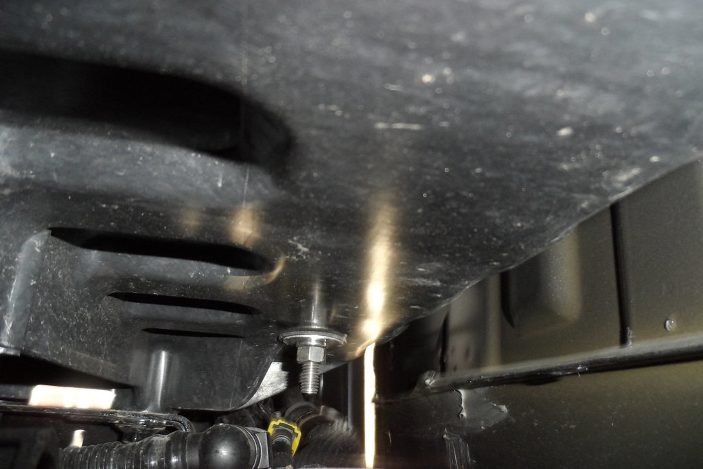

    driver-side rear
    passenger-side front
    passenger-side rear

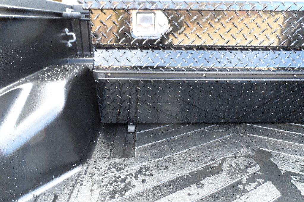

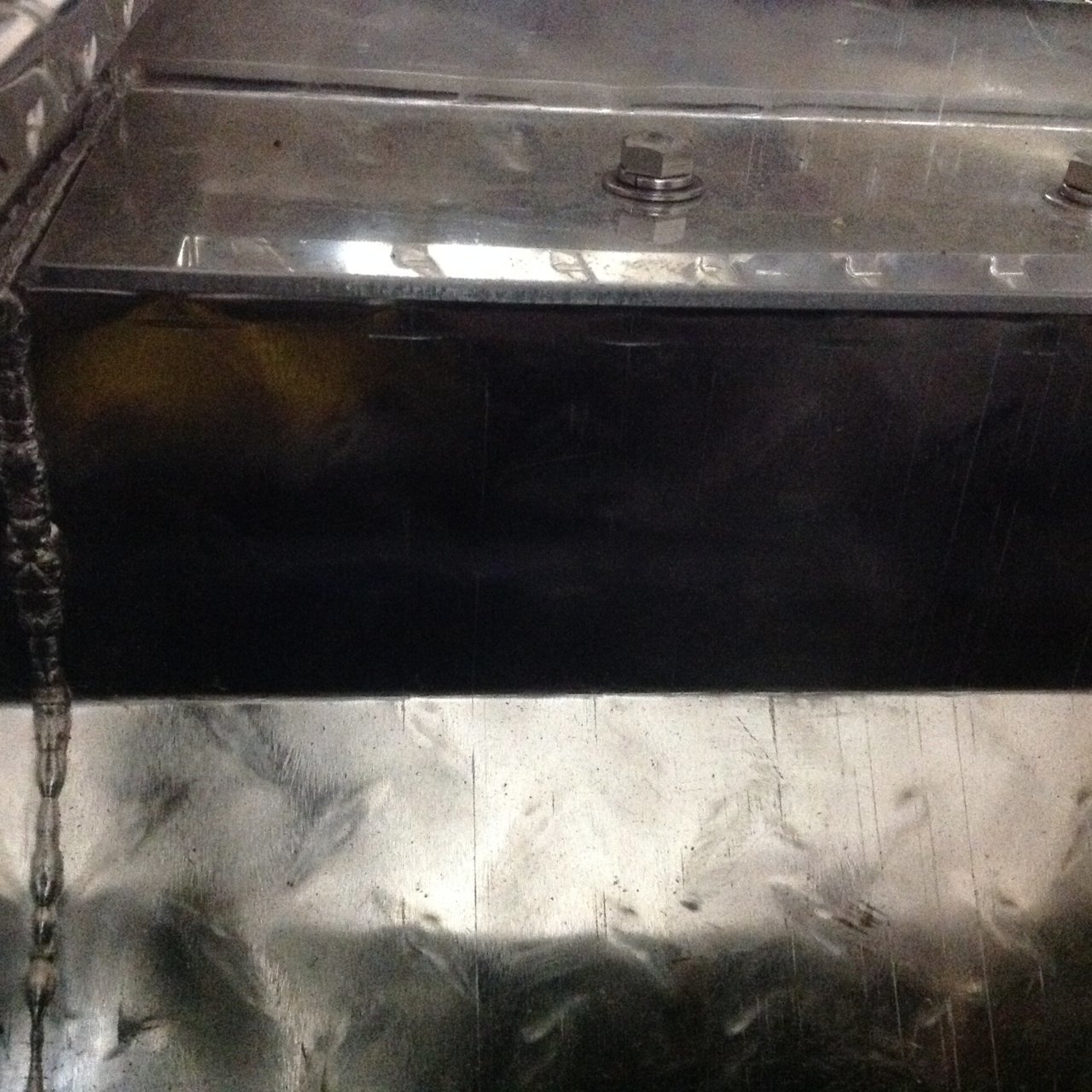

    Went with this...
    Pardon the poor quality pictures. I was looking for just a little more storage space but also didn't want to give up any space in the bed. This is working well for me. It's the only one I could find that spanned the whole distance and stayed below the wheel wells. My only complaint is that the top and sides are tapered, which was not illustrated on the spec sheet. To mount it, I drilled two holes through the bottom and placed the bed bolts through those holes with some spacers between the box and the bed. I did have to cut the washers off of the bed bolts.
    Torque'd em back down to 60 ft lbs, if anyone needs the spec.

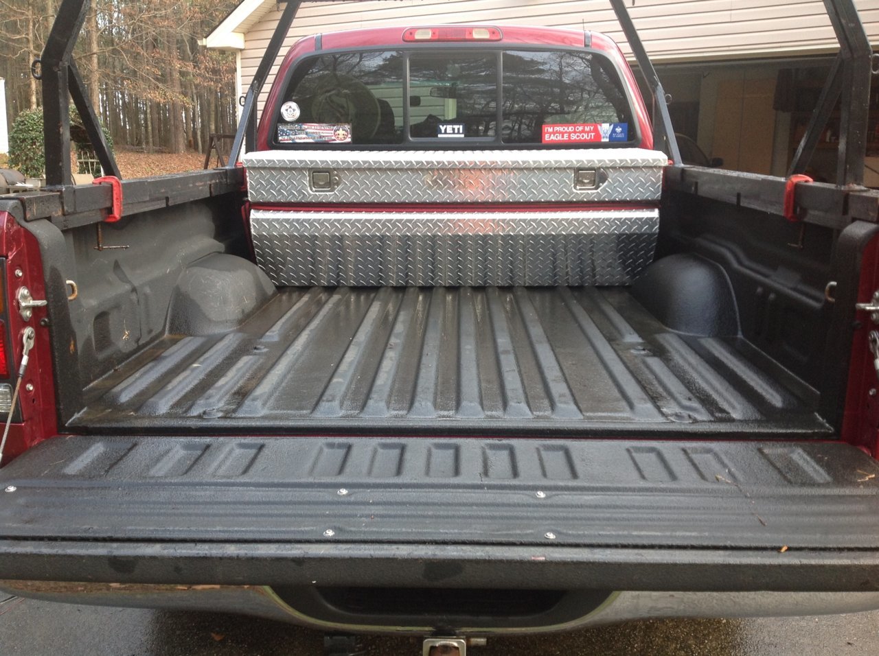

    Nice install. If you don't want to bolt it down you could do what I had in my tundra. Made a cable lock that went to the tie downs in the bed and then put a ratchet strap to keep it tight. Easy to take out when needed. The cable is under the strap. It never moved the 16 years it was back there.image.jpg

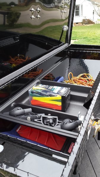

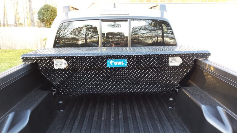

    I've been happy with my UWS boxes, have them in both of my trucks.

    About 4 inches, I also have a bedmat under the toolbox too but it's not in the pic.
    I can slide 4x4s under the box in the bed.

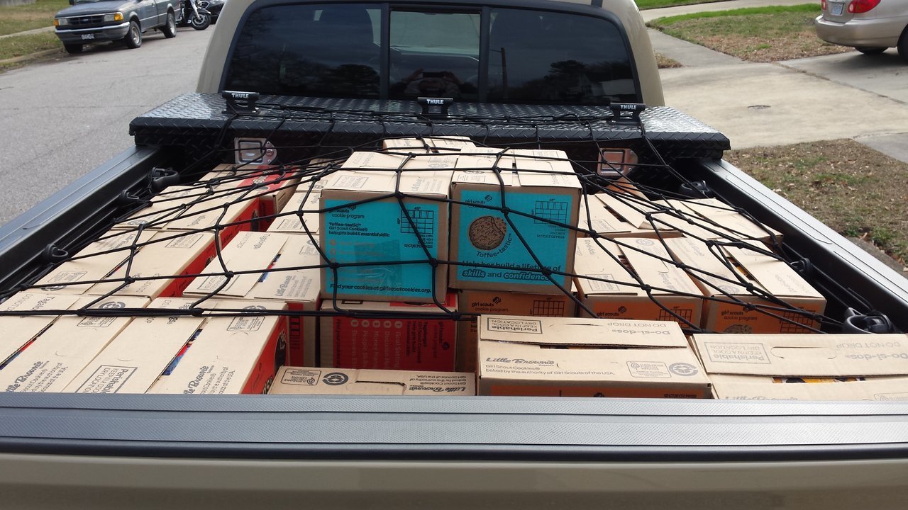

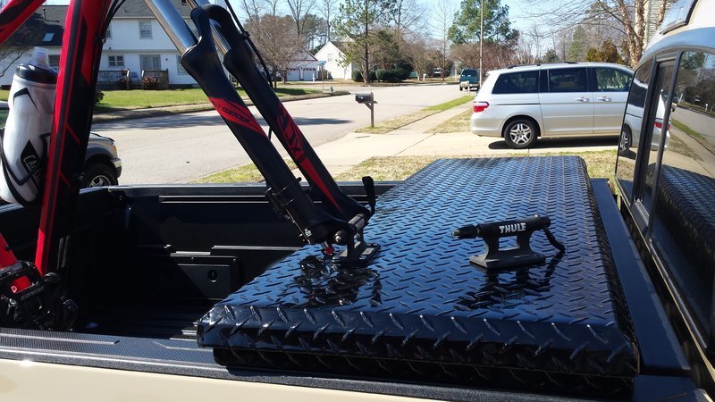

    Mine also doubles as a bike rack.
    20160228_132746.jpg 20160312_114117.jpg 20160724_094535.jpg 20170329_173616.jpg 20170329_173606.jpg
    The bike brackets also make good anchors for my cargo net.

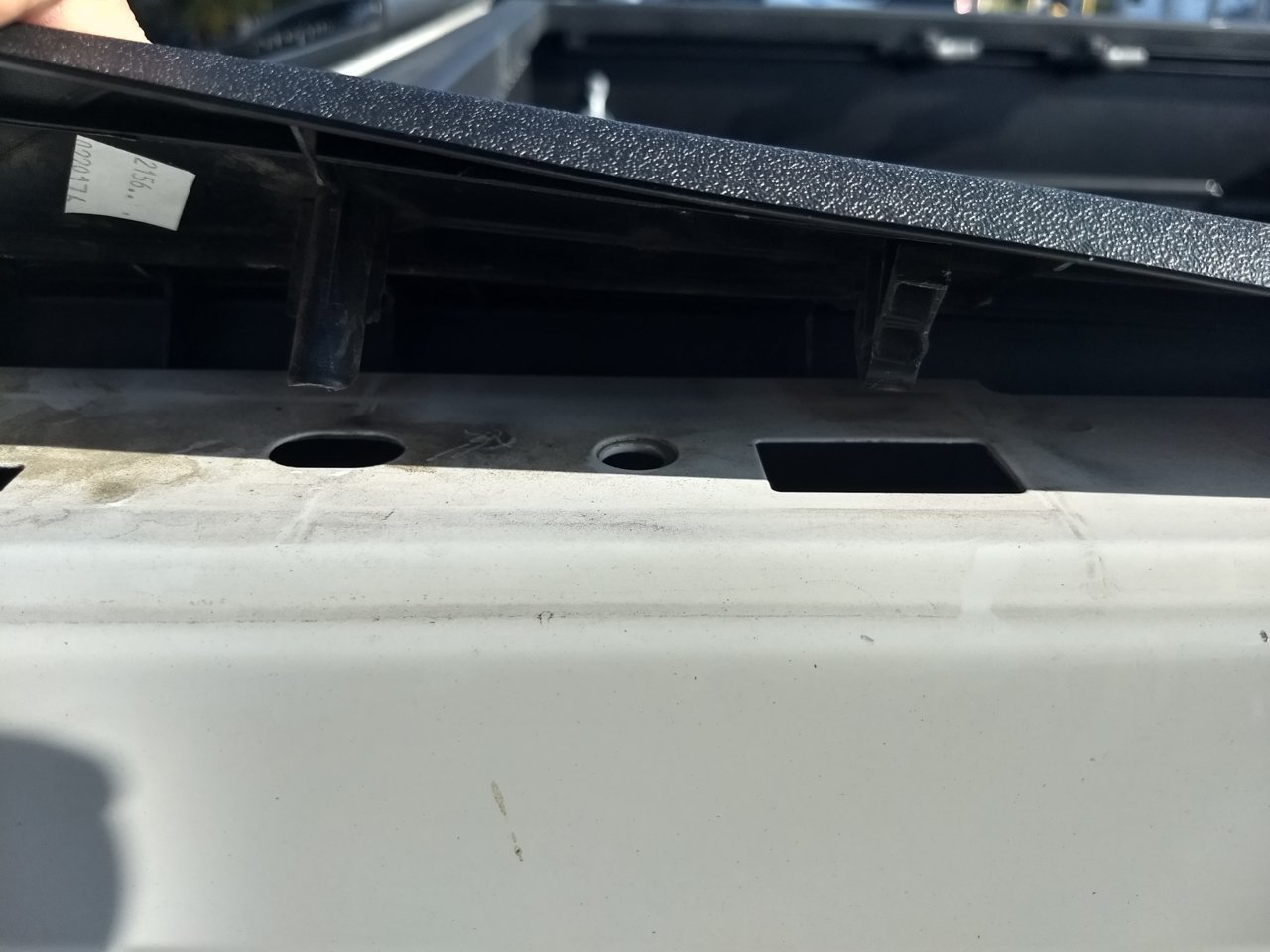

    I got a 2016 tacoma and im totally new to mounting tool boxes to the cab. I was looking at the holes under the plastic rail cap, is that an option to mount the tool box with nuts and bolts or using one of those butterfly's that it expands and I can tighten? I was thinking all you have to do is drill the plastic.
    I was hoping to get the kobalt mid size truck box (black) that is around 249.
