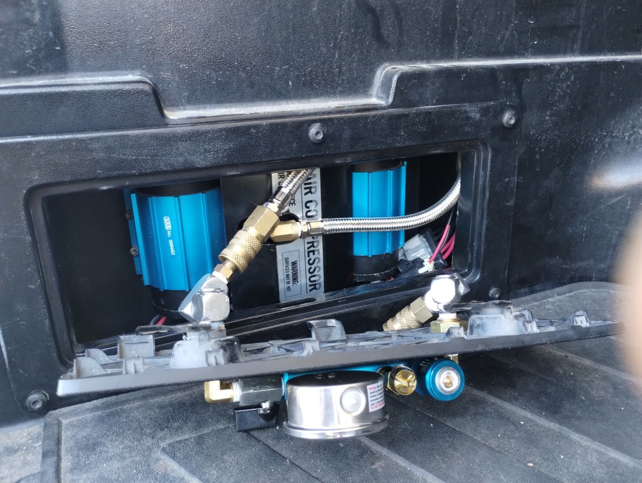

    3. ARB Twin Air Compressor (or any other compressor you can fit in the bed cubby)
    You can probably already guess where this is going. The ARB twin is mounted in the BCM and powered by the extension harness. Then the Rago mounts are used to run air hose to the wheel wells. I opted for 3/8 ID hose with 1/4" NPT fittings to increase air flow. The end mounts also use universal coupler parts so I can attach a longer air hose at the wheel well if I need to reach another vehicle. These are then capped with dust protectors (https://www.amazon.com/gp/product/B00DE8V4G4) to keep the parts from seizing. Front passenger wheel well:

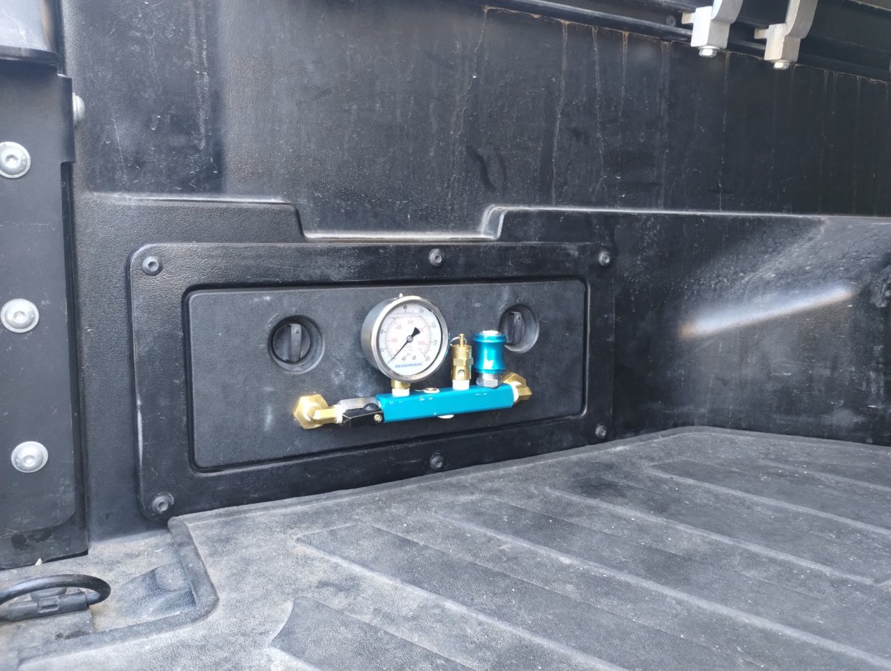

    As if that wasn't lazy enough, I've also build a control manifold to help with filling. This requires cutting the bed cubby door, but if you've already installed the compressor mount you will have done plenty of chopping already. These are the parts you see below:
    Then behind the door, a few 360 degree swivels ensure that the air hoses don't hit the compressor, and air couplers let me detach the cubby door fully.
    From here, the process for inflating or deflating tires becomes very simple:
    1. Connect all hoses
    2. If deflating, simply open both valves until you hit the desired pressure. 3/8 ID hose makes this very quick
    3. If inflating, open the second valve only and turn on the compressor
    4. Disconnect all hoses
    5. You get the benefit of not having to open the hood or crouch by each tire, so less back pain and fewer people stopping to see if you need help!
    This was a really fun project and I've gotten a few positive comments before, so it's good to finally share this work. Let me know if you have any questions or comments!

    Nice work. Any concerns about that manifold getting knocked around by crap in the bed?

    Somewhat, but the mounting is super solid. Only the door will flex when it’s closed. If anything would break it would be the glass on the gauge or one of the ball valve handles

    @RedZeppelin Do all of the tires fill up to the exact same PSI? I'd assume this is the case if because the system is and not closed to each individual tire. SLICK setup. I've now decided to run my single ARB in the rear.
