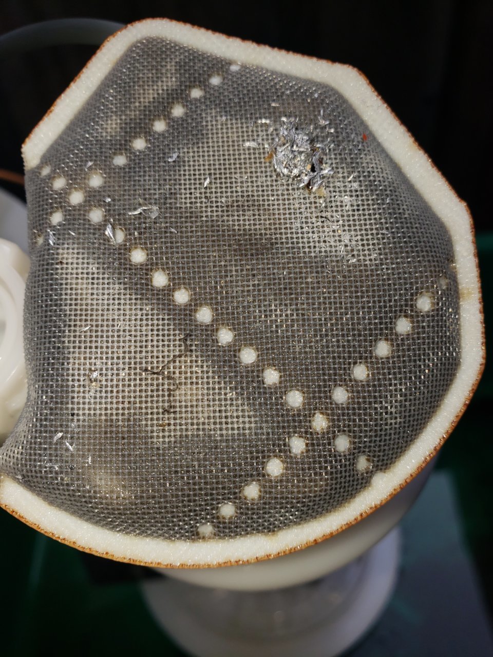

    Mine had similar symptoms, ended up being fuel pump/ filter. 20181117_131108.jpg

    A couple ways you can verify it's the fuel pump and/ or a restriction to fuel flow: if you have access to a fancy scan tool that will show live data, look at the graph for your oxygen sensor data, both upstream (O2SB1S1 and O2SB2S1) and downstream (O2SB1S2 and O2SB2S2) data will show the mixture going lean when you open the throttle. Alternate method, attach a fuel pressure gauge to the fuel rail, and you will see a significant drop in fuel pressure when you open the throttle. Hope this helps!
