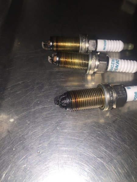

    So, oil was found on the spark plugs.
    A toyota field manager came out to inspect my car and said to pull the engine out and check the piston rings.
    Another 10-14 days they expect once it's all said and done. So I picked up a loaner car from enterprise which I'm worried about.
    God I'm so tired of all this!

    ... ^^^ ... those are some really fouled plugs.
    Toyota sold give you a rental vehicle until your 2016 fixed ... correct ??

    That one plug is nasty. Did they do a compression test? I would imagine they would before before pulling an engine, but who knows. I would be curious to know the results/ percentage difference between cylinders. Keep us updated.
