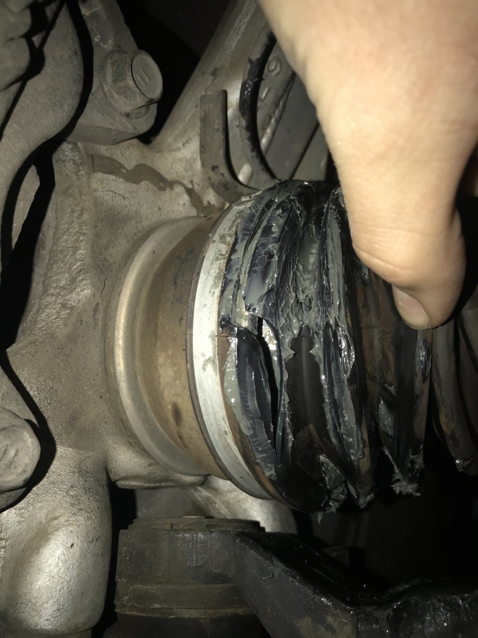

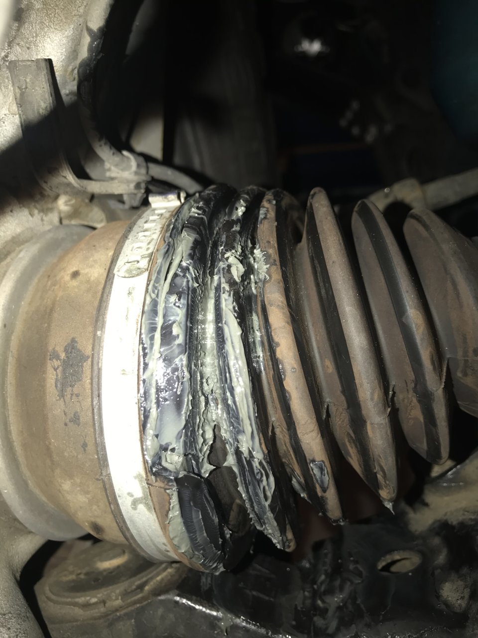

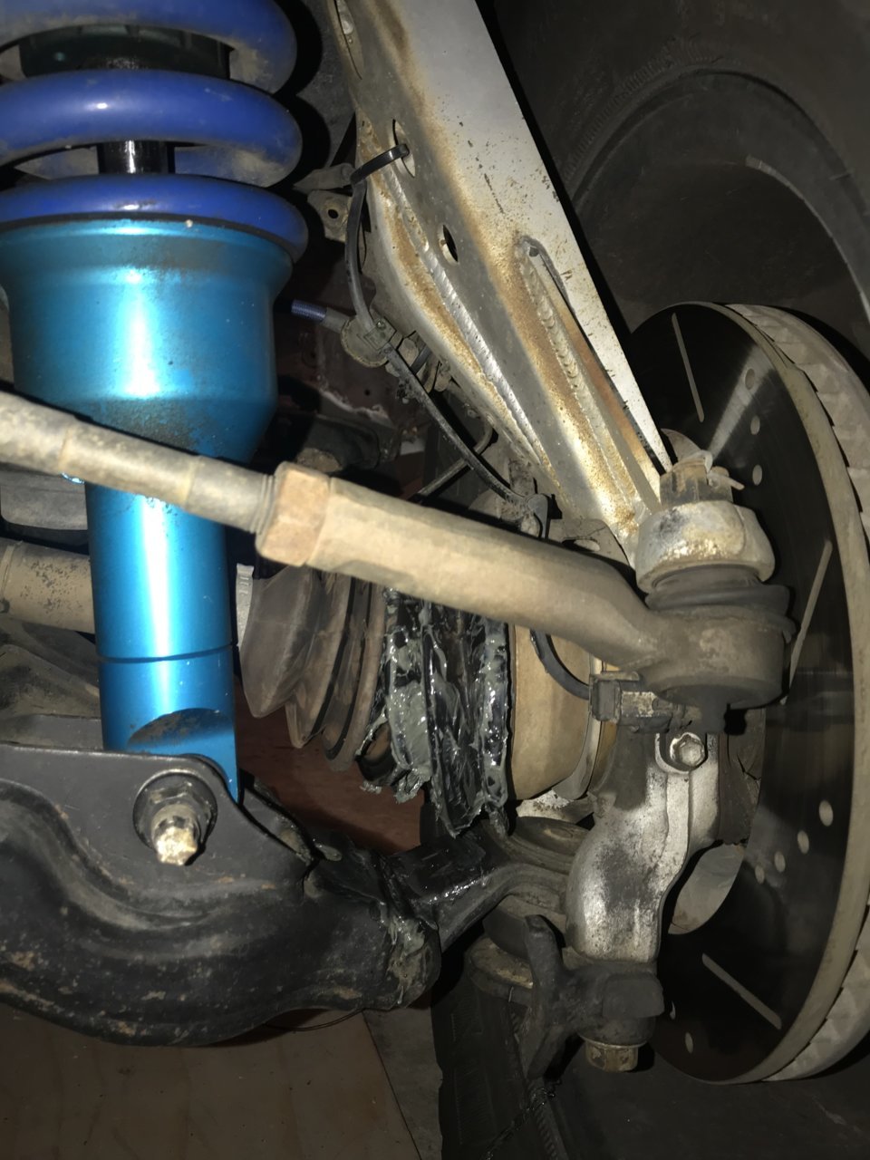

    Truck broke down last night and I told the driver I think it’s out of gas (had just under 1/4 tank) he said nope and wouldn’t put gas in it. The driver is contracted from AAA. Driver drops the truck at my house and today I add gasoline and what do you know, vehicle starts. I drive maybe 2 miles to gas station and fill it up. Get home and realize the driver’s hooks ruined BOTH my outer cv boots!!
    Anyone gone through a claims process before?

    They hooked around your CV? WTF.... I'm sure your gonna get a reply or two about just getting gas, but I'd be on the phone with AAA regarding the damage... sucks...

    He either hooked up to my cv axles or used giant hooks on the LCA.

    I hope so too. I have pictures of my front suspension 5 days ago and there is no grease. I witnessed the driver use giant hooks to the LCA. I have driven 2 miles since they dropped the truck off.
    It is dead obvious it was the driver lol

    Call 3a and file a claim. Driver used j-hooks, should've used s-hooks to the frame.

    Tow hooks aren't rated for that kind of towing. Think of them as transport tie downs.

    The driver could've used sport j-hooks, not as wide of a throat on the hook. Or just used the proper equipment for the job. I've got 22 years as a 3a driver..

    Driver was lazy..theres slots in the frame that are reinforced for towing. They take a different type of hook.
