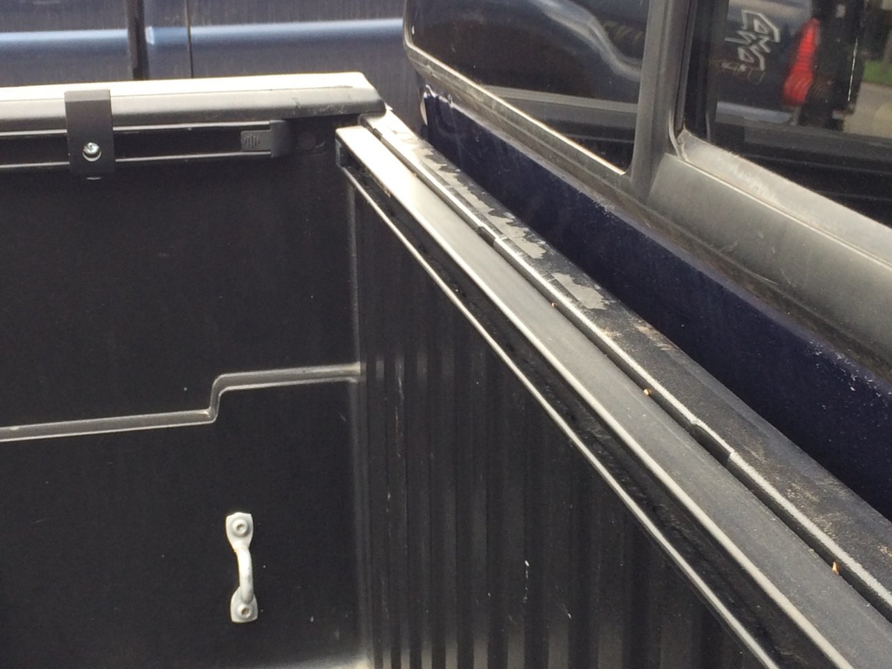

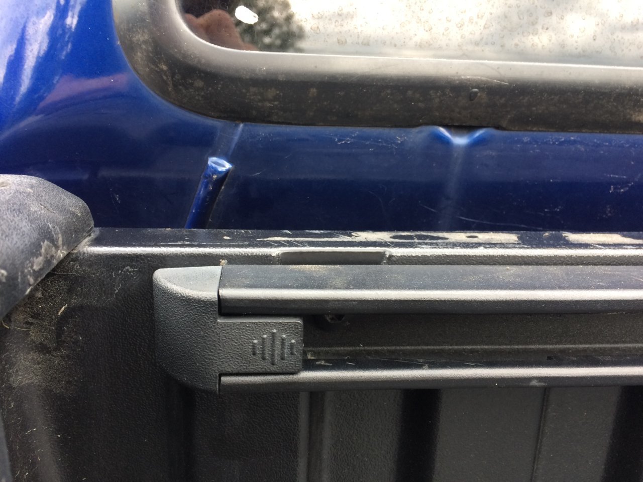

    Wondering if someone can help with a camper shell sealing issue
    I have a 2015 Tacoma with box side rail caps. At the front of the box, beneath the rear slider there is no rail cap, but rather a drop down of about 1/2 an inch that runs from one side of the truck rail cap to the other(see pic) 25D16529-9116-467A-9C0D-81A6905E2BBD.jpg 66E32DB5-04EE-49BF-AA99-EA7DBFF5794F.jpg
    So, I purchased a camper shell from ARE, installed by a local camper shell outfitter. The issue is even though the installers put a bulb gasket to fill in this drop down open space to prevent leaks, it leaks like a sieve. I bring truck back and they thought they cut it too short. So they pull it out and put in another. Same issue. Now I want to seal it myself. Does anyone know a good way to fill in this space? Perhaps Toyota makes a better fitting gasket that I am unaware about?

    Butyl tape. RTV.
    Park the truck with the shell on in a dark garage and have someone shine a flashlight between the cab and bed.
    Start shoving butyl tape in the gaps.
    For other spots where it weeps, apply RTV.

    You'll want this front rail bed seal: https://www.amazon.com/gp/product/B07147Y43J
    It's a quality part and sized specifically for our trucks. You can see the part numbers I used for sealing my cap in post #7 in this thread: https://www.tacomaworld.com/threads/project-cap-acquired.687896/#post-24517586
    I just carefully followed the instructions and everything worked out great, no need to caulk or stuff any gaps.
    FWIW, I'd never tried sealing a shell before and it worked great. I have zero leaks. I can't even get water in with the pressure washer. I think prep was key, and using correctly sized gasket.
