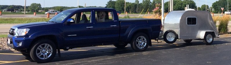

    All good points to consider which is why I started with this one. Didn't want to spend big dough on a teardrop that has lots of things I won't end up using. Scooped this bad boy up for a deal and I plan on using it a lot this fall and next spring. I'll reevaluate then and see if I need to upgrade anything or replace it with something bigger.
    I first had my eye on Aliners but just couldn't justify spending the money on them. New or used they command a lot of cash.
    At this point I was looking for three things - easier set up & takedown, better shelter than a tent for inclement weather and affordable. So far so good!

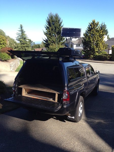

    Hey Leppz-
    How are you using the solar panels?

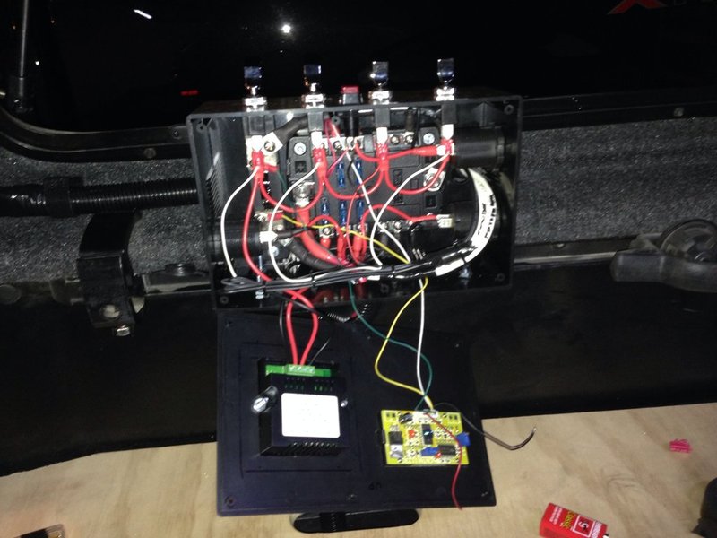

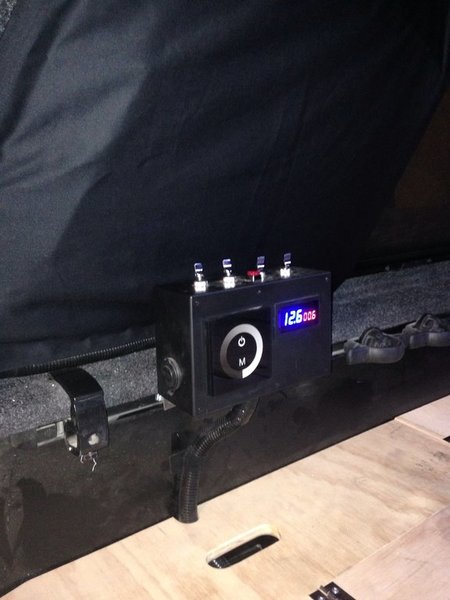

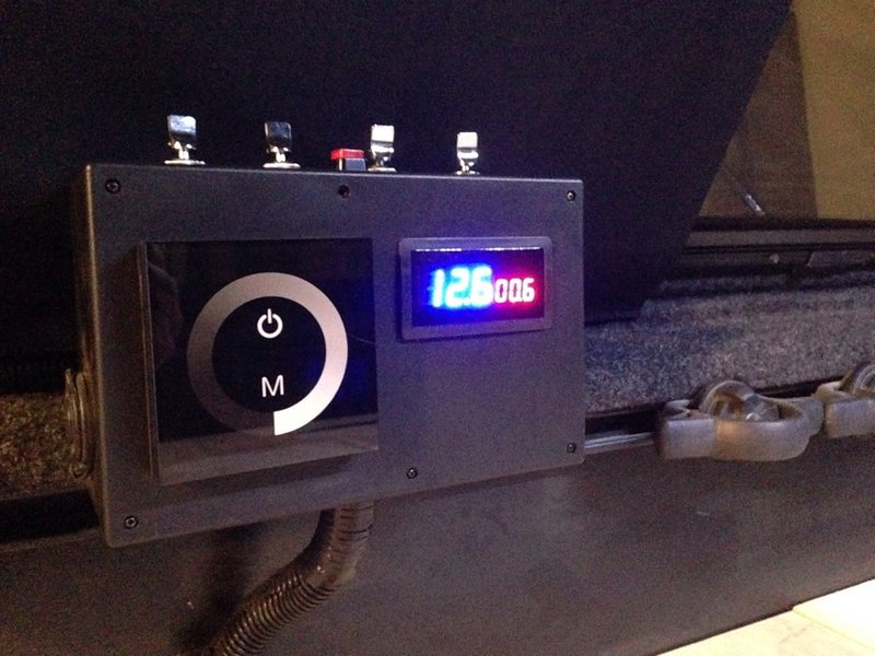

    I have the solar panel hooked up with a cheap solar regulator to my stand alone 105 AH AGM battery that I store underneath my sleeping platform. From my battery I've ran a fuse and set of lines to my 900W inverter. I've also added a circuit breaker and another set of lines to my custom fuse/control/power box. This box has 2 x 12v sockets, 2 x USB charging ports, 4 switches for LED lighting (one strip centered inside, one on the hatch, and one on each of my windoors.) I also have a LED dimmer switch that runs all 4 lights and a volt/amp meter with a push button to turn the meter on/off. With some careful layout and planning, everything just barely fit inside this ABS project box.
    Here's some photos.
    I do plan on upgrading the solar regulator I have with a DC-DC charger/solar regulator like the "Ctek d250s dual" that will charge off the trucks alternator and also off the solar panel once I buy myself a 12v fridge and have a larger load. As of right now with my current setup the solar panel has no issues keeping up with what I'm drawing from the battery and I was able to last two weeks on the road with this setup and never once had a dead battery.
