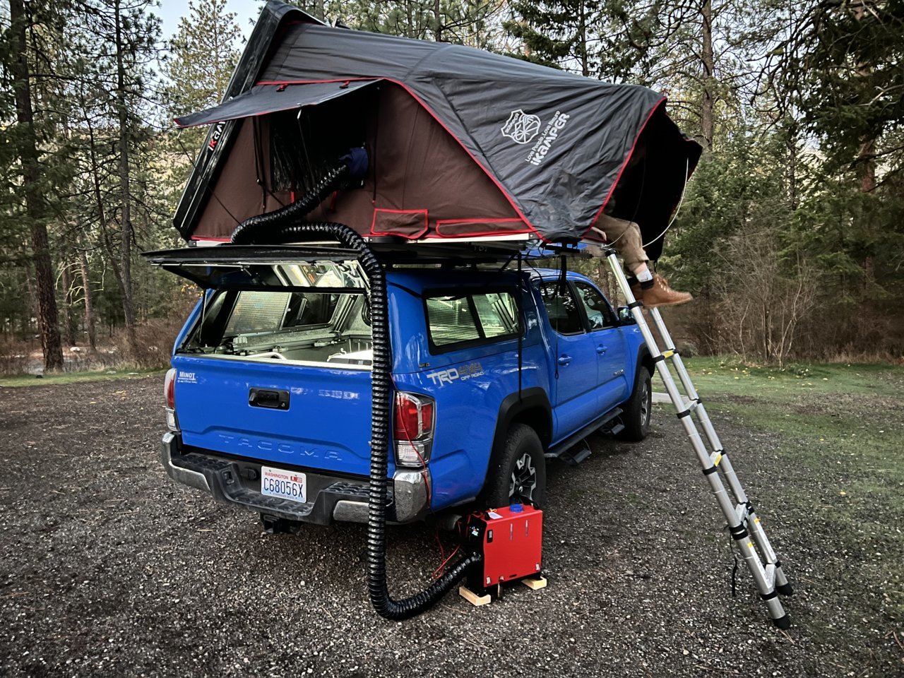

    The diesel heater is being powered by a Jackery 1000. It uses about 20-40% of the battery over 10-12 hours depending on the fuel rate I select on the heater. I ran the heater at about 2/3 fuel rate and had a Dometic CFX3 55IM also plugged into the Jackery 1000 and after about 10 hours the diesel heater had about 1/3 left in the fuel tank and the Jackery 1000 was around 65%.
    Overall I'm very happy with the heater. For the first couple of trips out it has done well. The first night it was below freezing, but the heater ran without issue at high fuel rate. The second night (also below freezing) I ran it starting around 8pm at about half fuel rate and I woke up with it turned off around 12am. It came with a wireless remote so I turned it on via remote and after it warmed up for 5 minutes I cranked the power up to about 3/4 fuel rate and it ran the rest of the night without issue and I turned it off around 8am. If I had to guess it threw some kind of error over night, possibly due to not running hot enough, but again I was running it sitting outside my truck and the temperature was 27deg f.
    Temperature in the tent was comfortable enough that I didn't need the 4 season sleeping bag, but wasn't so hot that we were sweating. Also, the airflow kept the tent dry inside.
    As far as the sound, it starts loud and then settles down to what I would consider reasonable. It passed the wife test, she just told me it was perfectly fine and didn't wake her up, and she's a light sleeper. The fuel pump is more of a concern, but that mostly makes more noise on startup and then quiets down as well, so overnight you're really only hearing the exhaust.
    Long story short - Wouldn't trust it for a survival situation, but it's easily worth the $150 from Amazon and I think if you run the thing at 2/3 or higher fuel rate then it will do fine keeping a tent nice and toasty while outside temps are below freezing. It's cheap, and time will tell if it throws any errors or requires maintenance that I can't do myself.
    p.s. It's a cheap Chinese knockoff of a Webasto. I can link from Amazon if you want to try this one out, also can link the longer ducting that's needed.
    @DAS Taco @gsubioguy

    Thank you very much, excellent write up and review. Much appreciated

    Love your tent!, can you please provide more info on it. The truck too, looks awesome

    Question. If its diesel powered, why are you using a Jackery? I'm guessing the diesel makes the heat, the battery powers the fan?

    Yup. Fan and fuel pump

    That’s pretty much it. Also, it needs some power for the ECU/LCD. You could tap into the 12v battery in your truck, but I worry about running the battery dead and getting stuck somewhere. This way if my battery pack dies then oh well the diesel heater wont work, but I can hop in the truck and get back to civilization.
