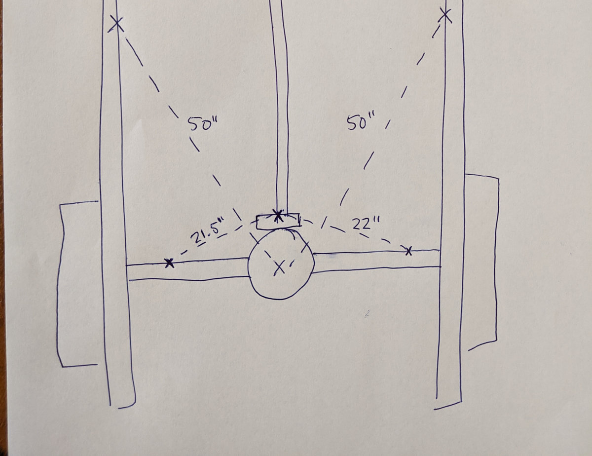

    Went by Monrovia Collision Center today up the street from me, wasn't very eventful but the tech did spend some time talking it over with me and giving me his thoughts. Long story short, he didn't think it warranted me leaving it there for them to work on...doesn't think it's a frame issue. He went over all the body panels on the truck and told me if the frame had been pulled or bent enough to tweak the rear axle like that, it would show elsewhere.
    Gave me a couple tips on where to measure from to see how much I should try and move it back into place, recommended I basically do what I already did but try it again with a bigger strap (remove u-bolts and ratchet strap the axle into place). If that fails, he recommended I just put a relocation plate on one side to even it out.
    He stressed that given how I built and use my truck, I'll drive myself crazy trying to rule out imperfection in every little detail and I have to agree.
    I measured across the axle wheel mounting surface to wheel mounting surface, determined where the center of it was on the bottom of the differential and marked it. Measured from that point about 4ft up the frame on both sides...50" exactly on both (used a factory hole in the frame on both sides to measure to)
    Used the center mark on the rear diff to determine where the center point on the pinion flange would be, marked that as well and measured from there to the axle on both sides. Got a variation side to side of about .5"
    Made a crude definitely not-to scale drawing of how I measured this AM, easier than taking pics of it.
    Once it cools down later in the week I'll take my u-bolts off again and see if I can ratchet strap both sides to work it into place, if not then I'll consider the relocation plate.

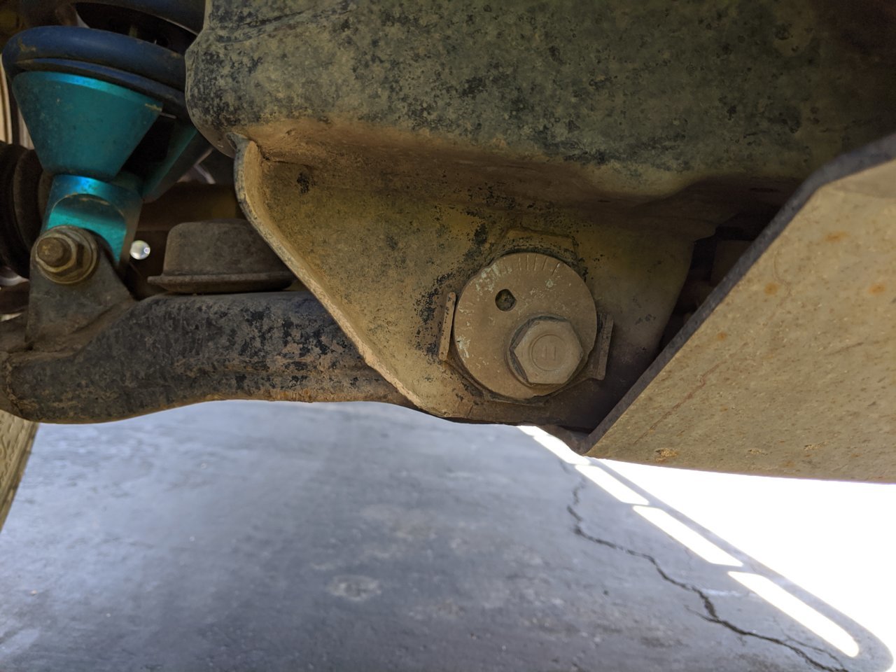

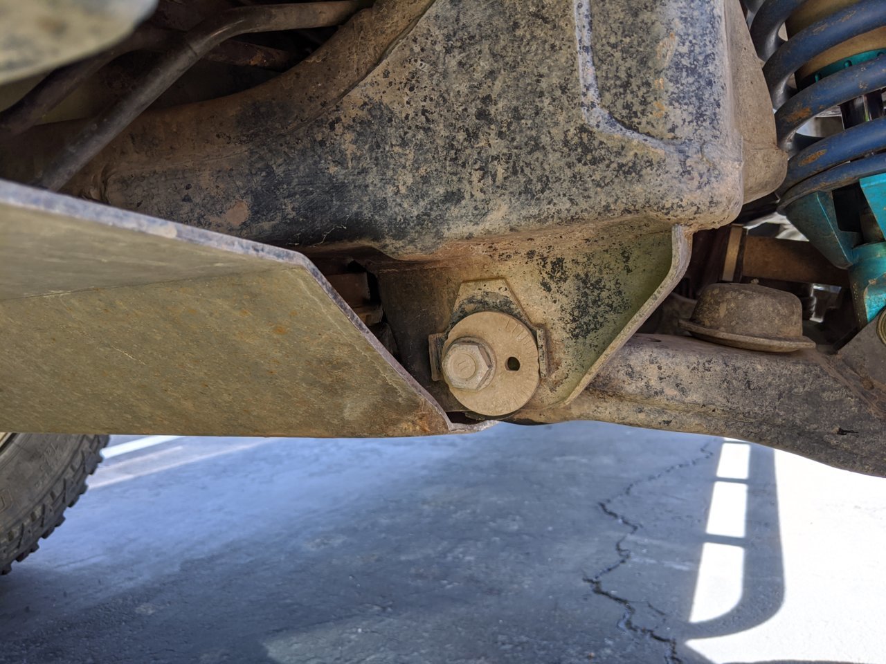

    I dunno how the variation in wheelbase side to side plays into it, but if you’re on the original lca bushings I’d be curious to see what condition they’re in.
    not sure how .5” difference at that measurement would impact things so severely.
    Are the lca cam bolts aligned similarly on either side?

    if my thinking is true, the measurements will always be the same (your 50" mark) since the diff is in the center. it's actually your "center" point.
    try measuring where you did on the frame to the axle housing itself (inside the WMS, straight line down the frame to axle housing) and then again on the opposite side (like an X) and see what the difference is?

    LCA bushings are on my priority to do list, here's my cam bolts. They're not identical side to side but not that far off.
    stock LCA bushings with 90k on them

    This is true, the axle my be in the center of the vehicle however one side may be pushed forward or backward. Like stated, use the same locations as your 50" measurements and go all the way across to the back of the axle flange on the opposite side.

    Third, per the bold it seems you found the issue. It is a half inch off side to side on the axle when it shouldn't be. Doesnt that mean the axle is bent OR not "alligned" at a perpendicular angle to the frame? Given the drawing is not to scale, a .5" difference at the measured location would be compounded and get worse further out towards the wheel I think. So if it is an "allignment" issue hopefully you could ratchet strap it back, but given your experience it doesnt seem there is that much play to do so. If not, and bent, replace the rear axle right?

    Jury is still out on the axle housing either being askew or bent, to the eye it's not bent but the eye can only be so accurate of a judge. The method in the article that frizz man posted spelled out a good method of checking to see if it's bent or askew which I plan on giving a shot here pretty soon. If it is bent then a relocation plate won't really help - it'll just shift the problem to the other side, so it would be good for me to at least determine if it's a bent or askew housing
