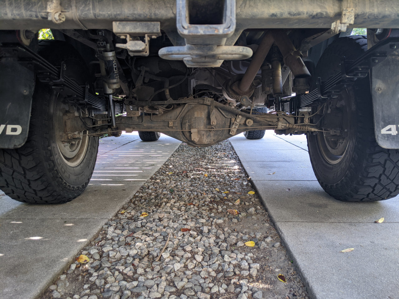

  3. May 7, 2020 at 3:30 PM
    #143
    svdude
    svdude Well-Known Member
    Sep 30, 2012
    #88055
    826
    jonathan
    OP says his axle thrust is off, nothing on the front end will make that happen. The front is totally independent of the rear. Looking at tie rods, lca bushings, etc is like investigating the transmission for a blown head gasket in the engine.
    look only at the rear end for thrust alignment issues. Frame bent, springs (already verified they’re the same length), spring hangar position (already verified), bent axle, possibly a bent axle flange but I don’t know for sure about that one, or anything else in the rear end. Nothing up front will affect rear axle thrust angle.

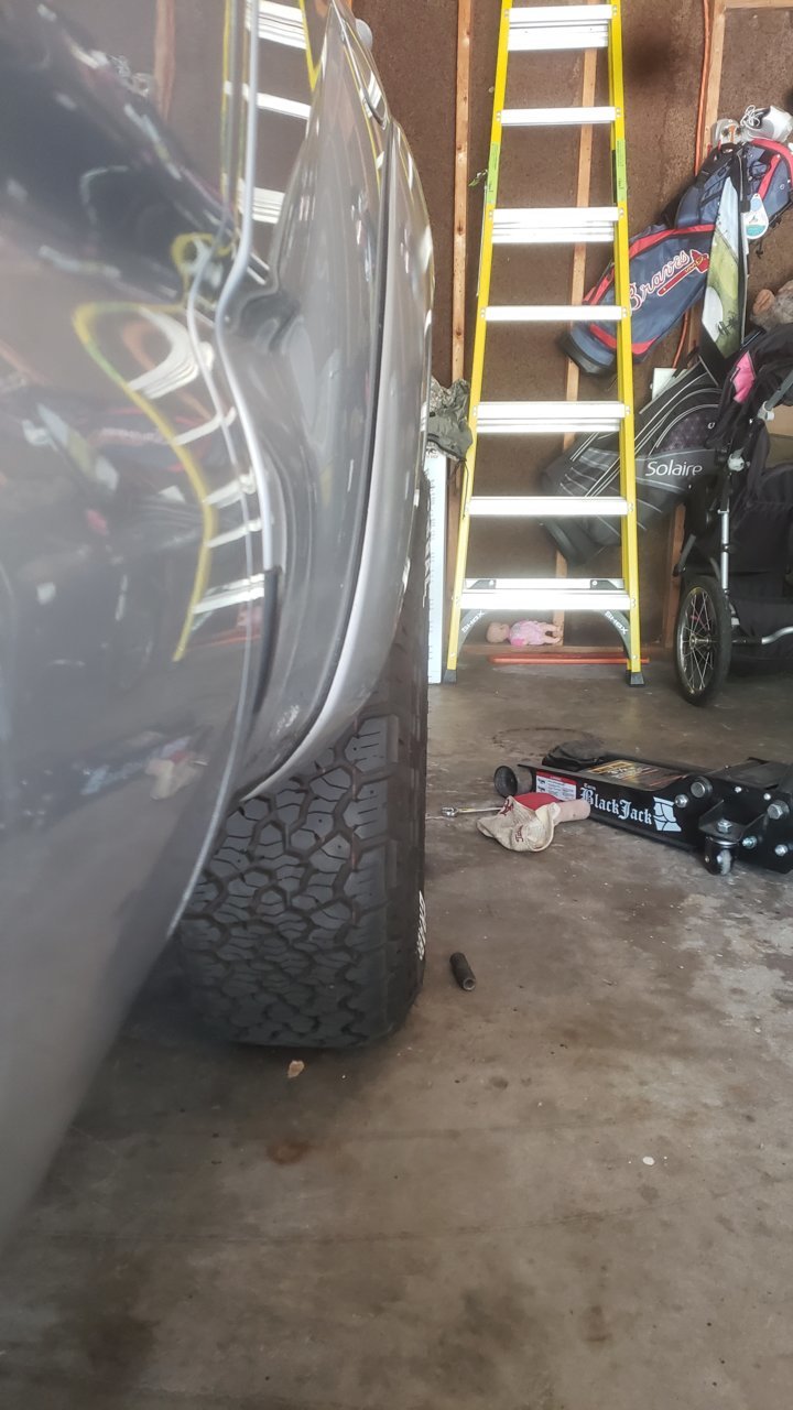

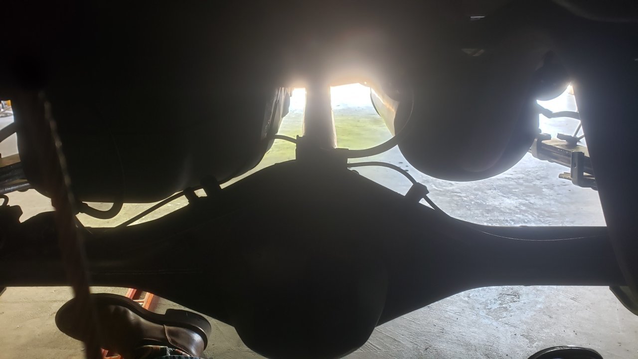

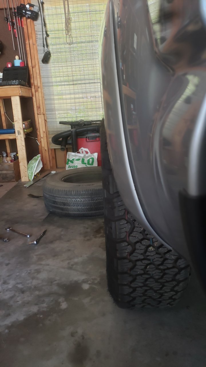

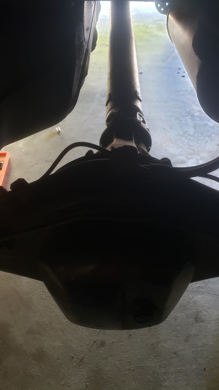

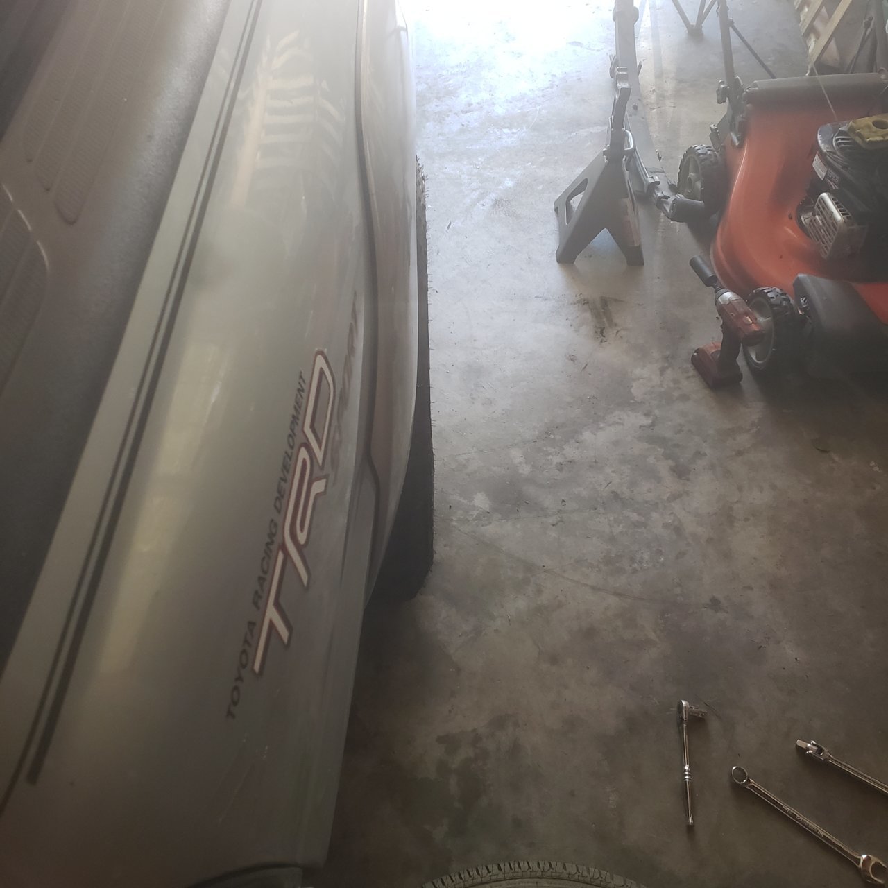

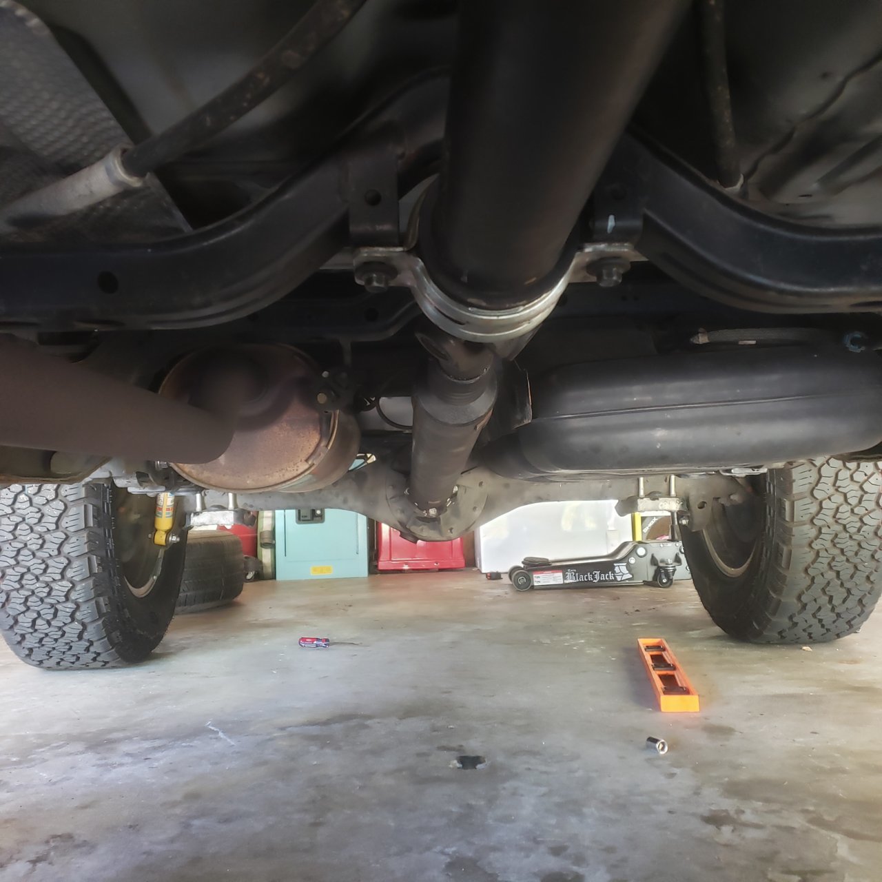

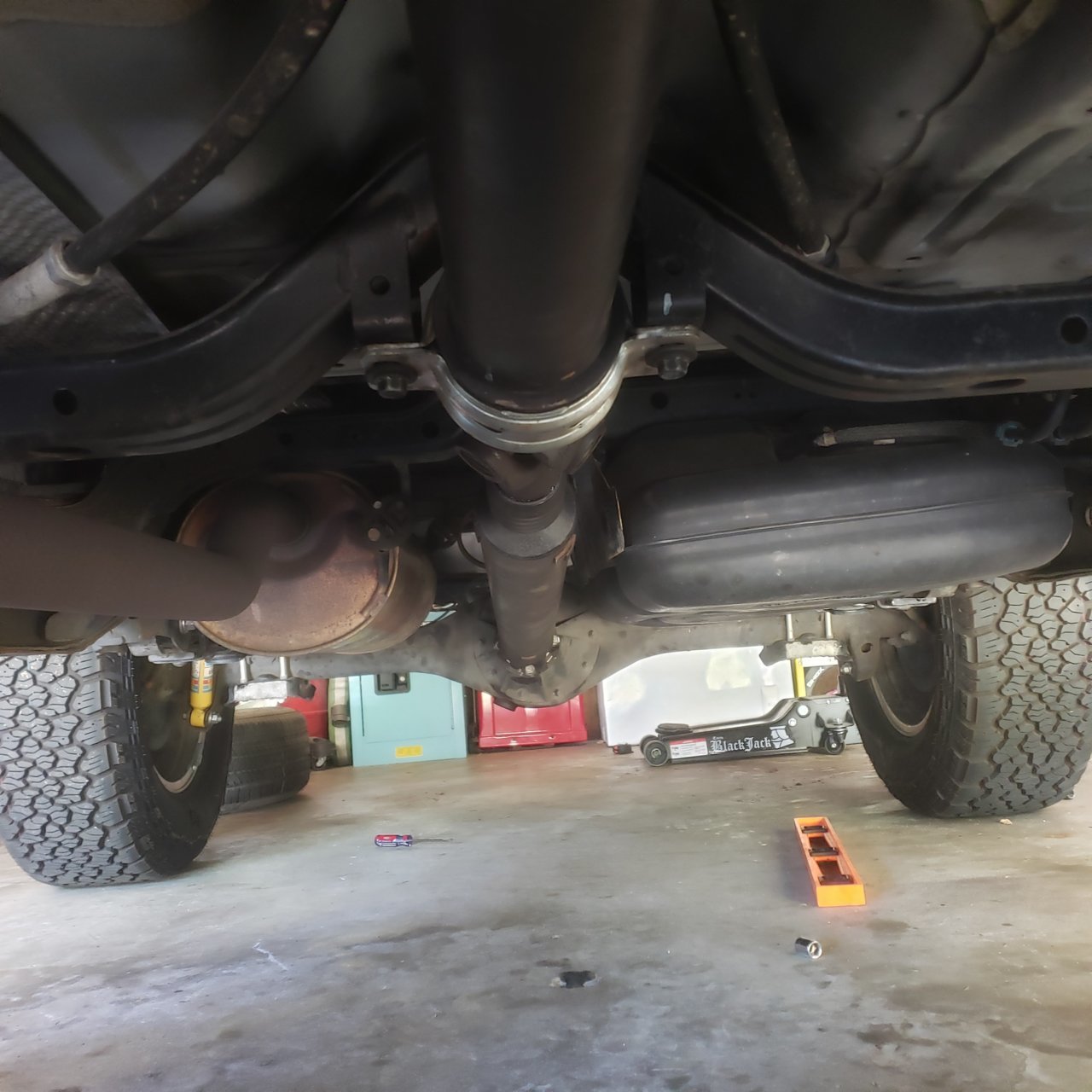

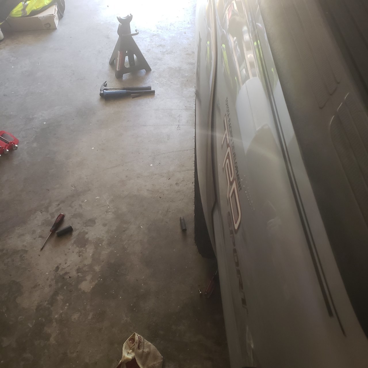

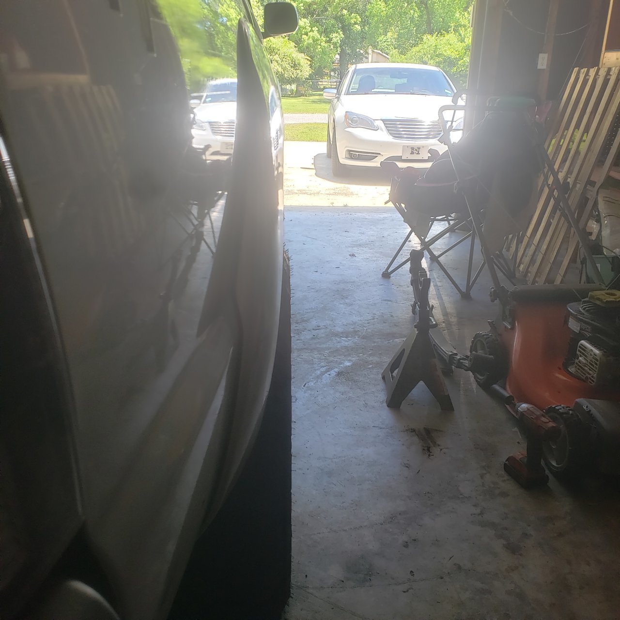

    Well changing the leaf did not help whatsoever. I think it made it worse. I put the yellow lettered spring on the driver's side. I had the white lettering one there and nothing change I honestly think it got worse. I haven't drove it yet but I'm kind of over fighting it at this point figure it's the worse. A bent axle or a torqued frame. The thrust angle is horribly visible in person these pics aren't too grea . My camera glass broke a while back sorry. The only measuring distance I've found so far that isn't the same is from the aft u bolt to the rear shackles. They are off like a 1/4 of an inch from the back of the axle mounting to the front bottom forward most portion.
    The bed is square because I did that too. Just didn't help at all. Again sorry for the crappy pics.
