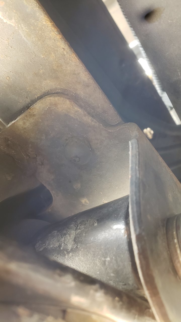

    So I'm probably just taking this thread over, but I MAY have found my issue. My front hangers are off either side by about 1/16th of an inch but my measurements are with a tape measure so. Again sorry for the crappy pic but here is the front driver. You can see where it has actually moved. Hopefully I can fight Toyota of Gastonia about it but I'm not expecting much. It's a stearlership.

    Why? If your breaking out the welder you might as well just weld up a trailing arm set-up. I know you've got the skills. lol

    A lot of trucks axles are not perfectly centered you just won’t notice it till you lift em or run wider tires

    As I've found most people's are offset by a little. Some more extreme than others. I'm much of a perfectionist with my truck I guess. Plus it's just disgusting to me how far off it is.

    I’d say 80% just based off alignment numbers I see. But it’s rare to have one bad enough to cause a pull.

    You're thinking way too hard about this. 1/16 to square on an 07 is pretty damn close. If you're this much of a perfectionist, then leaf springs aren't for you. There's a bunch of side to side slop in shackles and bushings all of the time.
