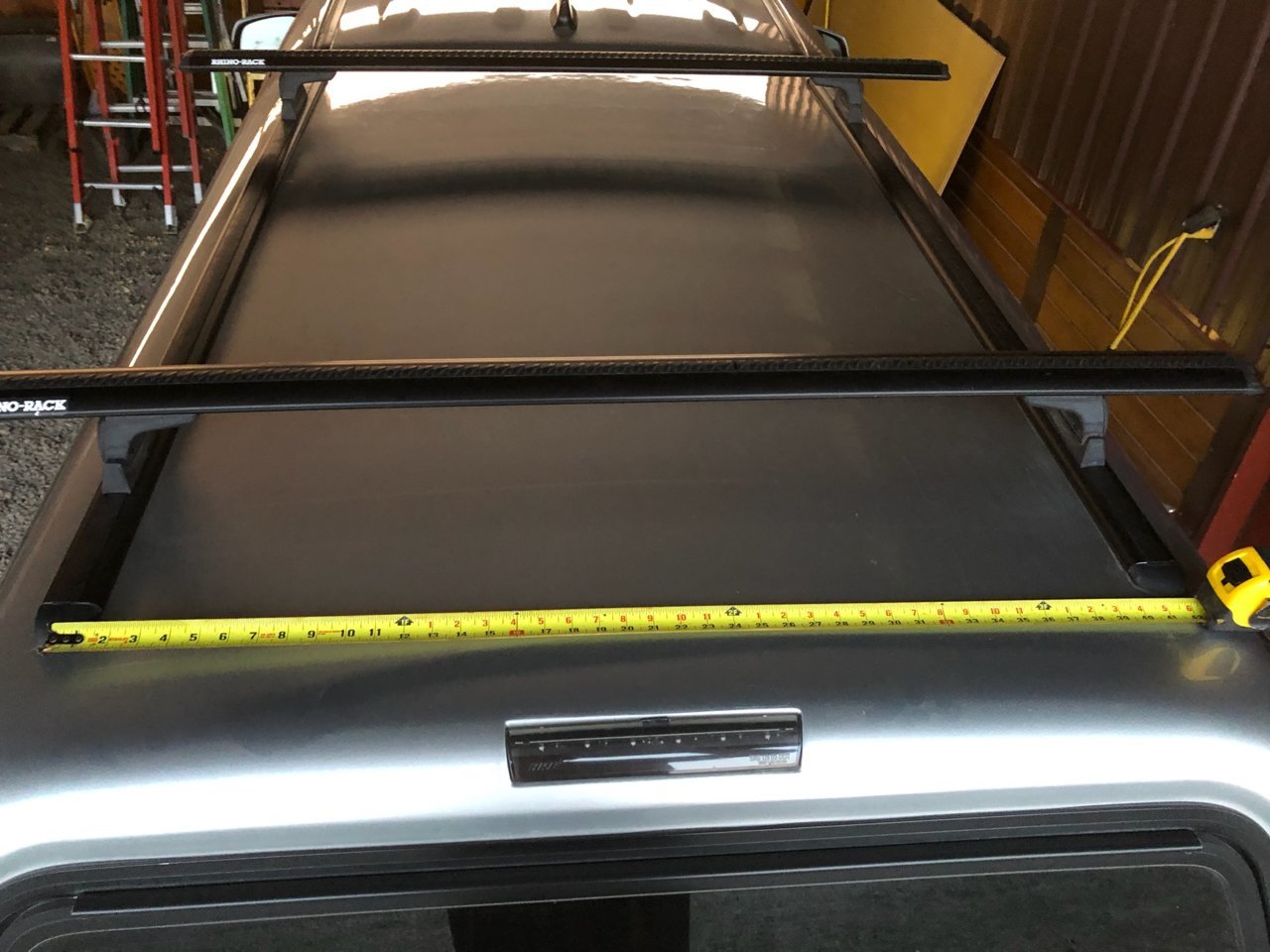

    not sure if this helps but here is a photo of mine that were factory installed on an ARE cap. they are about 41 1/2 inches apart and 58 1/2 inches long. i have the 6 foot bed.
